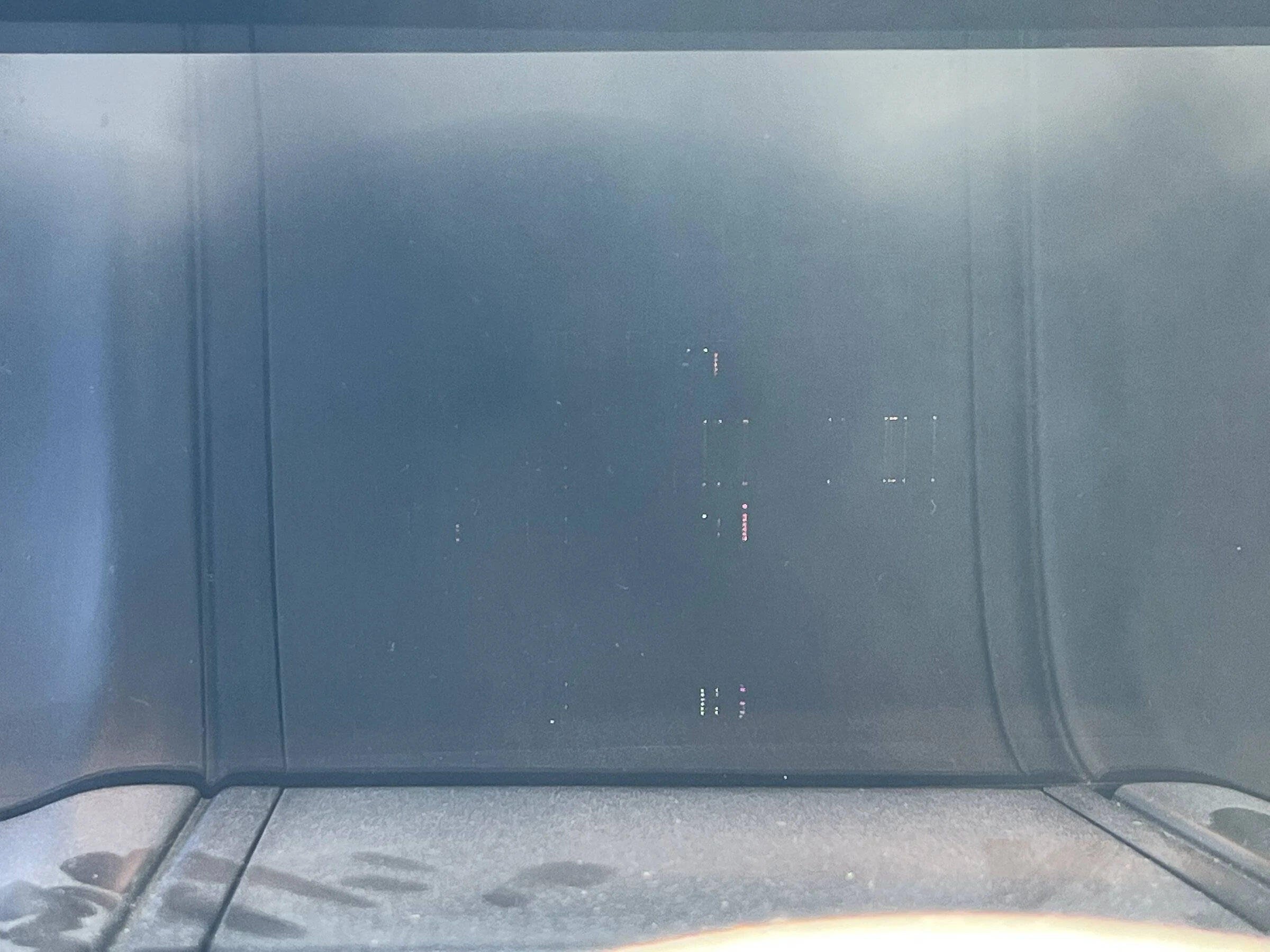

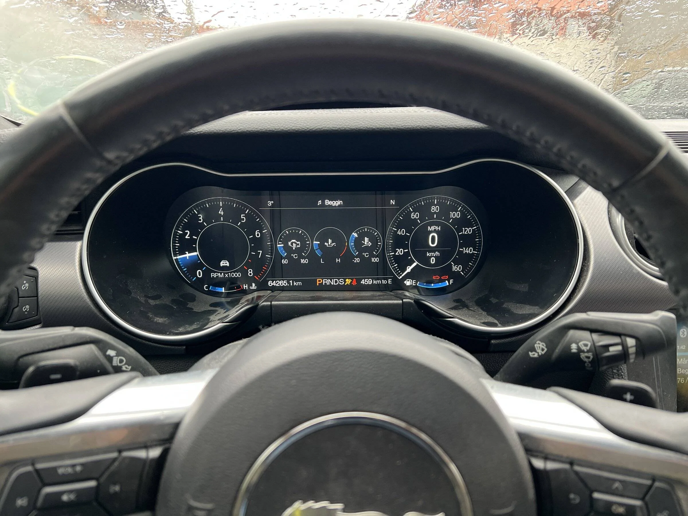

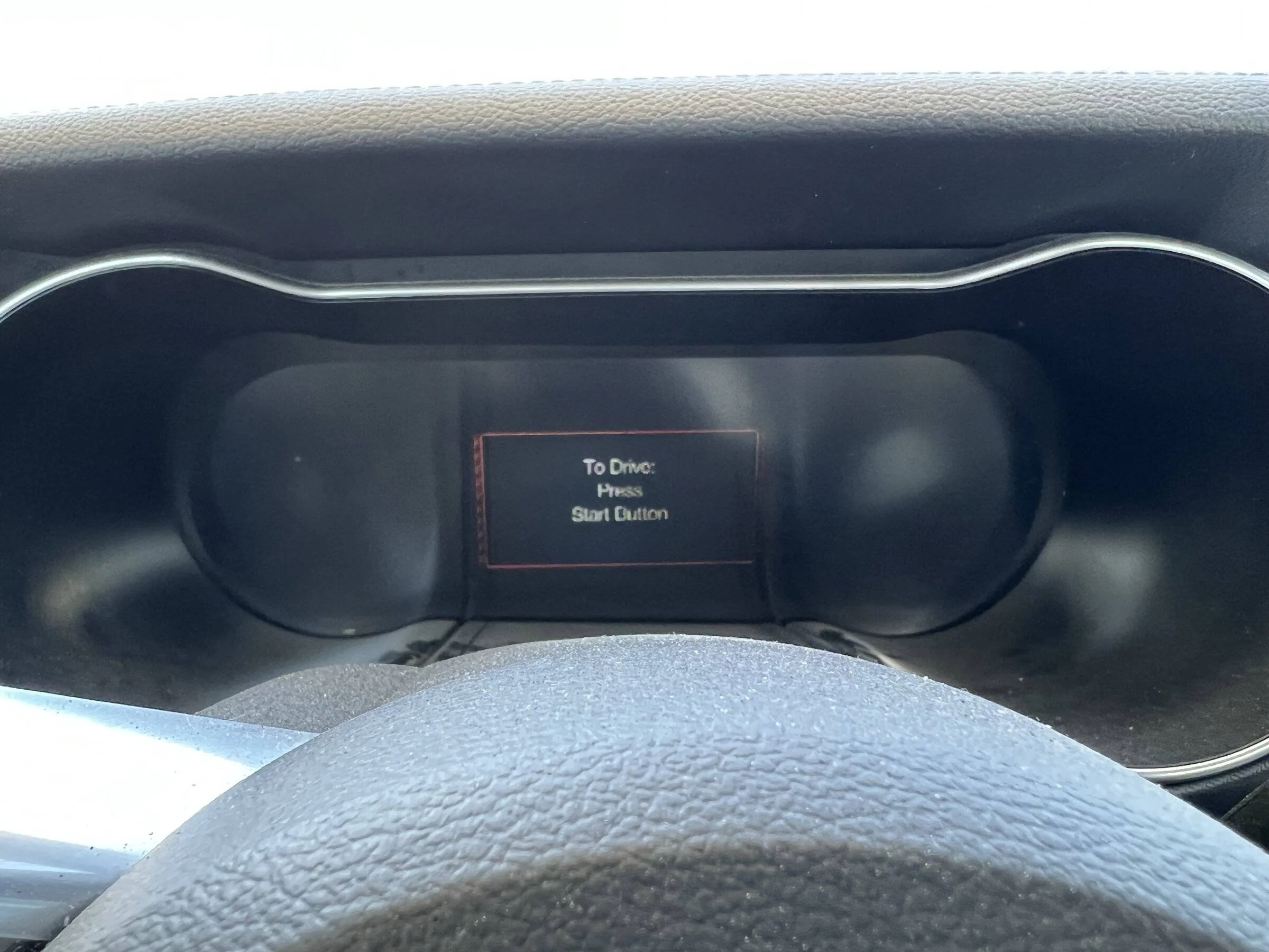

Hey guys, I am experiencing issues with the digital cluster on my 2018 Mustang GT. Car was left stationarry for a month or so, and now whenever I start it, the cluster doesn’t want to turn on, stays completely black, and after a while it will start showing some signs of life, as shown on the pictures. However, it’s totally unresponsive. I even bought a new battery hoping that it would fix the problem, but it didn’t. I tried resetting the module with Forscan, but it didn’t help either. There are no errors in the ICP whatsoever. Interesting fact, I can hear the sounds from the turn signals, chimes etc. coming out of it. Do you think it’s dead?

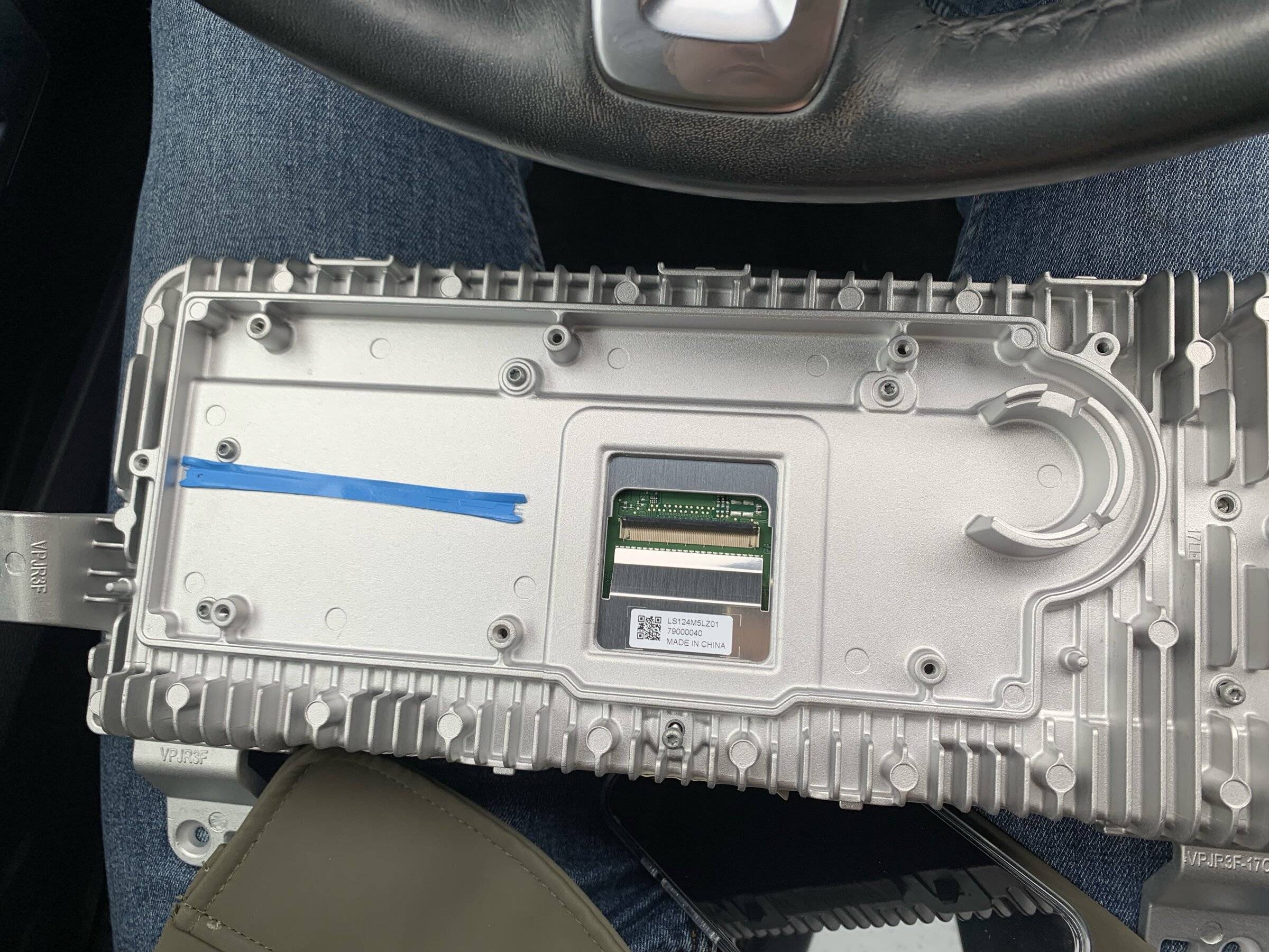

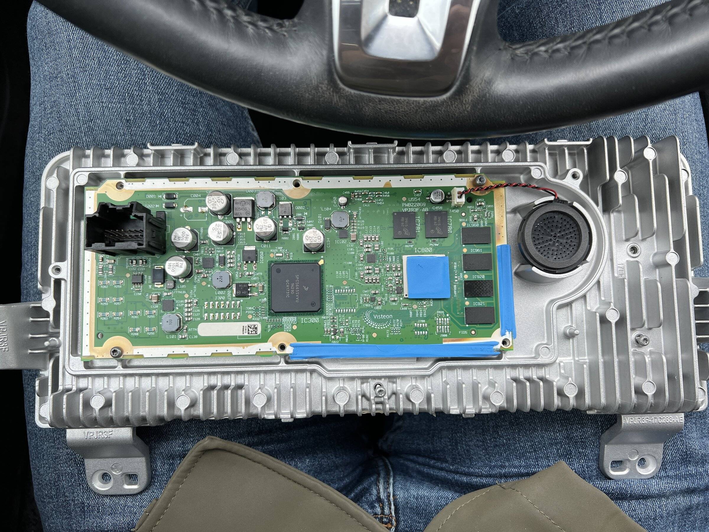

Today I pulled the cluster out only to find that there are no issues with the motherboard buut after total disassembly, I found out that the connection between the screen and the mobo was loose. I unplugged it from both ends and reattached it and voila, the screen is now working as it was before. However, I noticed that it is very easy to loosen that connector. I hope that I won't need to do this procedure again.

Maybe there is some "electronic component adhesive" that would be safe to use on that connection to keep it from vibrating loose.

work on navy equipment, and vibration is a constant concern. We use a 'blob' of silicone at the junction of the 2 connector halves (after connector is mated).
