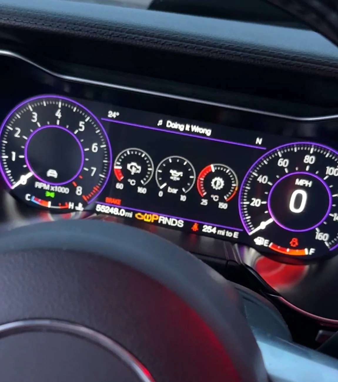

So i just bought a Digital Cluster for my 2015 mustang gt premium. Everything works fine except for the “engine oil pressure” gauge is not working, the reading is not showing on my dash. Any idea how to fix this?

Do non-PP cars even have oil pressure sensors? I thought it was just a low/normal/high switch.

Yeah, says so right at the top of the display! 😜
I do recall skimming some posts about some digital cluster cars not displaying oil pressure, hopefully its possible and easy.

There is a post on this forum under (Oil Pressure Sensor Conversion)
I have recently had the Digital Dash installed into my 2016 GT and the same issue, mind you I was not told by the installer that the OP gauge won't work.
I had the conversion done by an Auto Electrician here in Canberra Australia using the information from the post and the OP gauge works. As it was the first time he had carried out the works it wasn't cheap.
