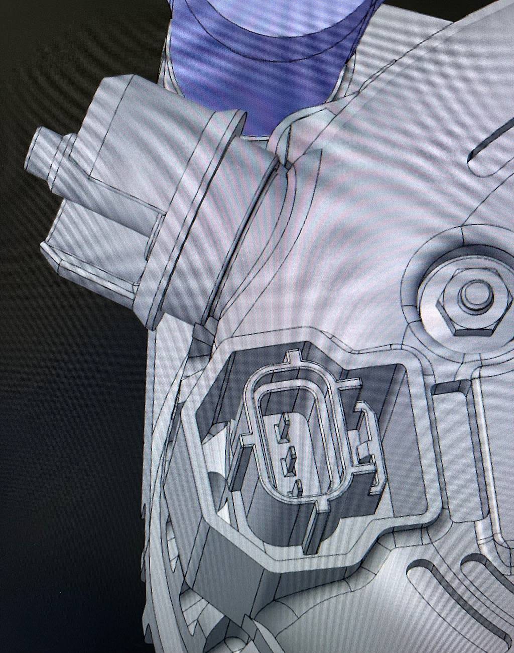

Think I found the answer on releasing the plug. A couple of years ago I downloaded a model of the engine package for giggles. It has a model of the alternator that is fairly detailed, and shows it bolted to the block. It’s an earlier gen Coyote but I suspect similar.
Yes, give it the old reach around, squeeze; pull 😄

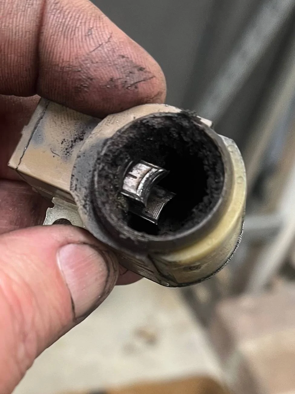

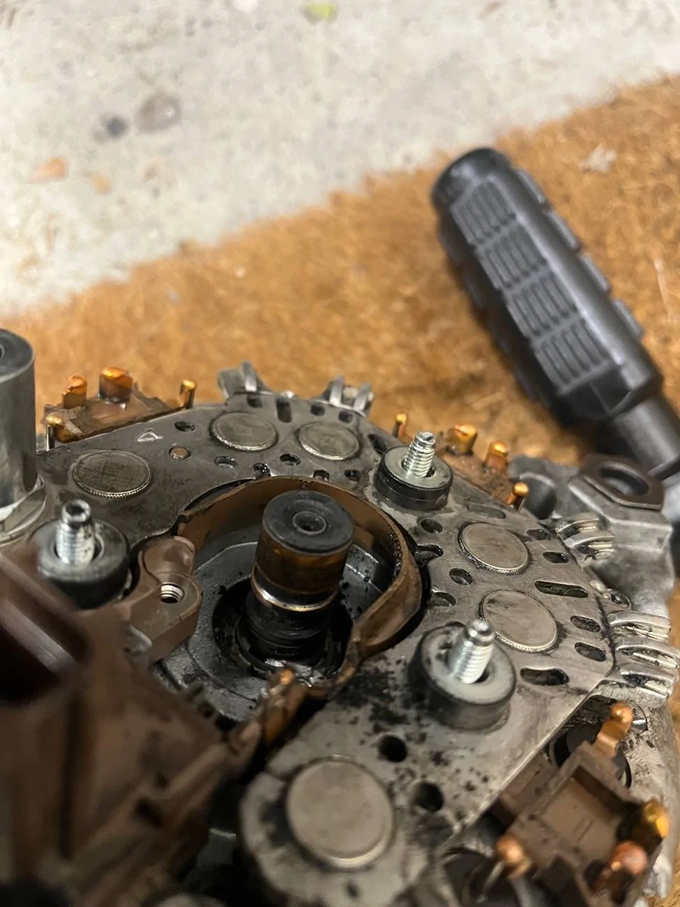

I took the alternator off and looked at the contacts. Nasty. I cleaned it up and reinstalled. Man, I though I had it fixed. When I first started it I was getting a 14.5V reading at the battery. I then went and switched on the a/c. Down to 11.6. Funny thing, is it stayed steady at 11.6 for the 5-10 minutes I had it running and checking things. I could rev it up and get a slight voltage increase but only fractions of a volt. After turning the car off I checked the battery voltage. 12.1. I’m laying here wondering if there is any value to resetting the BMS. I looked at the wiring and nothing is obviously broken. Does anyone know what points I can check with the volt meter to verify the 3 wires are getting continuity? I checked the main power wire and it is making contact.

Just based on the pictures, you should replace that alternator. Those brushes are severely worn, and all that carbon powder isn't helping.....

Yes and it seemed like carbon mixed with oil. A sort of pasty grainy crap. Only 50k original miles on the car. Bearings are as smooth as butter. May be the oil contamination that did it in.
