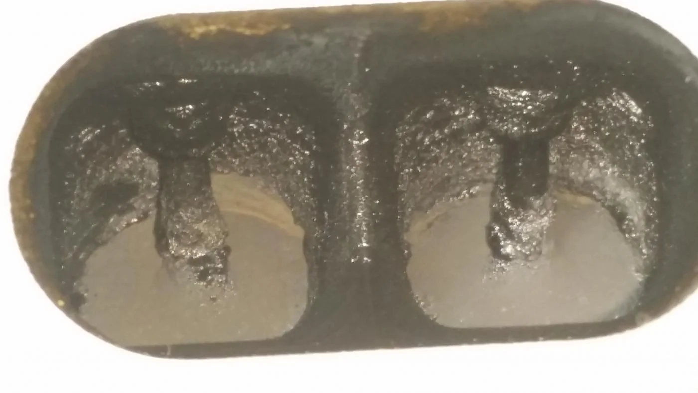

Or just pull the intake manifold and soak and scrub the valves a set at a time. Did that in my 3.5 ecoboost with no ill effects at 110k miles. The 2.3 should be wayyyy easier

I expect my cars to go past 150,000 miles without any significant repairs and to 250,000+ before I think about replacing them. 80k isn't even mid life, if the picture you attached are of your valves you won't make 150k without tearing into it to clean those ports.

Just a few posts up I stated that I cleaned them via solvent and scrubbing one set at a time.
