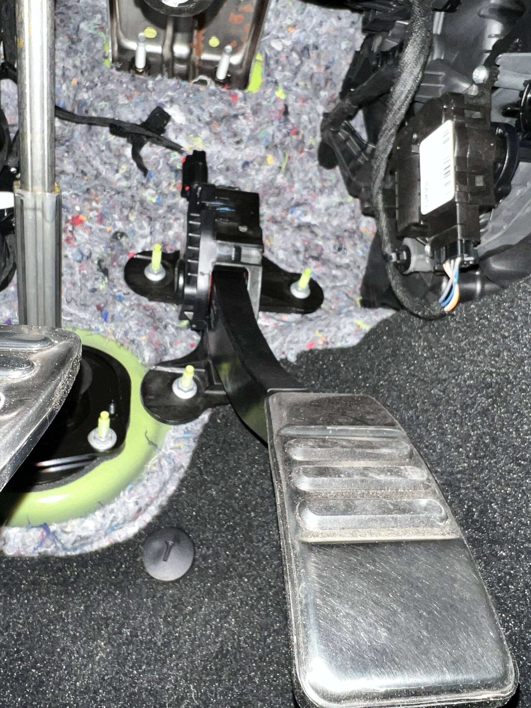

Finally got mine installed this afternoon. I chose like another to remove the 3 nuts (.25” drive with 10 mm socket, universal joint and ratchet with my Milwaukee Driver and pedal was out in 2 min. Not necessary but made it easier. If you are over 180lbs or broad shouldered it can be tight getting an arm up there and releasing the clip.
It is tight under there even with the seat all the way back. Managed to get everything installed and no codes.
I must say I absolutely love the way the throttle responds now. I have a manual transmission which means a lot of on and off throttle. I set the Mustangs Normal with Comfort 8 on the device. I set The Mustangs Sport+ mode to Sport 6 on the device. Finally I set the Mustangs Track Mode to Ludicrous 3. When I switch vehicle modes I can set the Device to a specific setting to correspond.
I did not experiment with the other setting as of yet. Highly recommend, especially with the discount.
For reference here is the pedal and connection from the factory before installing the device.
