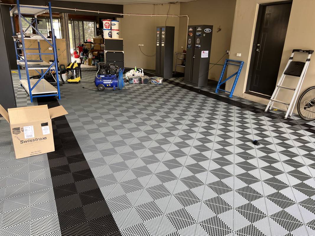

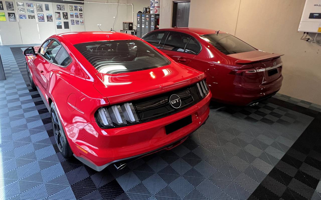

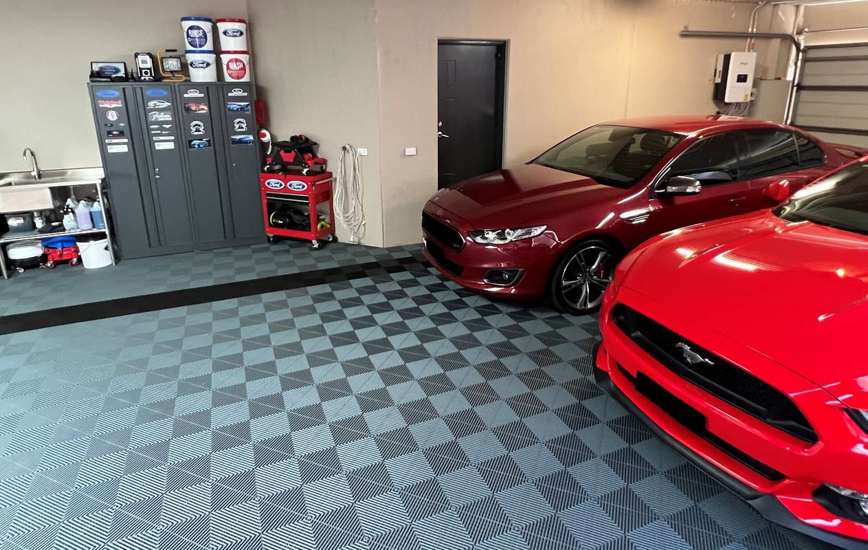

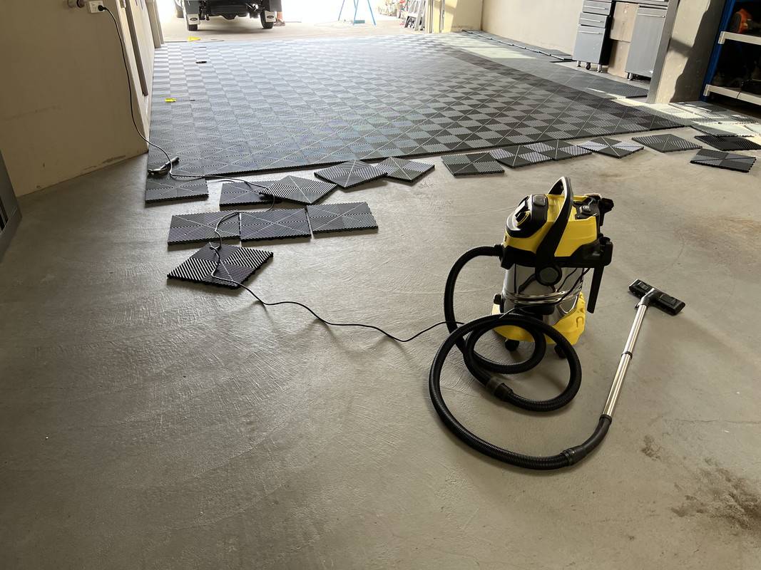

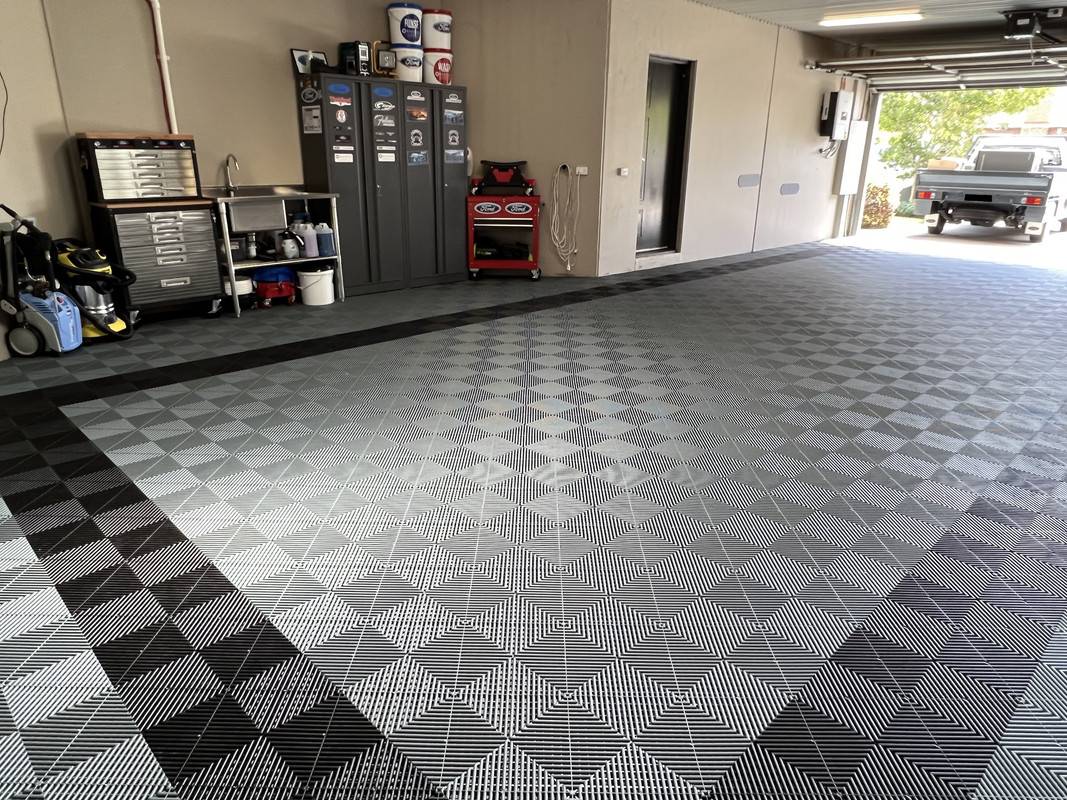

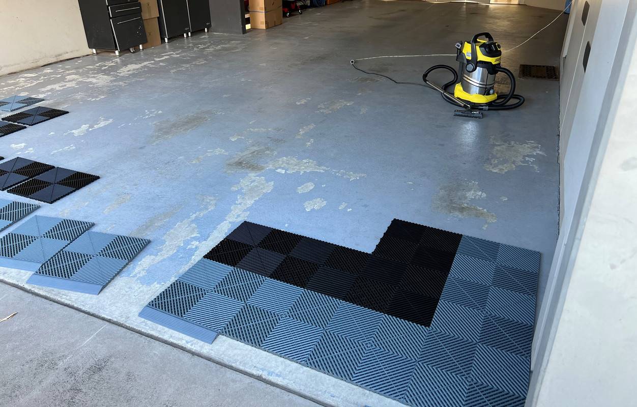

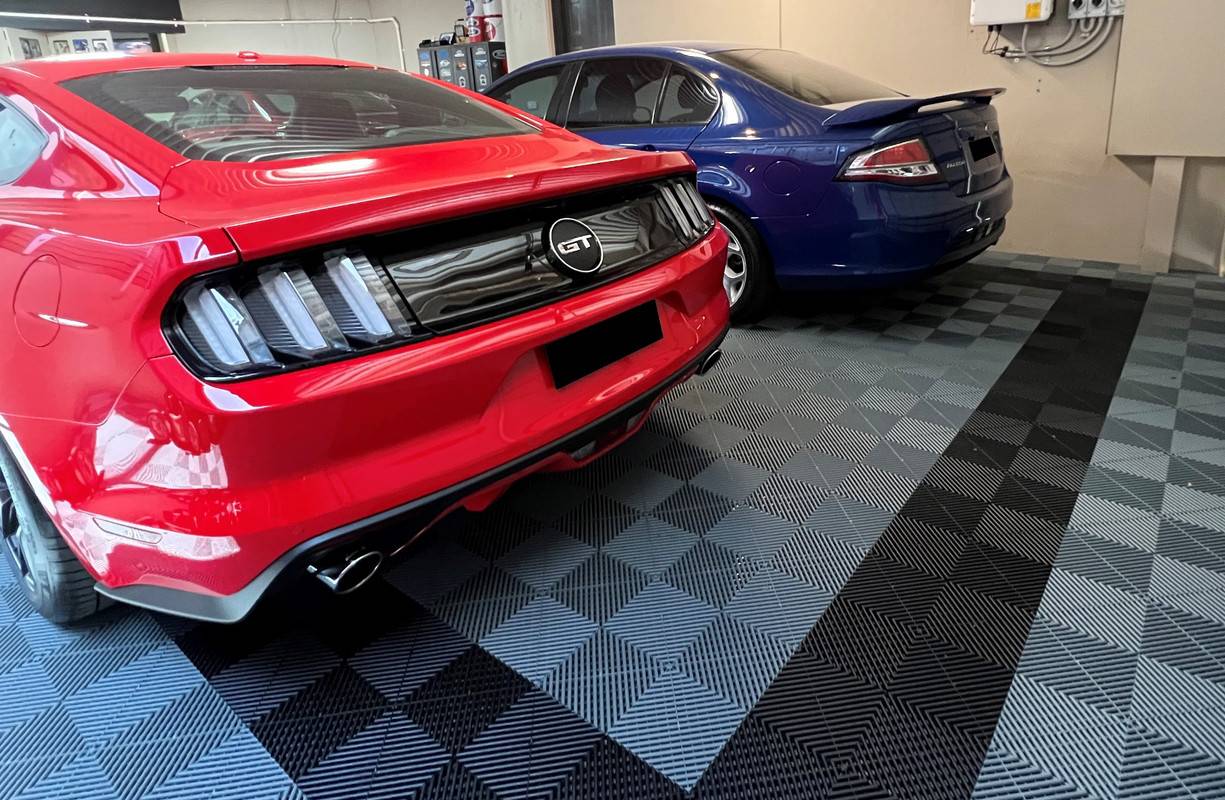

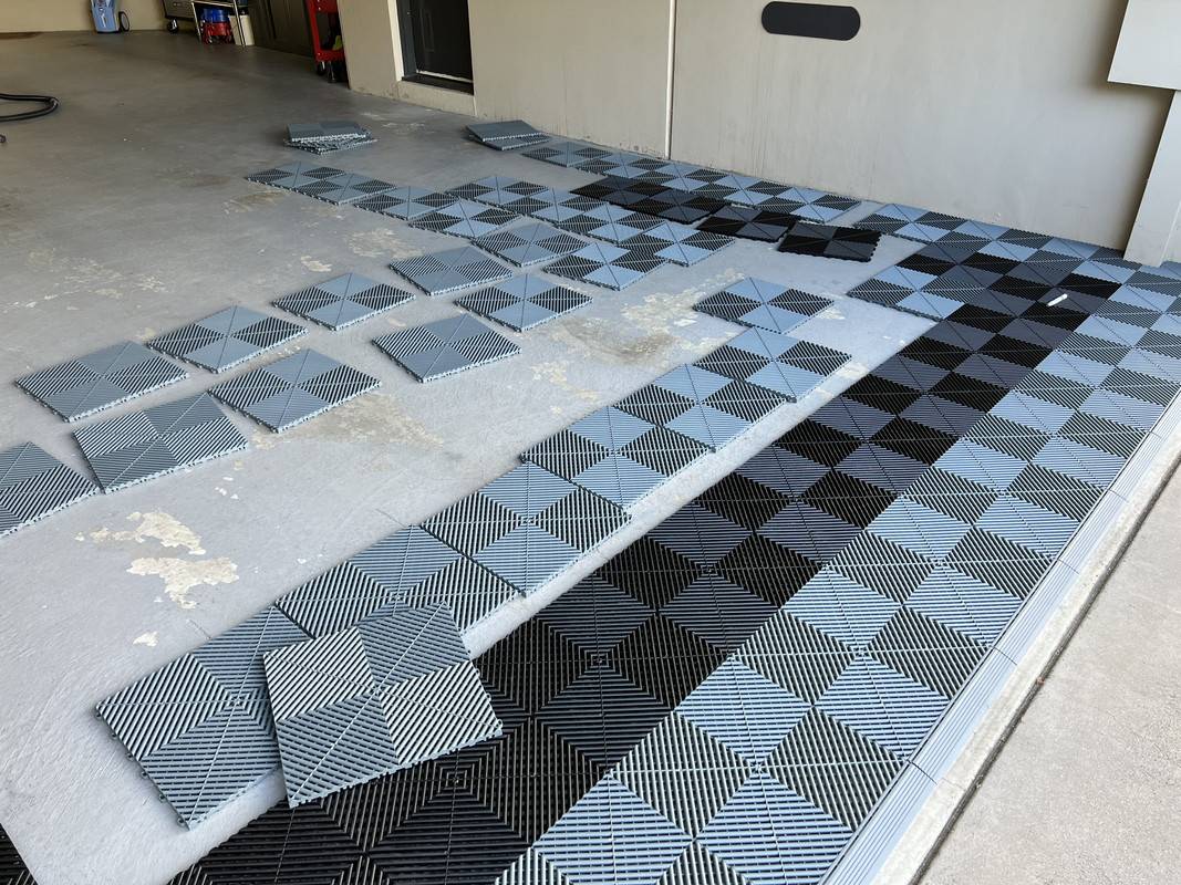

I spent two years procrastinating on what to do with my garage floor before deciding to do Swisstrax.
The floor was painted concrete, a solution that never works and not my choice. I would sweep/blow/vacuum it weekly but was always dirty pretty soon afterwards. I looked into a variety of options but favored the interlocking tiles as they suited what I do in my garage. I also liked how I could do it myself and control the whole process. (I store 4 cars in this garage, a bit of a logistical issue at times.)
Now the controversial bit. I looked at both solid and grooved tiles. I did not like the idea of the dirt being under the floor, but I preferred the look of the grooved tiles better, and that is important for someone who is very much a visual person. The dirt aspect really concerned me, especially considering when I'm detailing, dirt and dust are always a worry. In the end, the look of the floor won the argument and I ordered a very expensive amount of Swisstrax Ribtrax tiles to cover my entire garage.
This was a Christmas holiday project that was completed in about 8 hours by my Dad and myself. I went ahead exactly how I planned. I laid, cut and fitted the tiles and my Dad kept the tiles flowing to me. I obviously moved the cars all out, however I only moved the rest as we went along, sliding things like cabinets onto the freshly laid tiles, finished the fit then moved everything back. This meant I didn't have to completely gut the garage.
The result was transformational!
I could not be happier with how it looks, or how it has transformed the space. I use the garage for detailing, for that job it's brilliant. I probably would not have chosen Ribtrax if I was doing wood or metal work, or even heavy mechanical work.
But what about the dirt? As I said, I was hesitant about the fact dirt, dust and debris falls through the tile and sits underneath. The floor has been down for just over two months now and in terms of how I treat the Swisstrax, it's no different to how I was dealing with the bare concrete beforehand. I blow and vacuum it once a week, the same as the concrete.
The thing is, the actual floor surface I stand or work on is always clean. There may be some underneath but it's not being blown around or tracked in and out of the house or cars. On smooth surfaces, concrete/epoxy/smooth tiles, dust and debris that blows into the garage moves as far as the wind will take it. On Ribtrax, that debris generally stops within the first few rows of tiles and falls to the bottom, where it stays until vacuumed.
What I would say from here is, don't rule out a grooved tile based on how you think the dirt will be an issue. I would also consider how you intend on using your garage and make a decision that will suit that requirement. As it stands, I walk out into my garage every day and think "oh yeah, I did that!". :)
