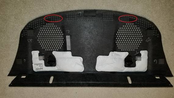

Something that helps reduce the rear deck from flapping is perforating the rear deck. https://www.mustang6g.com/forums/th...t-the-subwoofer-output-in.127850/post-3512796
Myself and a few other members have done this. I also went as far as to remove the rear speakers. But I still had some rear movement. So from inside the trunk I fitted large foam blocks up in through the rear speaker openings. I stuffed the blocks between the metal and the deck panel towards the rear of the car until the deck panel was up against the rear window. Zero buzz and the rear panel movement is gone now.
Put foam blocks between the sheet metal and the panel where shown:

I have speakers in mine so this process won’t work for me. Whenever I get around to pulling my interior again I’ll try to layer some more sound deadener at that location and see if that helps.

Thanks! I’ll look into doing this.
