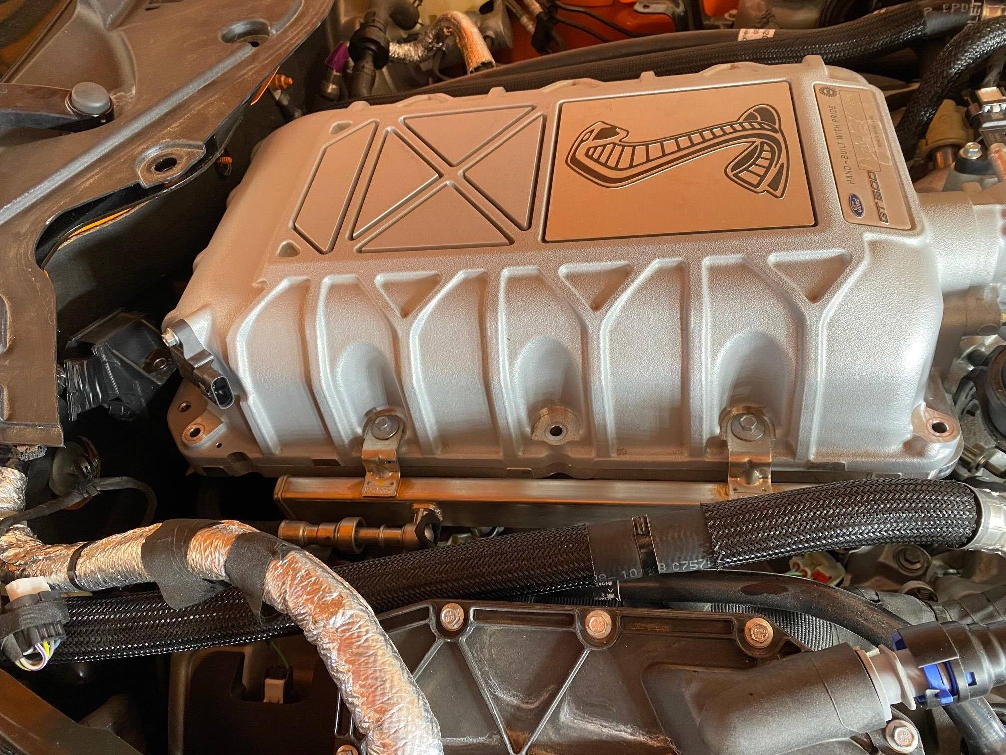

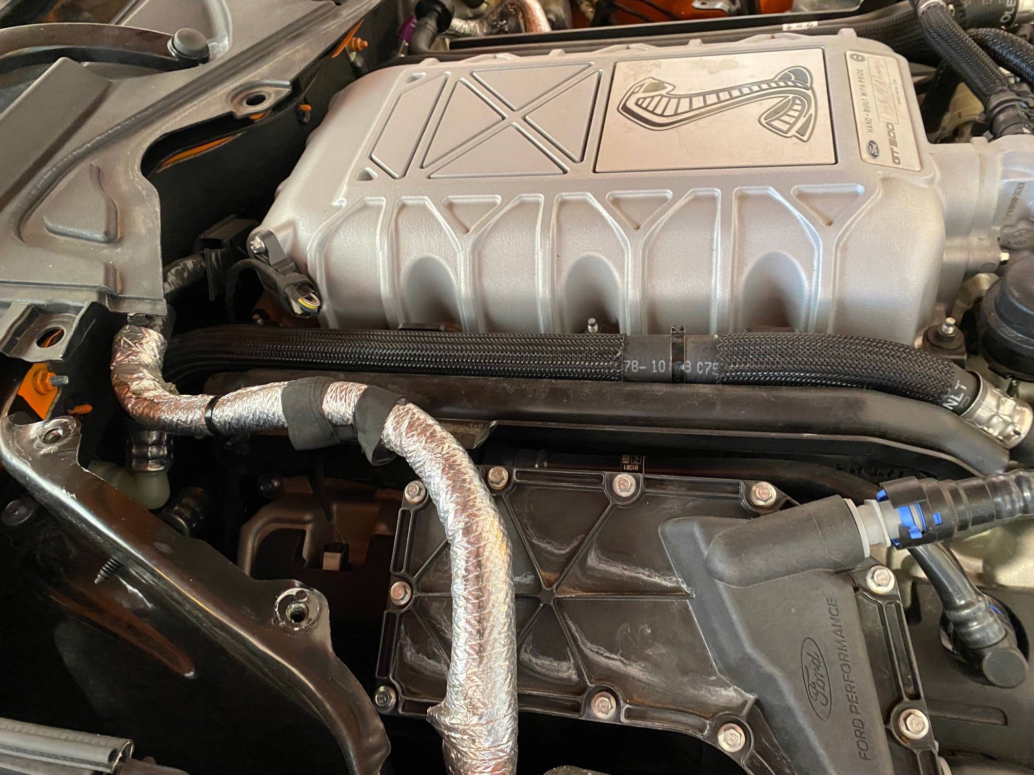

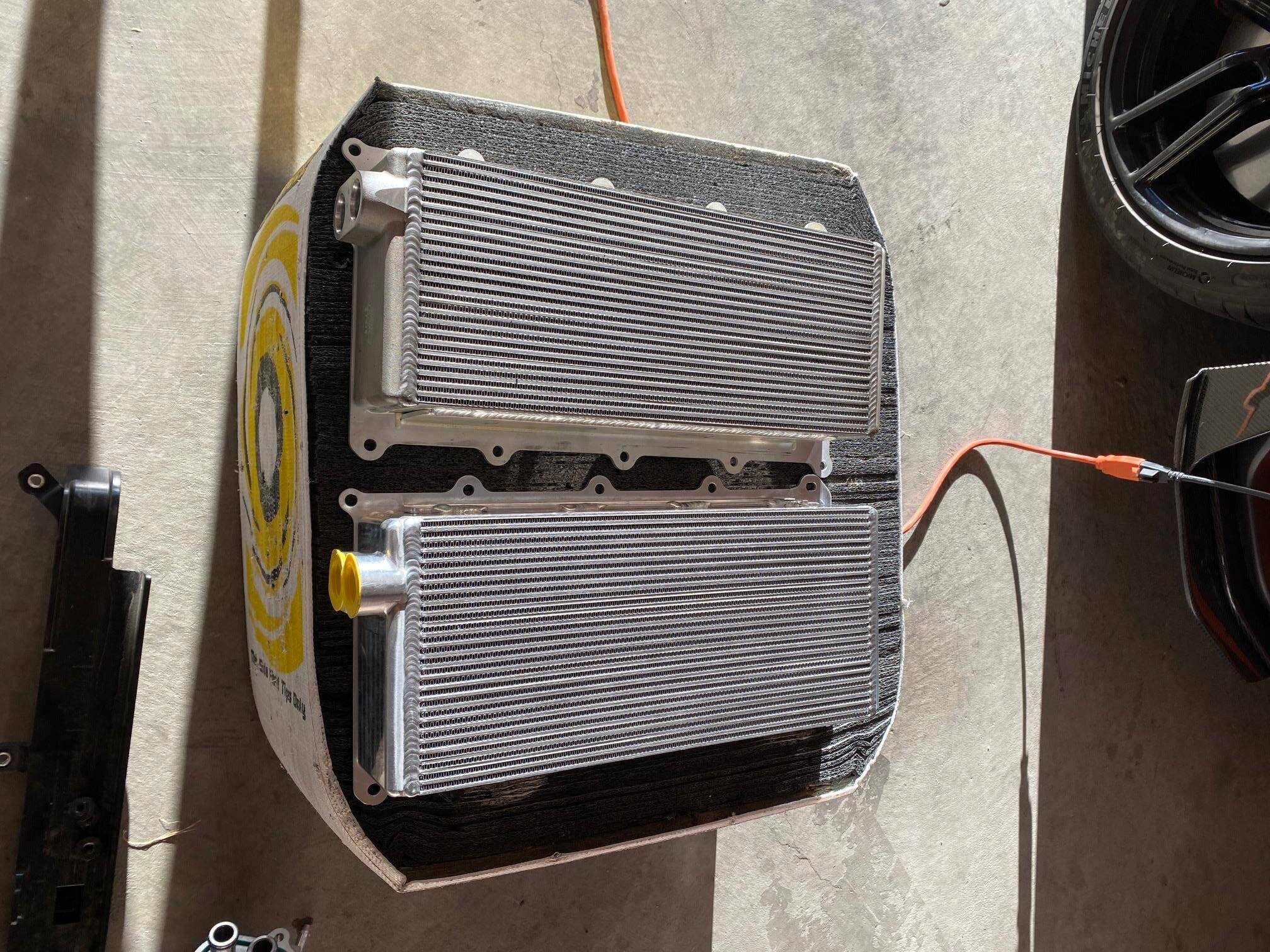

I went with the Whipple IC brick and billet manifold. I did the install a few weeks ago. OEM IC brick and Whipple are the same height, the difference is in the width: OEM 146mm while the Whipple is 161 mm, so a delta of 15 mm. The install isn't bad (100x easier than the Kook LT headers I did). I think it took me under 3 hrs to complete. Taking the fasteners that lie underneath the cowl panel grille are a pain. The only other fastener that is a pain is the nut that holds the wiring harness retainer that's behind the blower... it's in a really tight/awkward spot. I'll attach a few pictures. No tune yet. Now that I'm back from travel I'll do the Whipple billet tensioner, GripTec 2.65 pulley (unless I change my mind and go with the Satera 2.75 clutched pulley) and the SPE 180-degF thermostat then remote tune.
