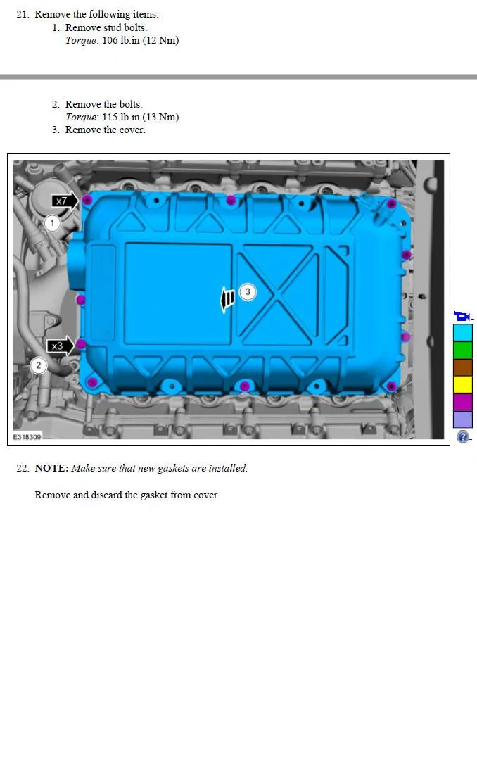

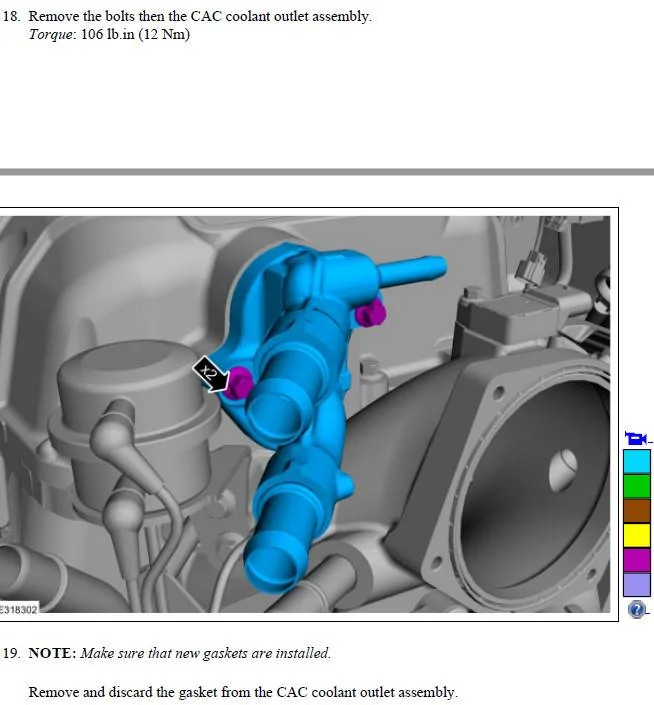

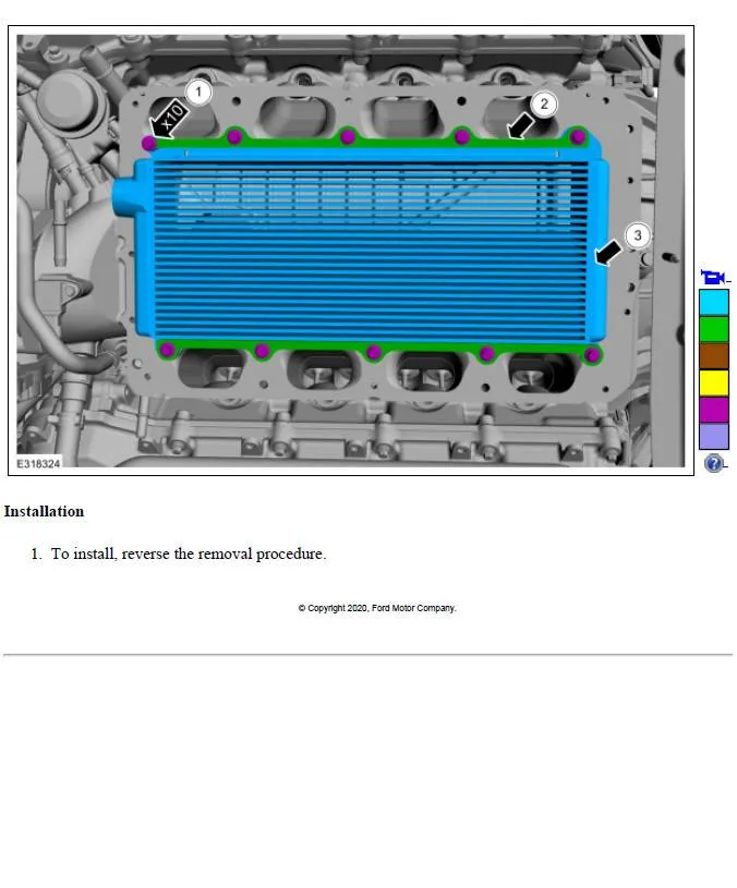

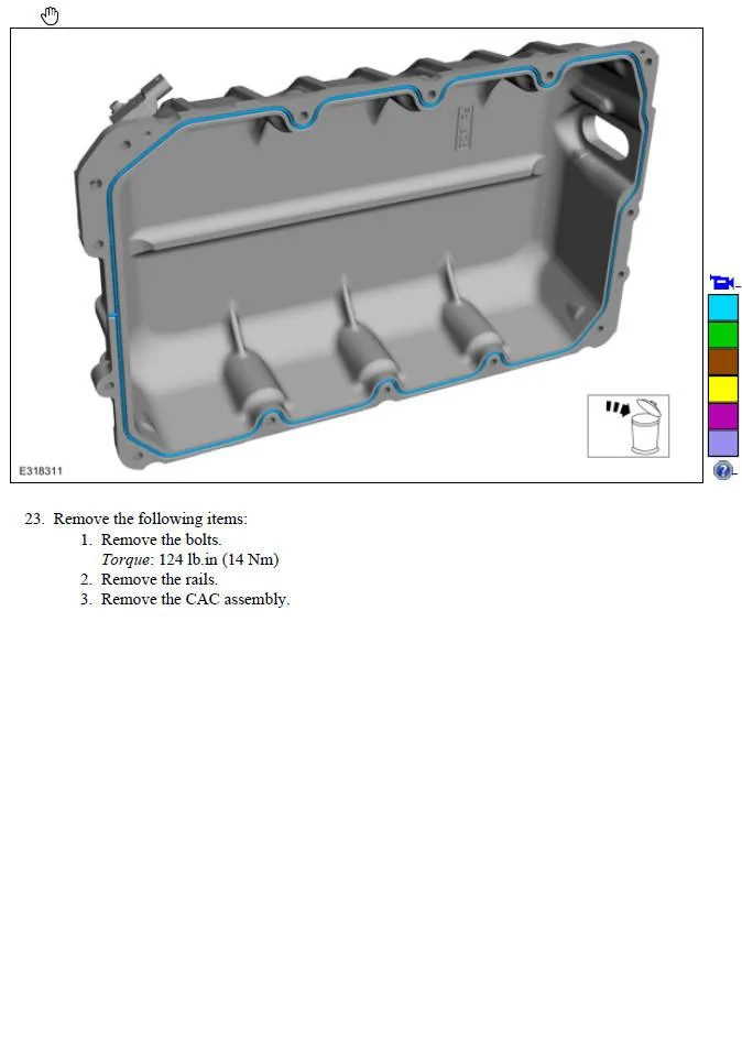

I did the Whipple IC brick and billet manifold along with the SPE thermostat a few months back. Below are screenshots of the torque specs for the IC lid, rails that hold the IC, and the cooling manifold.
