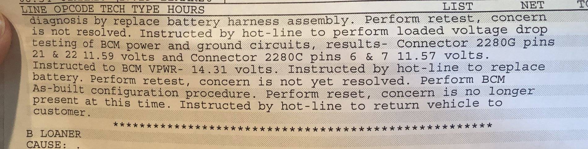

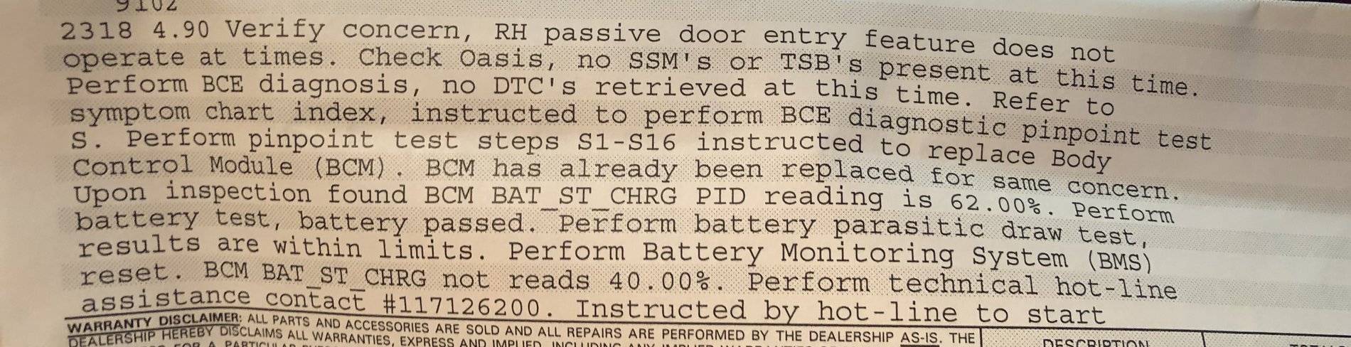

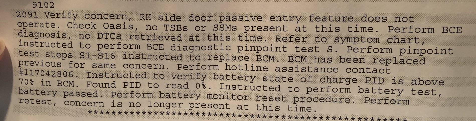

I brought the car to 2 different dealers. They replaced the bcm and the door handle 2x. They supposedly traced through all the door wiring and reset a bunch of stuff before. The photos show the last 2 visits.
The door handle works for 7 days if the car is not driven anywhere. If I drive it once a week It will always work.
