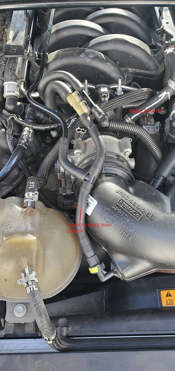

Looking at your photos a bit closer your vacuum hoses are not properly installed. Too bad you are not closer.
It looks like it is pulling vacuum where the IMRC needs fresh air. The hose on the passenger side top of the intake manifold is supposed to go to the CAI. It is hooked to the aspirator. Without actually having the car to look at I can only use an educated guess that it is not correct. It definitely does not need 2 aspirators.
Find a mustang performance shop and let them look at it. It may be an easy fix.
Another piece of the puzzle that leads me to believe it is hooked to vacuum is normally the IMRC will stick open due to a spring opening them and vacuum closing them.

I don’t have a diagram, and there are no performance shops per se here. The intake manifold and JLT intake seem to have an excessive amount of hoses.

You need one for the brake booster. Should be on the drivers side of the intake manifold. You need one for PCV. This is on the passenger side of the manifold. You need one hose from the drivers side of the CAI to the driver side valve cover, looks like another PCV valve. You need one to the EVAP valve the thing in the center on top of the Manifold. Has a wire plugged in also. Then you need the fresh air for the IMRC, that is the top hose on the manifold and goes to the passenger side of the CAI, small nipple. I'll see if I have a pic as I have a truck manifold on mine right now.
Any mechanic should be able to hook up the hoses correctly with my directions here. Neither aspirator is needed

Do we happen to have a picture of what it’s supposed to be?
Also, would a lockout fix all of this?

Here is what it should look like
