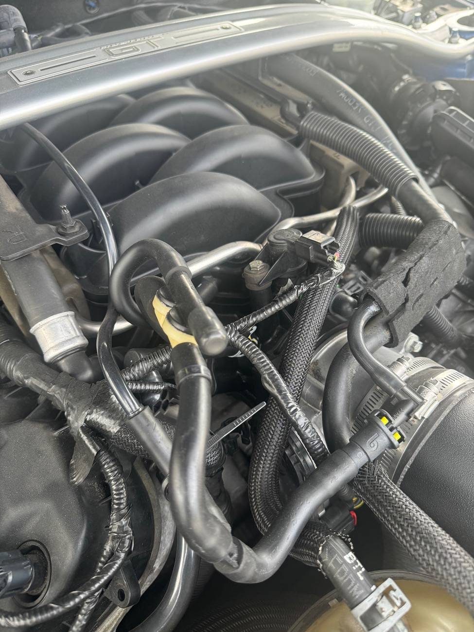

reju212
reju212
Sep 2, 2024
75
Evansville, IN
2017 Mustang GT
Then he still needs a tune. Sounds like he is not tuned. Cheapest is to replace with another 17 manifold.
The car has to have a tune already. Has a VPM throttle plate, JLT intake, etc. But idk what it is. I bought it used.
K4fxd
Apr 2, 2020
122
13,495
12,324
NKY
Dan
2017 gt, 2002 FXDWG, 2008 C6,
Sounds like you might have a gt350 throttle body. VMP makes 2 plates one fits a GT TB to a 350 manifold and the other fits a GT350 TB to a GT manifold.
What color is your manifold on the top? Is it silver or black?
reju212
reju212
Sep 2, 2024
75
Evansville, IN
2017 Mustang GT
I will take a couple pics tomorrow. I’m not super familiar with this particular car. I’m new to this body style. I have a base GT with a performance package. But I know a few things have been done. Especially since I saw the flow master mid pipe and a flow master exhaust when I first saw it. I’ll get a few pics tomorrow. You can let me know what I’m dealing with.
reju212
reju212
Sep 2, 2024
75
Evansville, IN
2017 Mustang GT

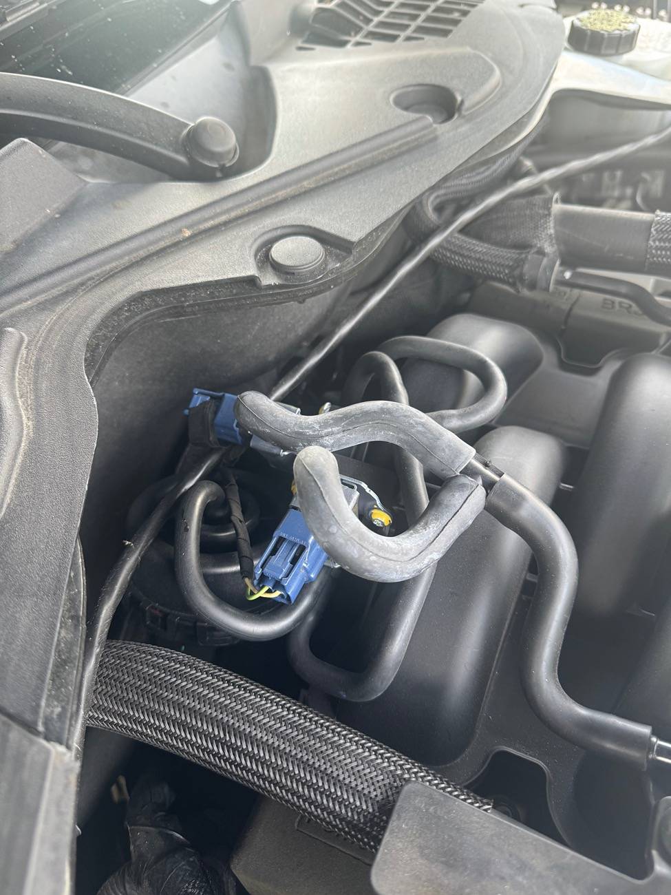

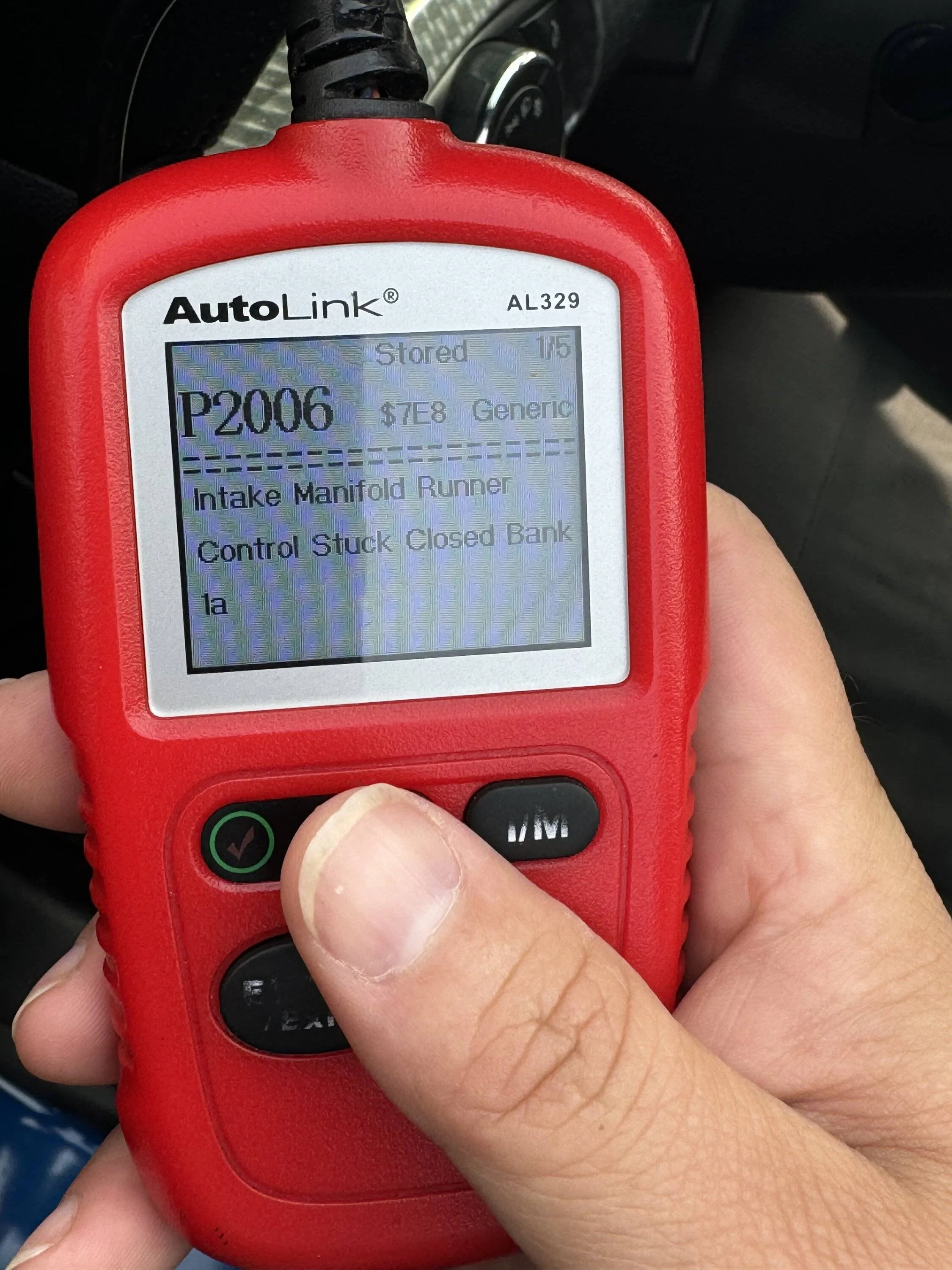

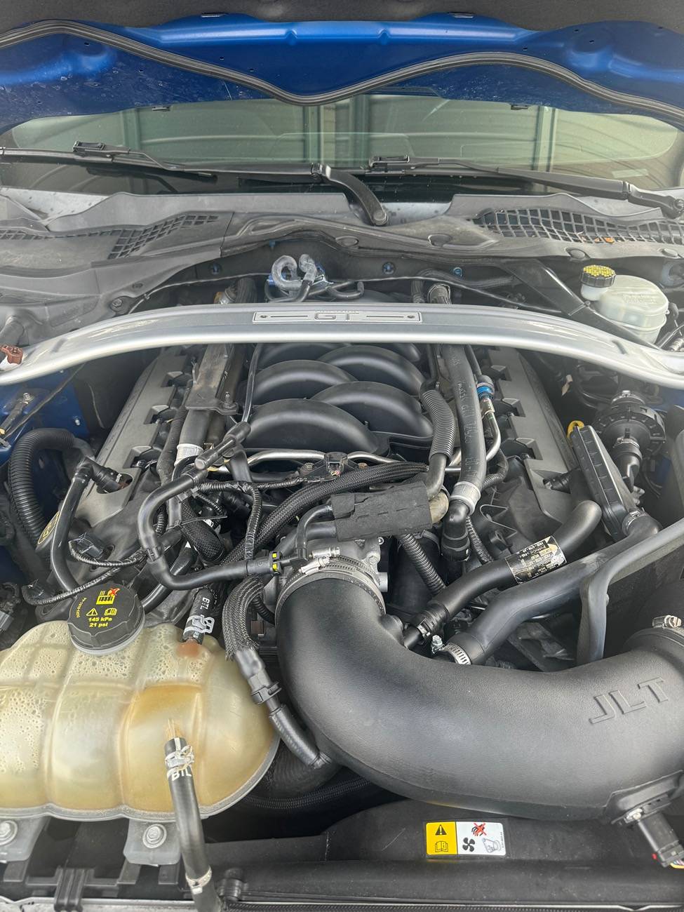

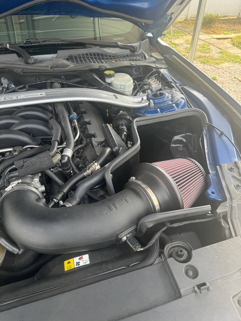

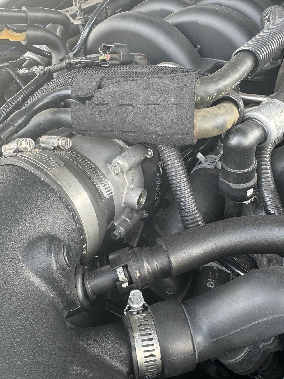

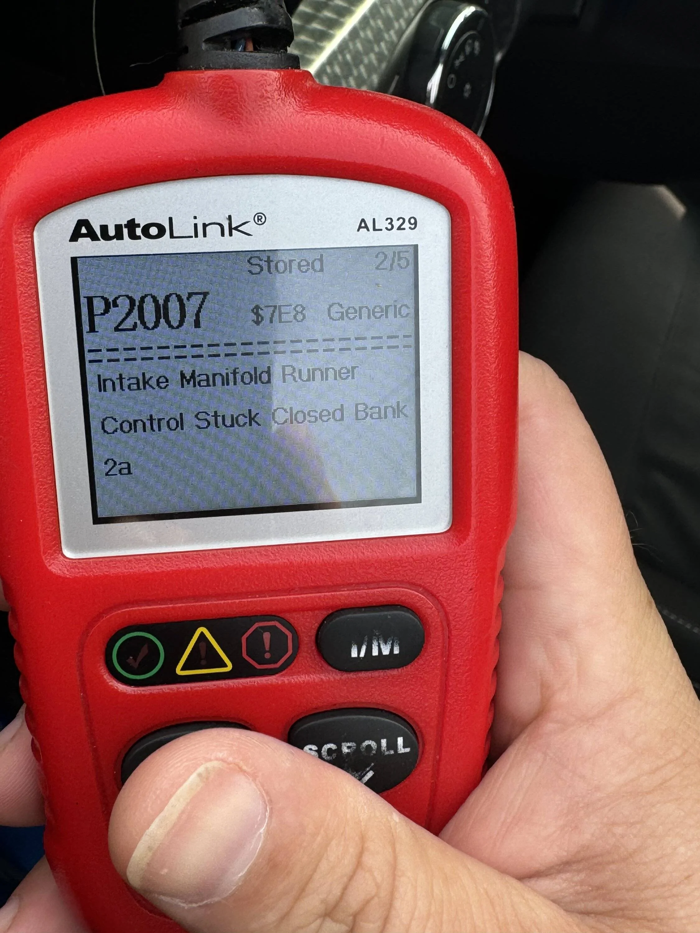

I attached some pictures to show the intake and to get a little more information.
