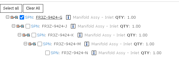

Part # revisions for the gen2 manifold. Not sure what each revision did besides get more expensive (Retail price has increased 425 and dealer has increased 235). -N is the newest
Regardless, the Gen2 manifold is a low RPM turd.
Throw the Gen2 in the trash.
GT350 manifold FTW.
GT350 manifold FTW.
I need to finish my race ported boss project. Do wish I got the 350 mani instead of the 18.
