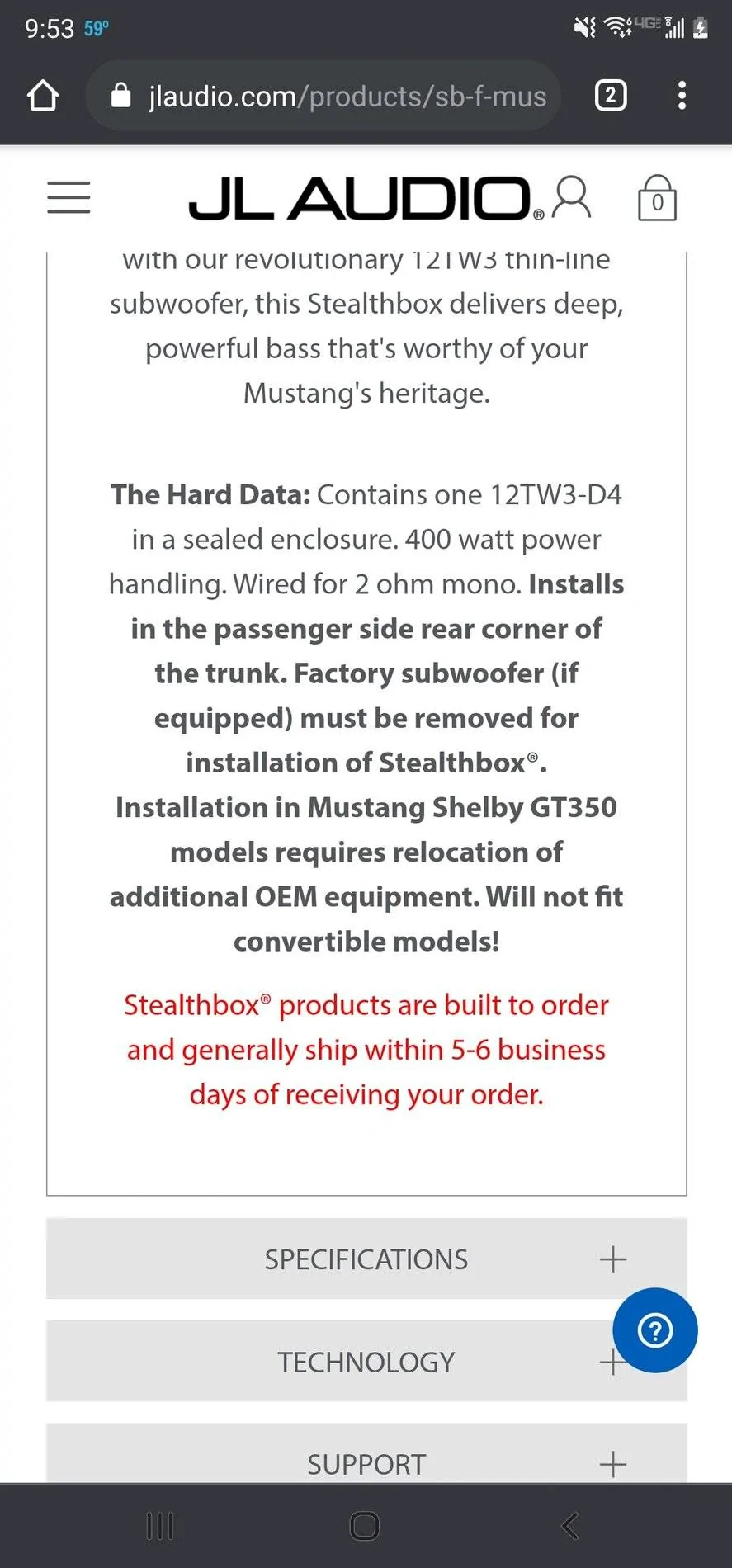

I wouldn't bother with it. JL says on their website that in order for it to fit, you need to move some car equipment in area it goes on the gt350s (not sure what's behind the sides but they have the disclaimer listed).

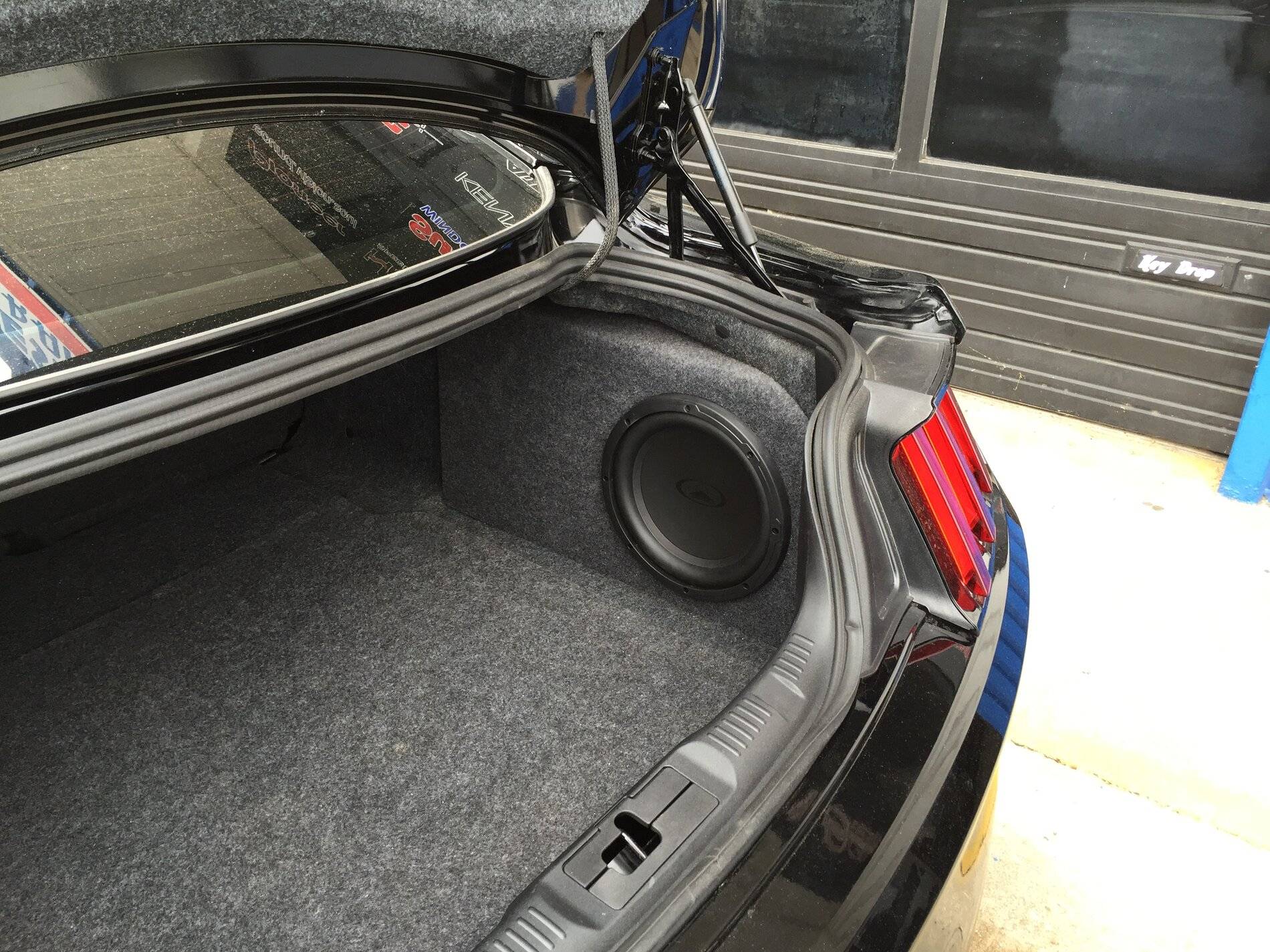

Order a JL sub and one of these boxes.. it's what I used and didn't have to modify anything in the trunk in that cubby area.

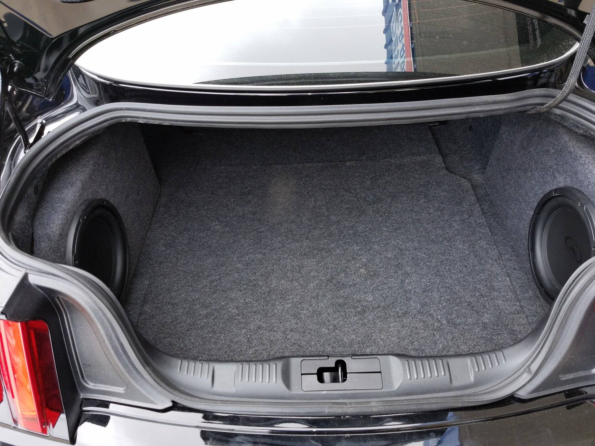

Is the GT350 trunk space really that much different than a GT? I installed a Stealthbox in my 2019 Bullitt and the only thing I had to remove was the factory metal subwoofer bracket.

Don't know but their statement is pretty clear.

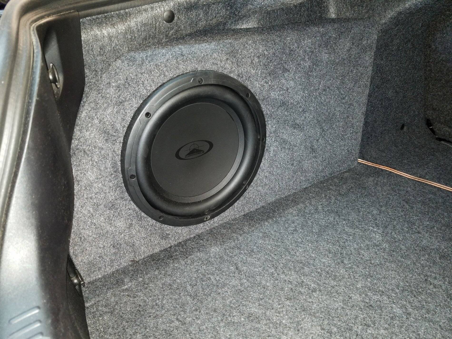

Ok, so I lied. I ended up getting the JL Audio TWK88.
I also got the Hertz ML Power 5D amp.
Alpine A-60M subwoofer amp.
Hertz DSK 165.3 6.5.
Hertz C26 OE Cento tweeters.
Dayton Audio 3.5 for the dash.
Audiofrog GS25 2.5
Focal RCX 165.
JL Audio 10" woofer
I only have the woofer, Dayton, Focal, and the Hertz tweeters installed so far.
