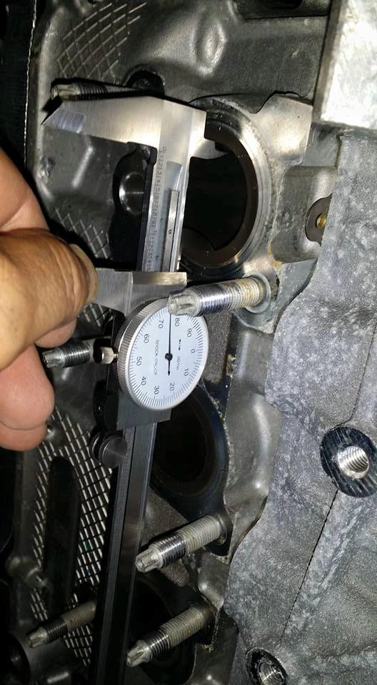

Can you tell how big the exhaust port is on the head?

Micrometer is packed since we're moving, so I can't do exact measurements. I can do measuring tape though
