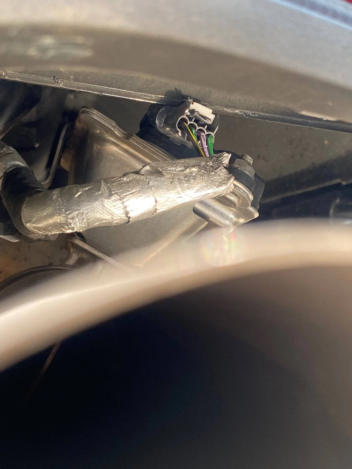

Please update us on your buddy’s findings.
He just sent me this-looks like the wiring is kind of pinned in a weird way.
Yep, there it is. I can see damage to the wire coating on the green/white and purple/black wires. The connector also looks pinched as you mentioned and/or damaged. The area Where the connector is pinched is what needs to be dremeled out and clearanced. Now looking at that, tell me Ford didn’t know that this would be a problem somewhere down the road on cars with AE? They definitely knew.
well damn. thanks for the info. always something!
