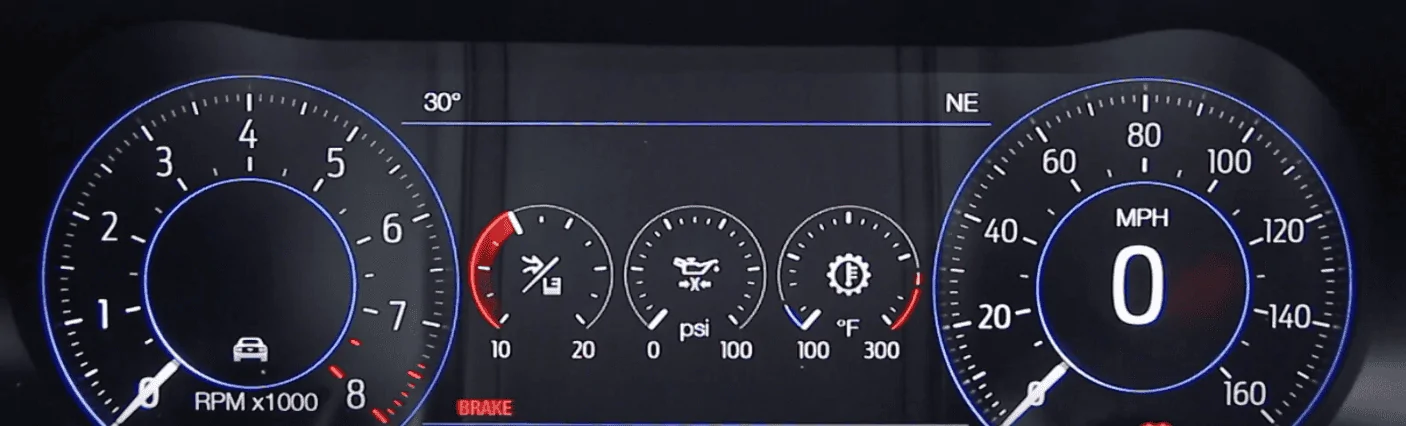

Have you considered that maybe it is reading correctly, and it may be time to put a real pressure gauge to confirm everything before condemning the work you have done?
Oct 8, 2021
BEIJING
SUN
2018 mustang ecoboost
You're right, I haven't tested it with any other oil pressure gauge, so I'm also thinking about this issue. When I see the data read by the gauge, it's more like oil temperature,LOL
Oct 8, 2021
BEIJING
SUN
There's one thing I'm thinking, is it a firmware issue with IPC? Because the data read by IPC shows BAR, but the PP instrument displays PSI, this may be the biggest issue?

I think the key to the problem is the calculation unit of the instrument,This car is an American version,the oil pressure is PSI,but my car is an China version with BAR,So I decided to try that write the firmware of the instrument.

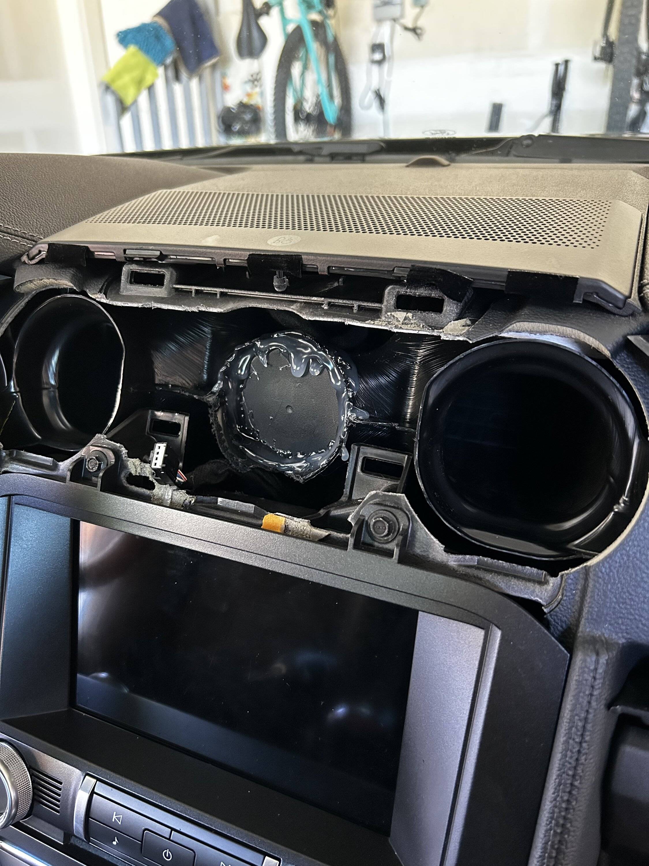

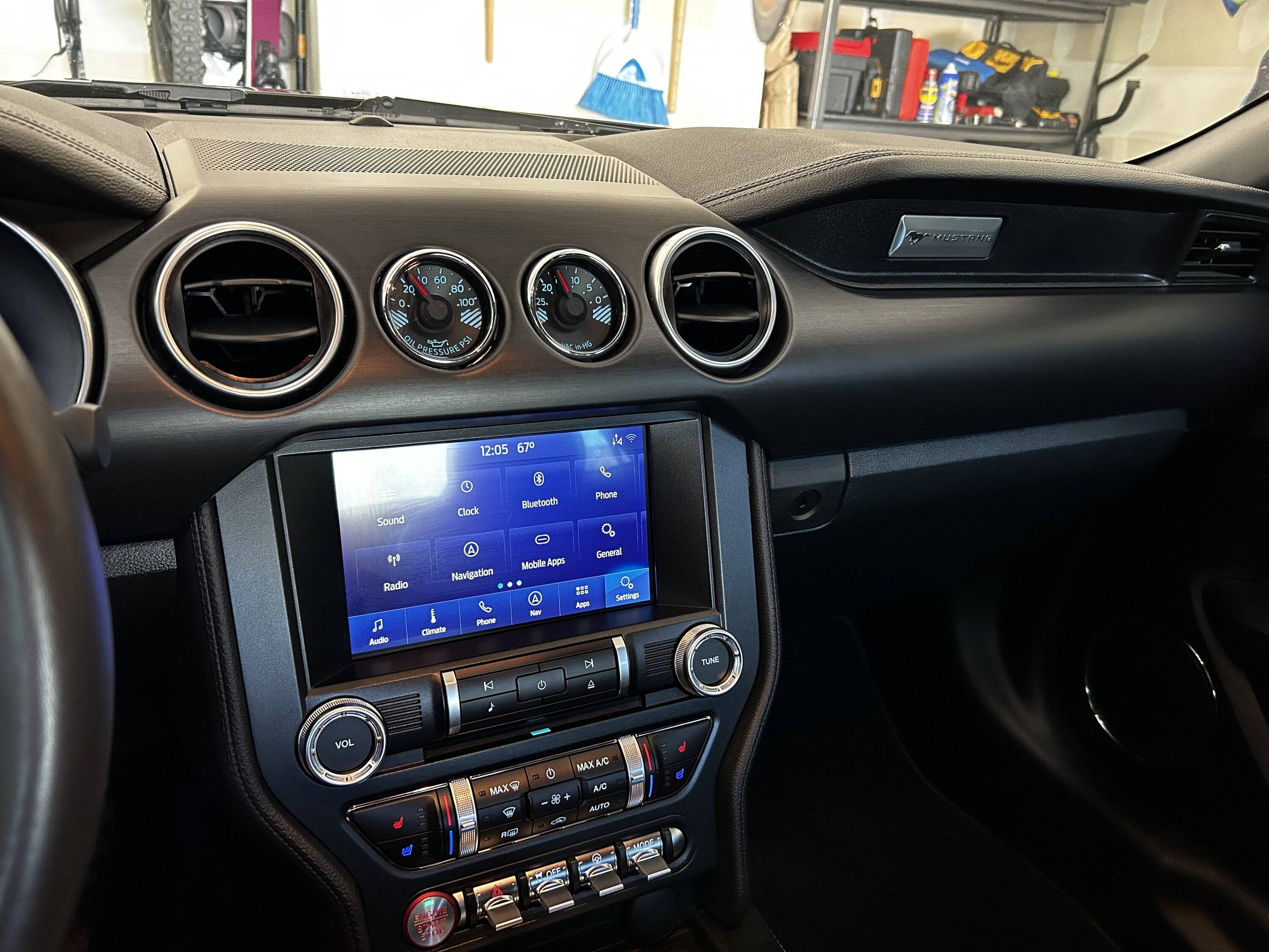

To add another data point to the thread, I just installed gt350 trim and performance pack guages into by base 2021 GT 401A and guages worked plug and play. Works perfect with my color aswell. There was a good bit of trimming nessisary on the center air vent. I trimmed a cap from a can of plastic plasti dip and a copious amount of hot glue to block off the center air vent. I also trimmed a little cutout on the bottom of the center air vent for the wire to have plenty of space. I used a dremel with a drill bit atachment for all cutting. After clearance conditions were met, I installed the trim piece without the air vents installed (they pop off very easily). After fitting the trim piece i re installed the air vents and a good bit of force was required for them to line back up as the spacing is different on the left and right vents on base vs performance pack. I used my original air vents so the trim would match throughout the car. Hopefully that helps someone in the future with the install!

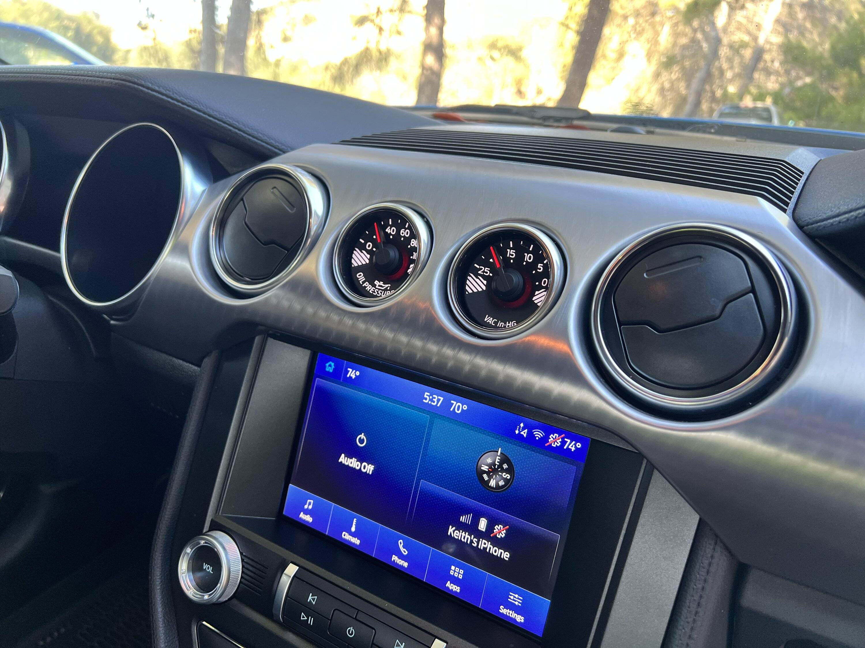

The gauges I installed on my ‘23 GT
(KR3T-10B944-BA) were plug-and-play…
Keith S
Apr 30, 2023
209
972
CA
2023 GT
No tune… Just plug them in and they work… both gauges (vac and oil pressure ) … Including the changing colors.
You do, of course, have to mess around with the center AC vent to make everything fit.
My car is a 23 GT premium 400A 6MT.
