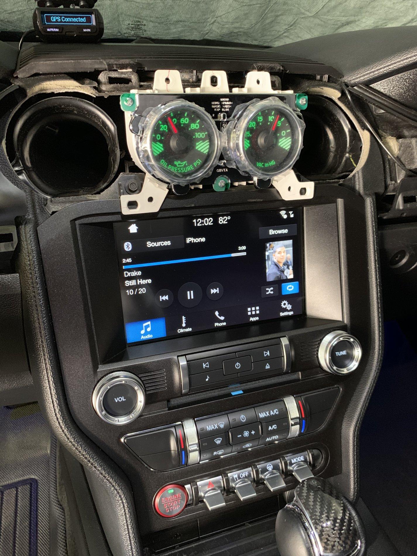

    I have a 2018 GT Premium. I will confirm it is plug and play... also MyColor does work also and no tune needed for me 2F6B70B7-D606-4A25-A987-439B138D3BDA.jpeg
