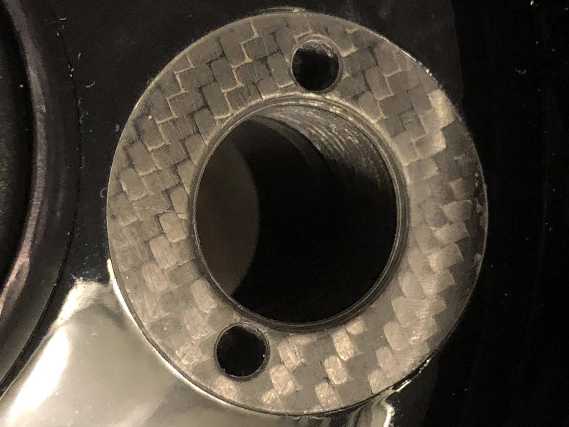

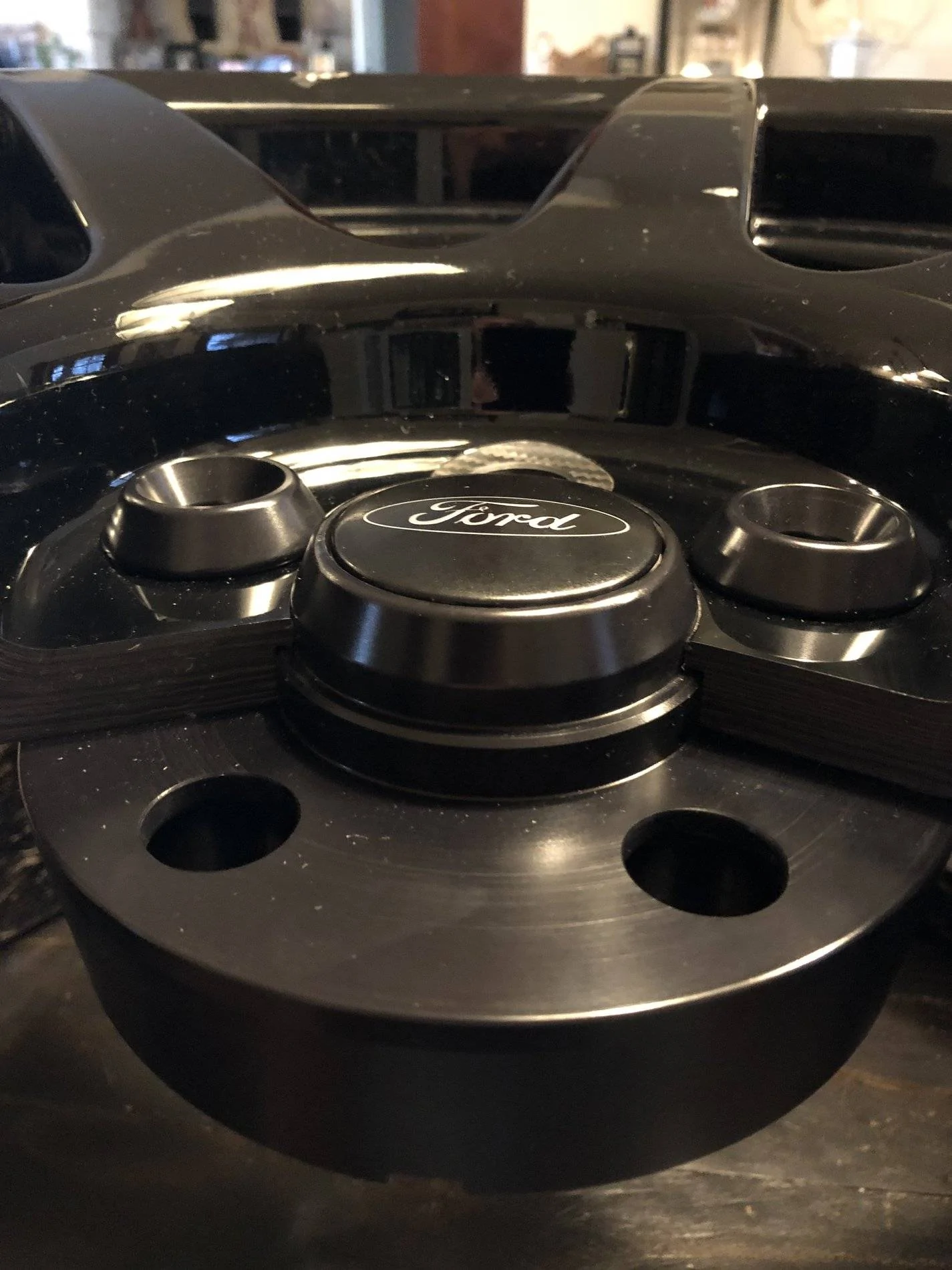

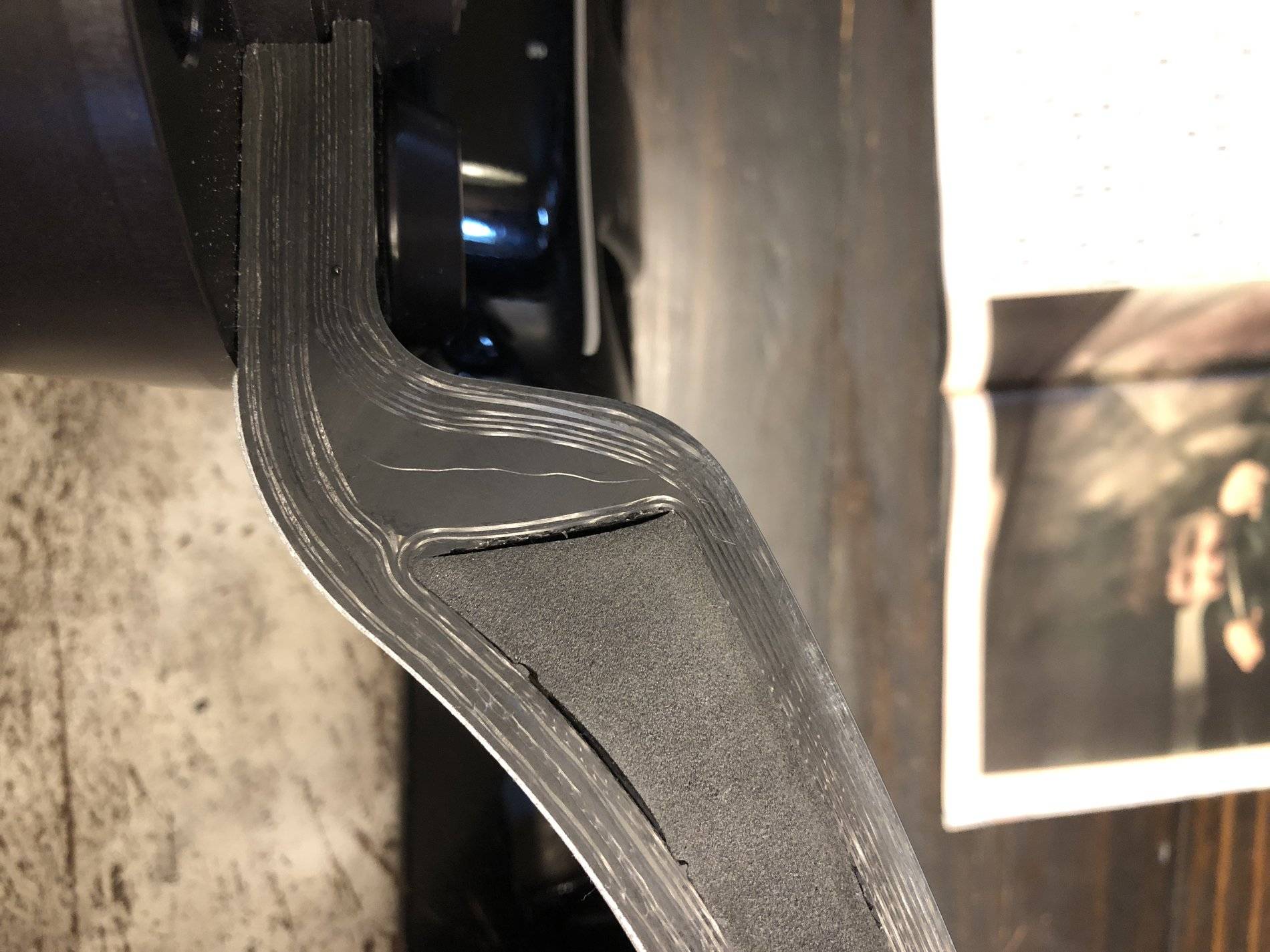

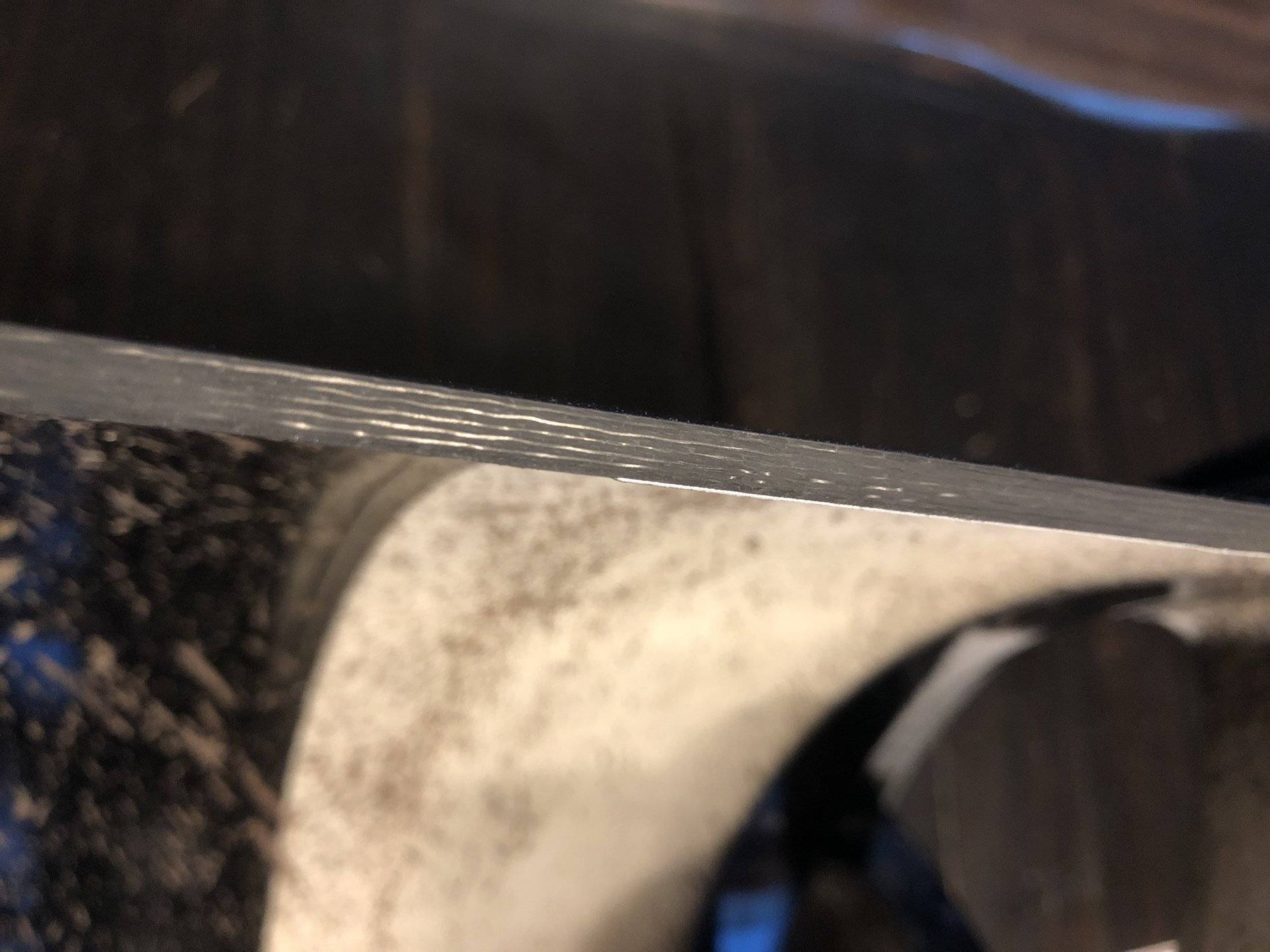

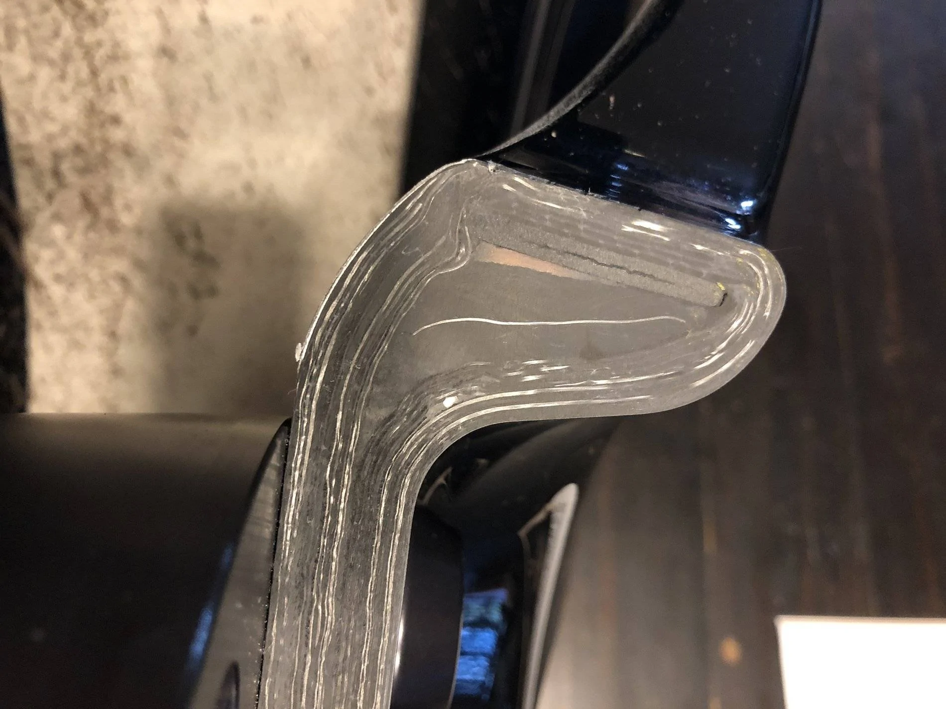

Thanks to the folks at Midwaymustangparts and the unlucky previous owner of a CR CF wheel, I’ve had some craft time with a damaged 19” GT350R carbon fiber stock wheel.
For those who haven’t seen the innards of the Carbon Revolution 19” wheel...notable items of this design include the center hub and lug nut “mushroom” interface used to attach to our hub, the foam sections inside the spokes/inner hub and the thin metal sheath between the barrel/inner spokes and ceramic coating. I had no idea.

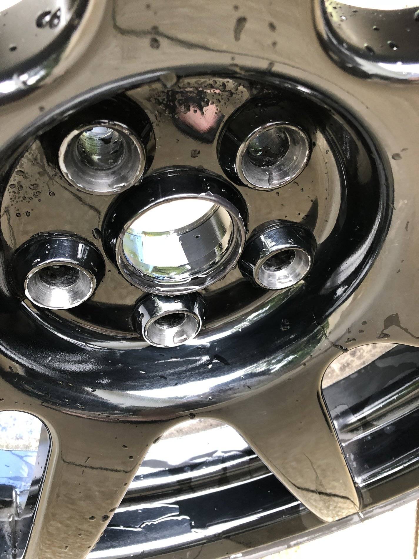

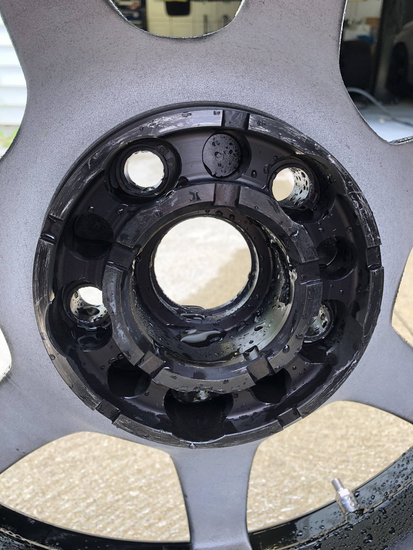

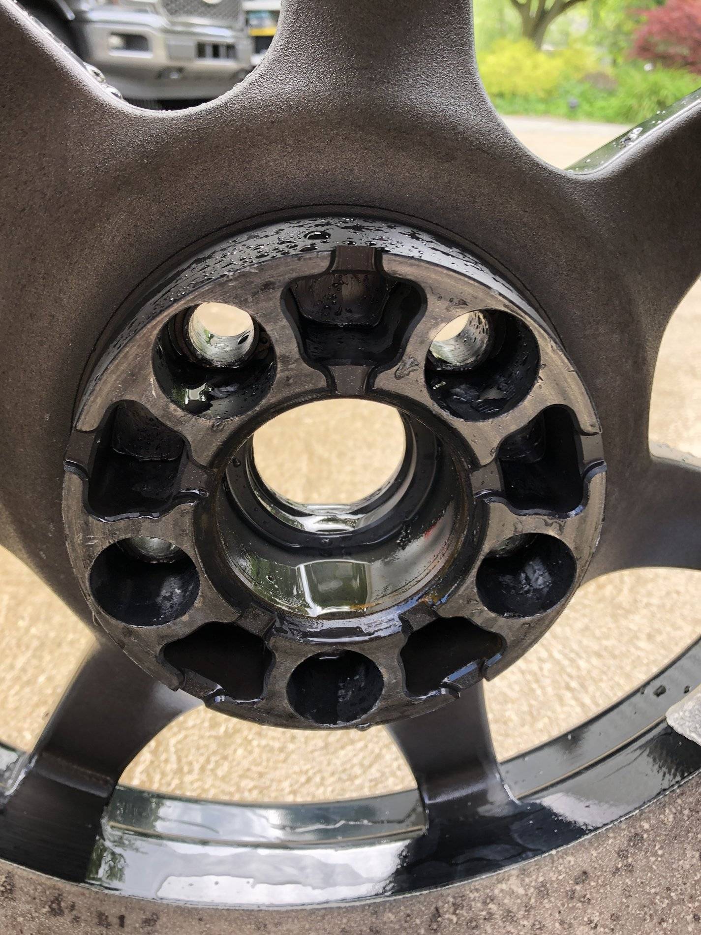

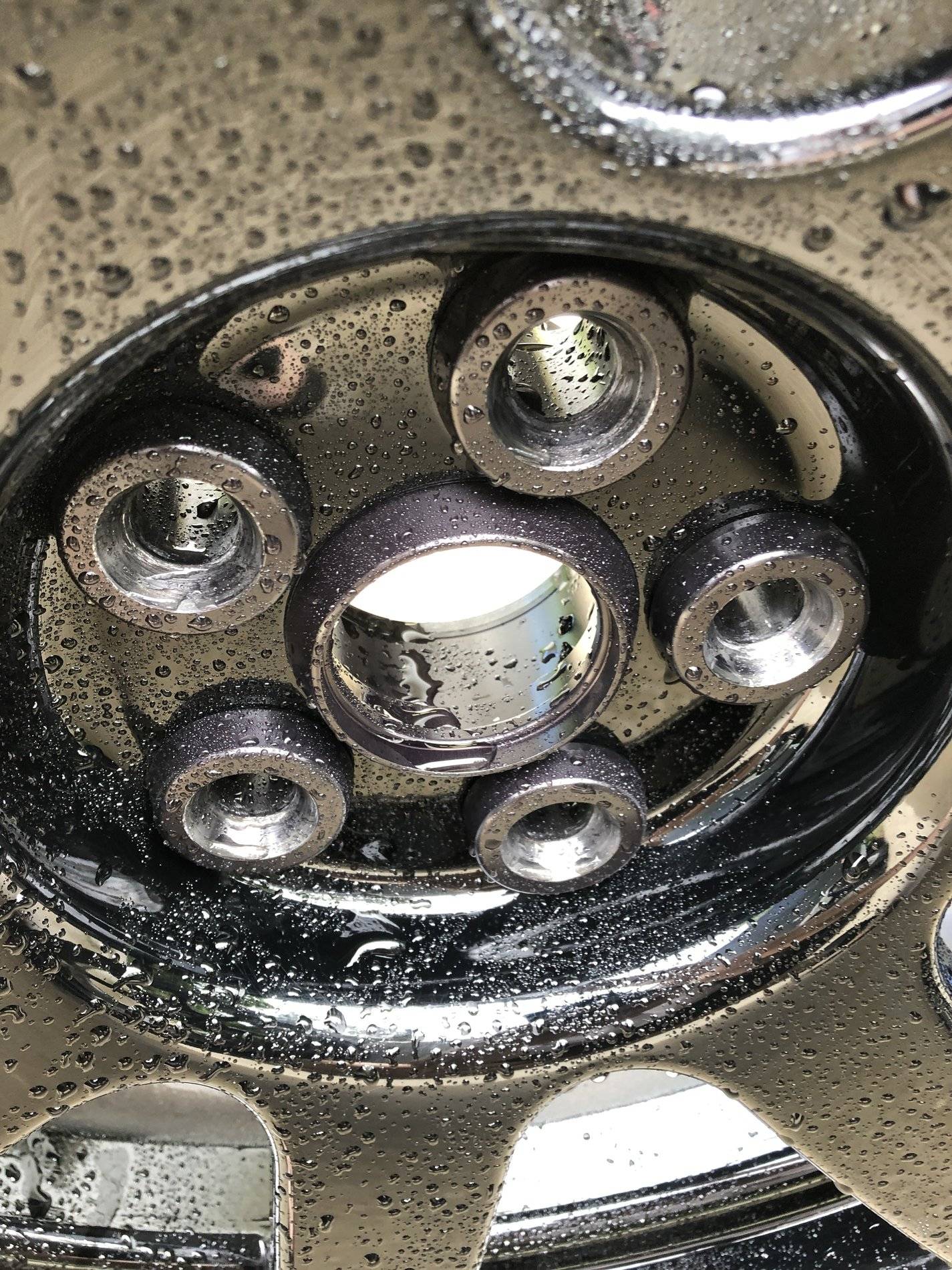

really cool. Are you sure that's from a 19. Carbon Revolution made 2 versions of the CF wheel. The reason I know that is because I have two sets of CF wheels and I was concerned the used ones didn't look like my 2019 CF wheels. The ones in your pics are the earlier version. Mike at Carbon Revolution customer support said they changed the design because owners/shops were torquing the lugs too tight and causing some damage.
Here's both sets of wheels, the flat lug surface is my stock 2019 wheel, the one like you show if the earlier model. Now it doesn't mean they still didn't use that style on 2019's, it's just not the most recent style.
The back of the hub is different too.

Which set of pictures is the newer style? Is it the first set, or the second set?
I see on the first set that the front of the lug holes have a wider (thicker) painted lip than the second set. Also there appears to be more material against the hub on the 2nd set of pictures.
The first set.
The first two are identical to what my 2019 R has. The bottom 2 are 2016 wheels I believe.

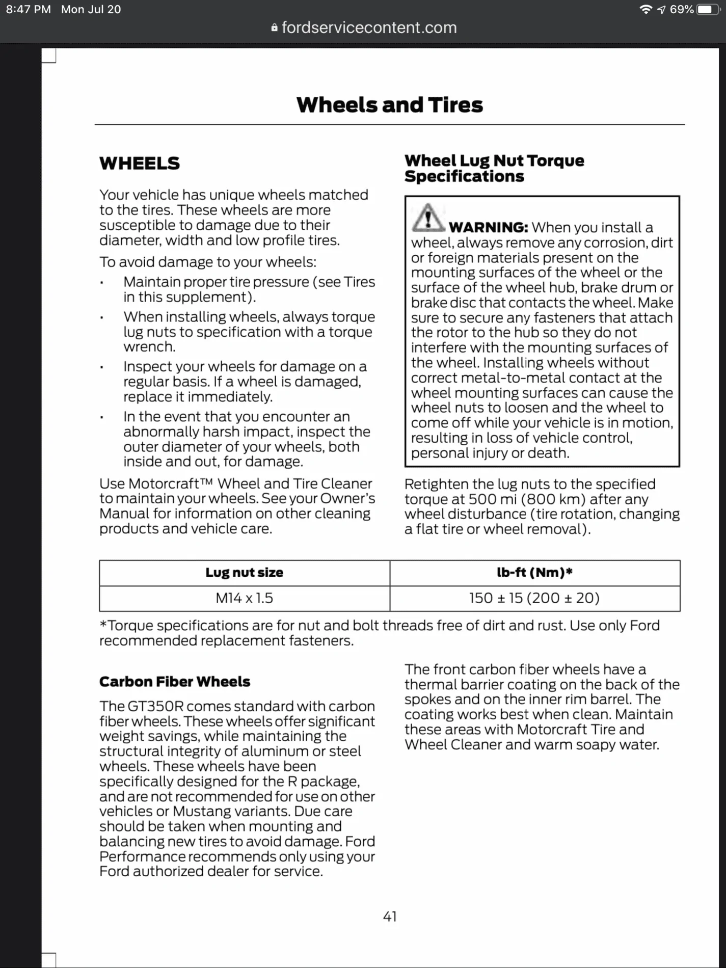

Ahhhh.... my bad. I initially thought you were saying a 2019 wheel, but I now see you said 19” wheel. My apologies. By the way the torque is 150ft lbs +/- 15

Because the manual says 150 + or - 15, so 145 seemed good. Do you see my science LOL. I also saw a post where someone said 130-150 is the range to use so I figured if the owners supplement says 150 then I'm better off going under a little that over.
