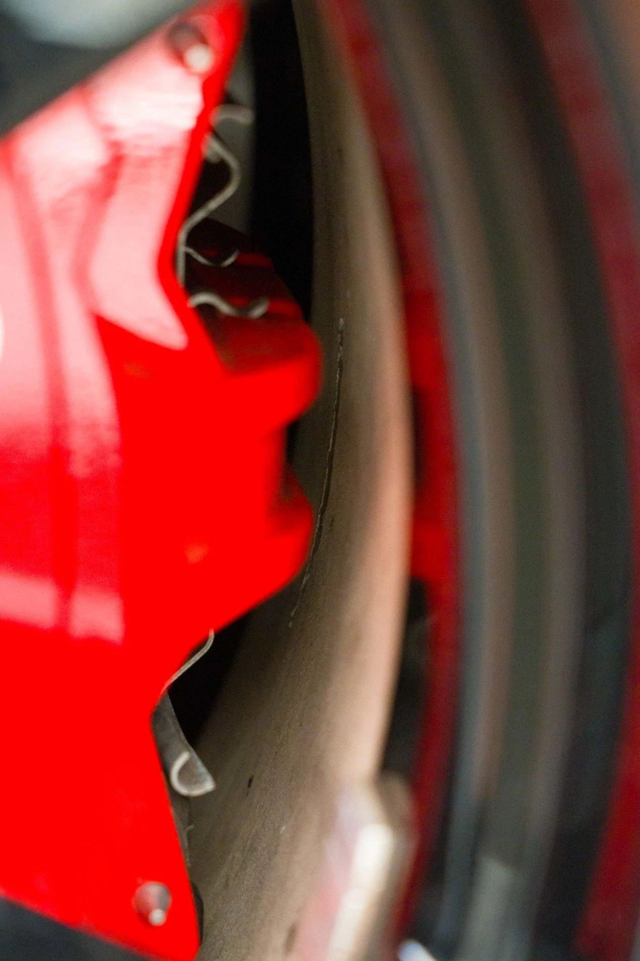

Here it is.... sorry I forgot to take a pic when I removed the wheel to inspect and clean, but you get an idea.It only shaved off that white layer of ceramic.

I would not worry about that personally, maybe only if you tracked the car extensively. Gouges like that are inevitable.
