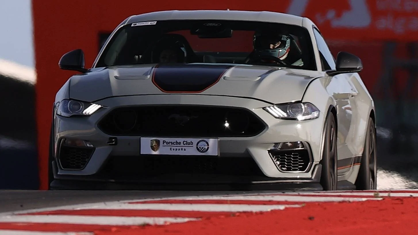

In trackday this is not normal or yes?
WD Pro
Jan 18, 2018
132
6,810
13,652
United Kingdom
Lime GT
Reviewing the last trackday pictures i just see the front wing a have not clearance to the floor, this picture is at 155 milles/h aprox.
Unless all your tyres are normally flat bottomed, I think it's an optical illusion based on the position of the camera and the hump in the road :like:
WD :like:
Edit - poster above beat me to it :like:

If you look at the photo you may want to ask a more concerning question...Is it normal to have flat tires, riding on my rims? Optical illusion.

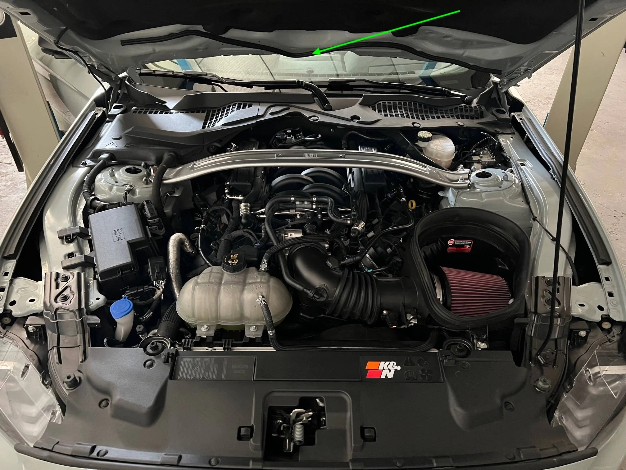

Be careful; if you remove that weather stripping you might get some hood shake. I have an aftermarket GT500 hood and it was shaking a fair bit until I realized the body shop didn't take the rubber off my stock hood and apply it to the new one. Once I did that it settled down.
I don't know who is the weather strippings, have you got a picture, and were they are?
Am out of town so not near my Mustang right now. It is the rubber strip that runs across almost the full width of the hood up near the top of the hood where your front windshield is. It does not run straight across but has a few bends in it.
This???
