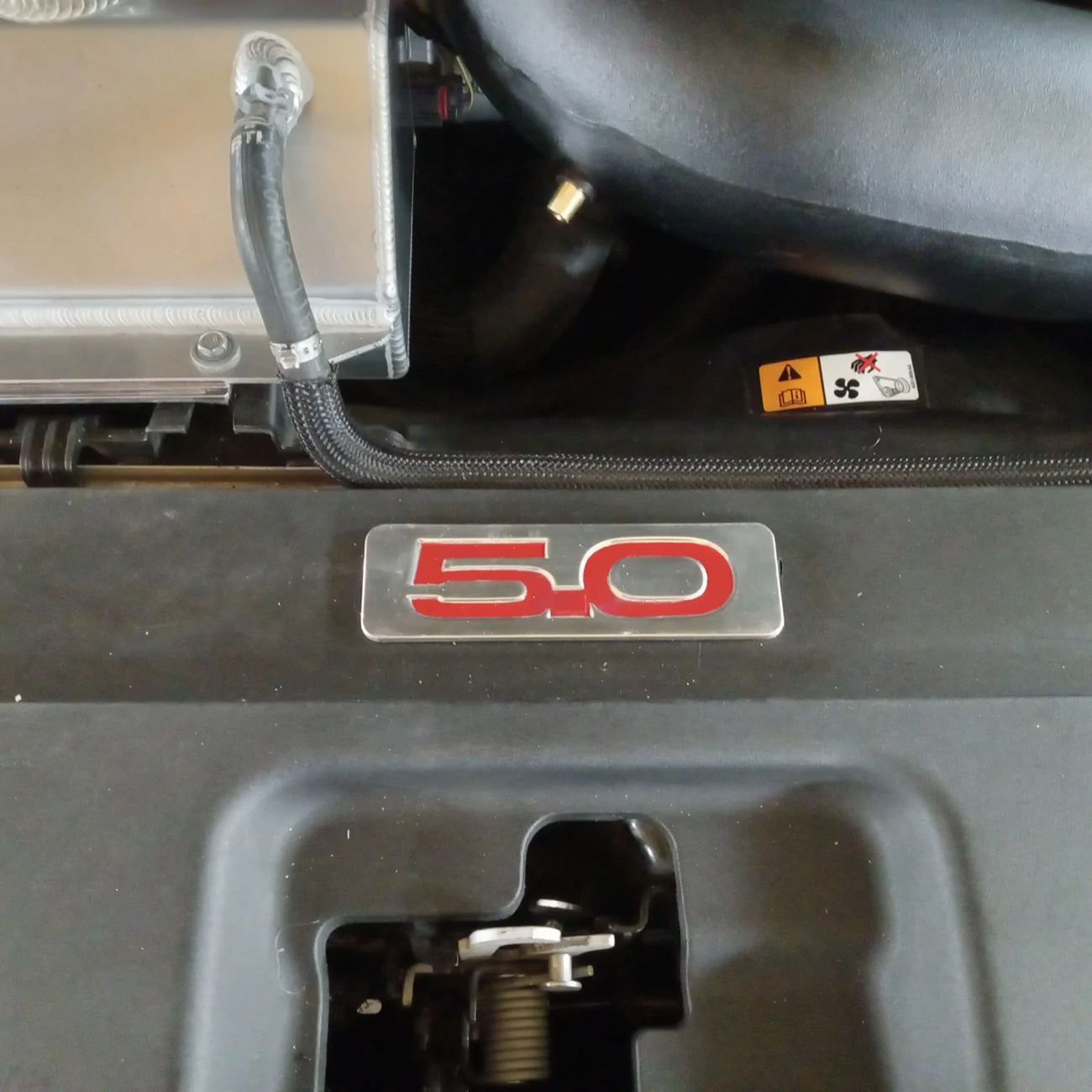

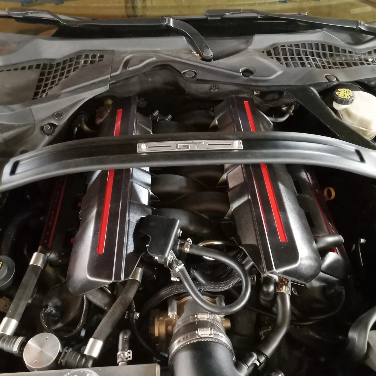

That is why I have this 2015 manifold for sale. I put a 2018 intake on my 2015 mustang. I put the lock outs on it as well. I bought and installed a 2018 engine cover and then I made a purge valve mount and once I did that the engine cover would not fit on the car. I modified the 2015 engine cover for the 2018 manifold and painted the covers black with red accents. In the pic you can see the purge valve mount. With the cover being two pieces, I get much better engine cooling, no huge cover to hold in heat.

I cut the 2015 engine cover in half to make it two separate covers (like valve covers of the old motors). I took the 5.0 badge off the 2015 engine cover and mounted it on the radiator cover.

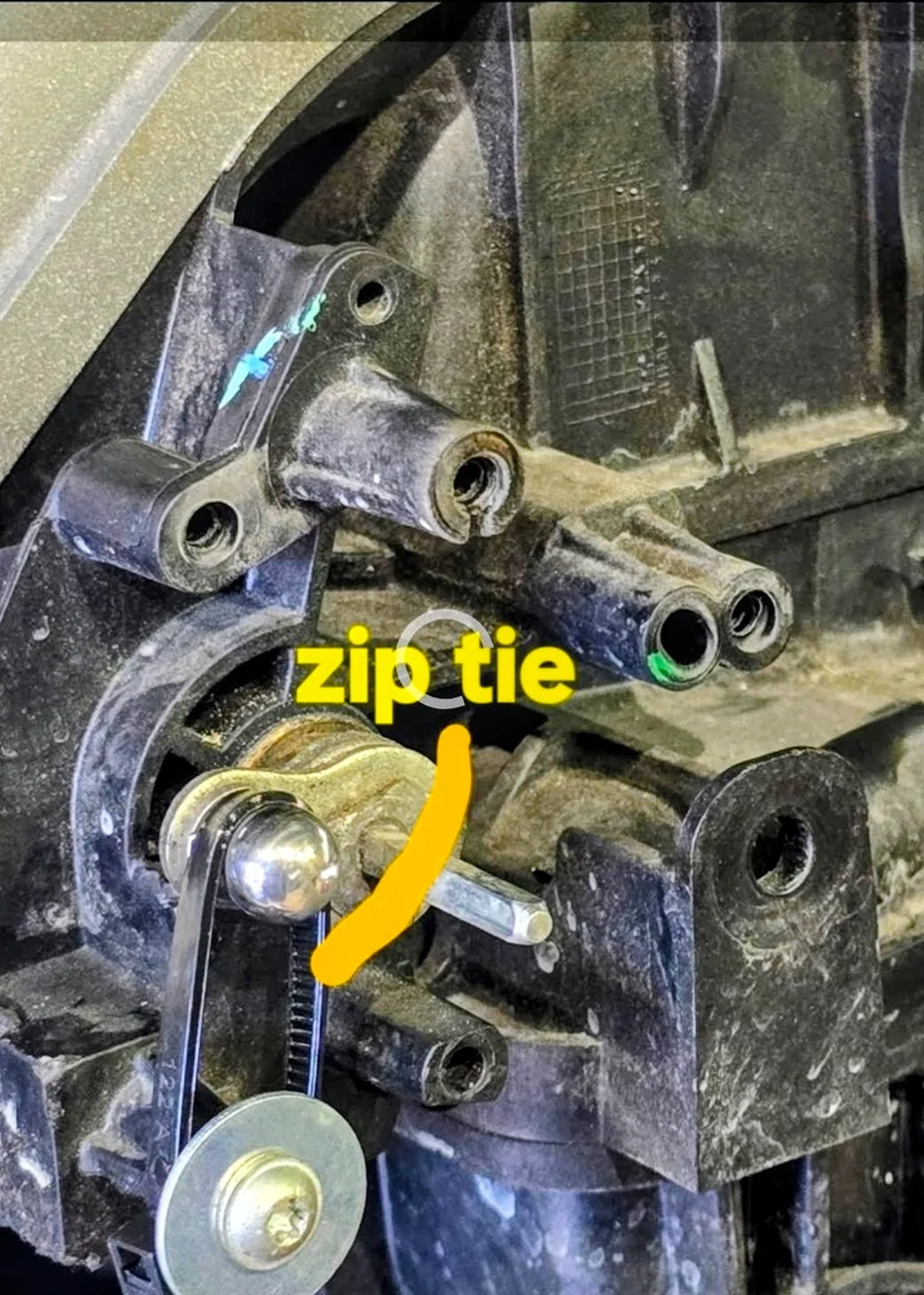

I have my intake manifold out and I'm getting ready to install my bullet CMCV lockouts but one side the shaft that holds the rotors is broken and there's nothing to attach the lockout too.
Secondly even on the good side I can't quite figure out how to do this and I'm wondering if these things are not good for what I'm doing they sure look the same as all the other ones. I bought them off eBay and they look identical to all the other ones.
So currently the broken side is open but I don't have much faith that it'll stay open and I don't know what to do cuz I don't want to put it back on and have them close and start throwing codes again.
I used zip ties
