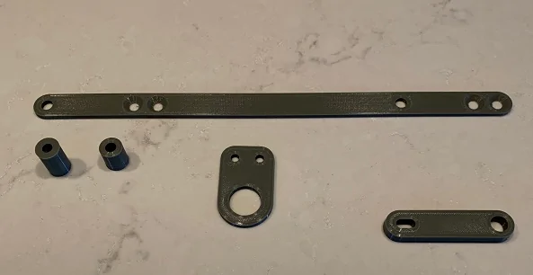

Not to high jack this thread. I saw your 18 manifold package sold in the classified market place. I just converted the drawings to a CAD file and 3D printed some of the parts to test fit before sending out. There are two sizes of standoffs not sure if both are used. Is it possible to shed some light on this?

The reason for the two standoff lengths is that the bosses that the four studs thread into on top of the intake manifold are different heights on each side. If the standoffs were all the same length, the intake cover wouldn't sit level. The longer ones go on the driver side.
Oh, and you need four of each length standoff. Hopefully printed parts are robust enough.

The 3D print was for a test fit, I plan on having them machined out of aluminum.
Thanks for the quick reply.
