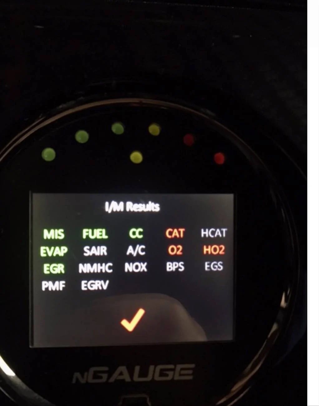

Trying to get to a solution which has been talked about a lot here. Trying to get the IM monitors to ready. “Emissions state”
2016 ford mustang Gt- Vortech supercharger, boss manifold, long tube headers, injectors, kooks green cats, Corsa cat back.
Lund says nothing is changed in emissions, but why don’t I get any codes or DTC’s?
If I unhook the rear o2’s should I get a code? If I do this and don’t get a code what does that mean?
How do I get to the bottom of this, determining if they are tuned with a certain parameter to “not ready” or turned off. They are not grey on my Ngauge or OBD2 reader so I don’t think they are turned off.
Putting new rear O2’s on and defoulers currently.
I just find it strange I don’t get any codes. I think I actually want a code to see what’s working at this point.
Car previously ran without cats and also no codes.
How do you force Lunds hand for answers on this? it’s like talking to a wall.
Anybody recommend a tuner that can actually achieve this.
Thanks everyone.

Which ones are not going ready? Did they go ready previously on the same tune?

O2, Ho2,Cat

Thanks. Just talked with Lund and apparently the tuner didn’t turn on Adaptive. Got a new tune and see what happens this time. Also have o2 extenders to try if that doesn’t work and new rear o2’s.

Update for everyone. After only 20 miles all monitors went green. No drive cycle needed. Passed OBD2 emissions check.
if someone is having this issue I think you really have to press on your tuner. Lund was very difficult. But I eventually told them I’m not getting any engine codes with rear o2’s unplugged. Which was not true. This got them to look into my tune and informed me that the tune didn’t have “adaptive” on. Not sure what it means. But new tune was titled emissions vs the tune I had previously. Also installed new rear O2’s to rule that out. And like that all monitors set. I also had new rear o2 bungs installed at the green cat exit. As close as possible. Instead of the O2’s being further down in the 90 degree section. Did this help? Unknown, but also what I did. Hope this helps someone.
