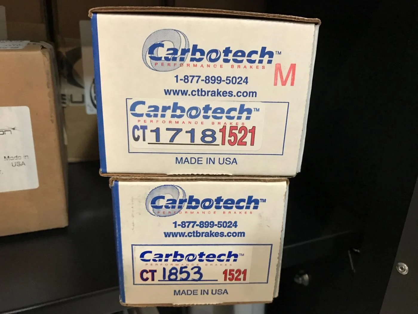

I went this route with new brake pads. At the time (October 2016) these were some of the few pads available. I have used these for about 2000 miles and the squealing is non-existent. Plenty of brake for the street and the dust level is way down. I am sure there are similar or maybe better available now but I have good luck with these.

Very interesting. Do you notice anything less in terms of brake performance by chance? And did you have to go through a bed in process with those?
