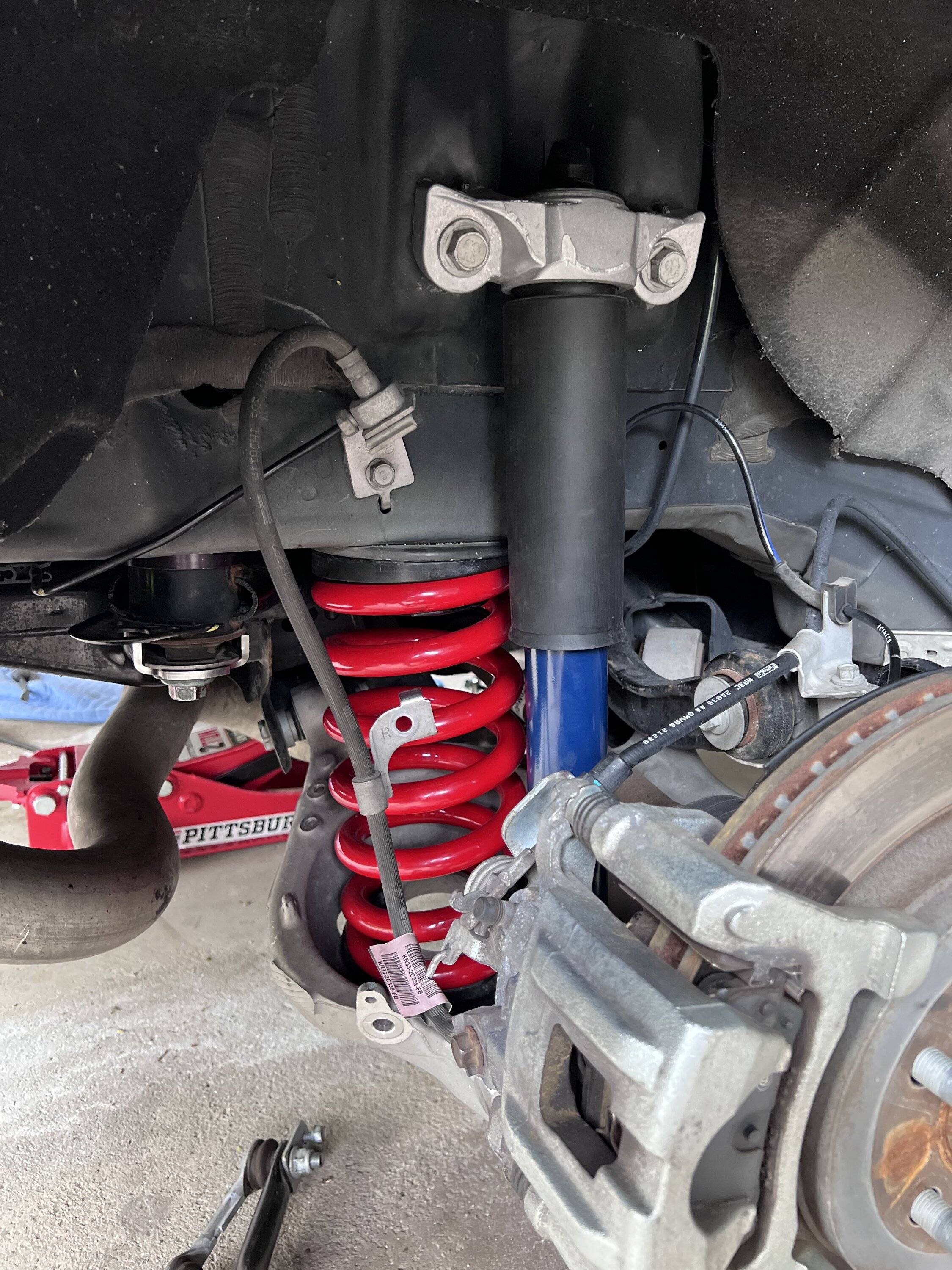

Anyone near oakbrook area that’s done rear spring install? I’m losing patience trying to get these OE springs out. 😂
I did mine when I installed my lowering springs. Definitely not an easy install. Ended up using a reversible dewalt clamp with a block of 2x4 to push the subframe down low enough to get the spring out. Was hitting the exhaust but I didn’t want to go the route of taking that off. Finally managed to snake it out. Getting the new spring in was a lot easier.
I have a feeling that taking the exhaust off is my only option. I’ve currently got all but the inner two bolts out of the control arm and still can’t swing it.

And I already have my IRS alignment in place with the cradle lockout so I don’t want to drop the subframe again.
Ugh, an extra step I was glad to avoid. I did end up taking off the bracket that held the front sub-frame bolt. The videos I saw all said to loosen it but it was hanging me up. Managed to get a little extra clearance with it off.
yea I had all of that off completely when I was doing the alignment kit. Still couldn’t get it off. Very irritating 😂

That’s wild, I got mine out so easily the two times I did it.. I’m close but I work tomorrow and Monday, couldn’t help until Tuesday.
I usually don’t get home until 7pm during the week. So if I don’t have it figured out by next weekend I might bother you for some help. I’ll gladly compensate too!

It was years ago that I did mine but I don’t remember pulling exhaust off. It was a fairly easy install. Idk if things changed from 15 to 22 Post a pic of how you have things right now.
I got em. Sway bar removal and all the outer bolts on the control arm gave me some extra clearance. Then 1 pry bar between subframe and body pulling down. Second pry bar underneath the OE spring to lift it out. After I got the first one out the second was a 10 min job. I was probably over thinking it.
