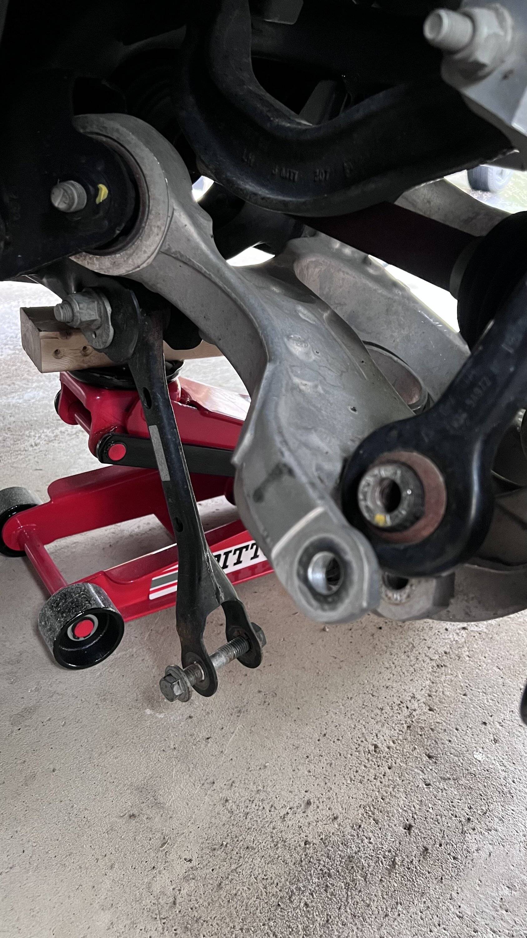

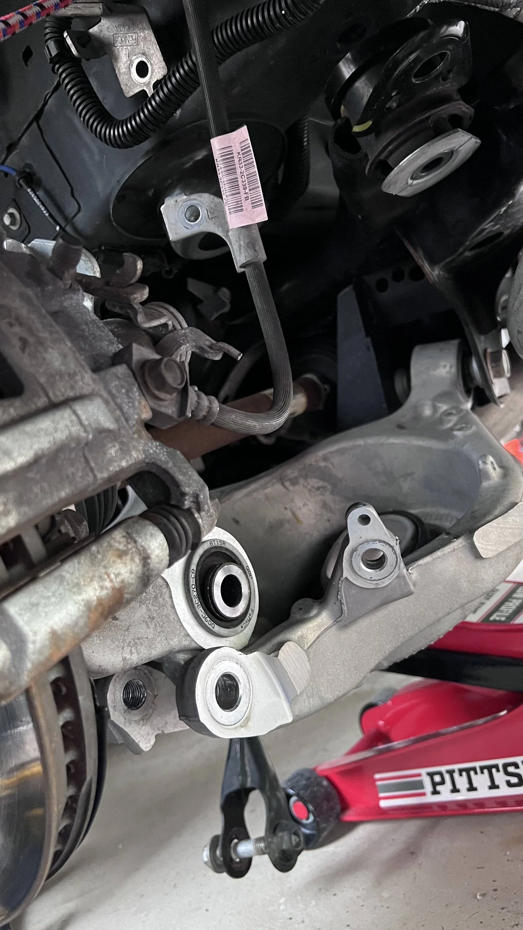

Hopefully these pics help someone avoid a headache in the future

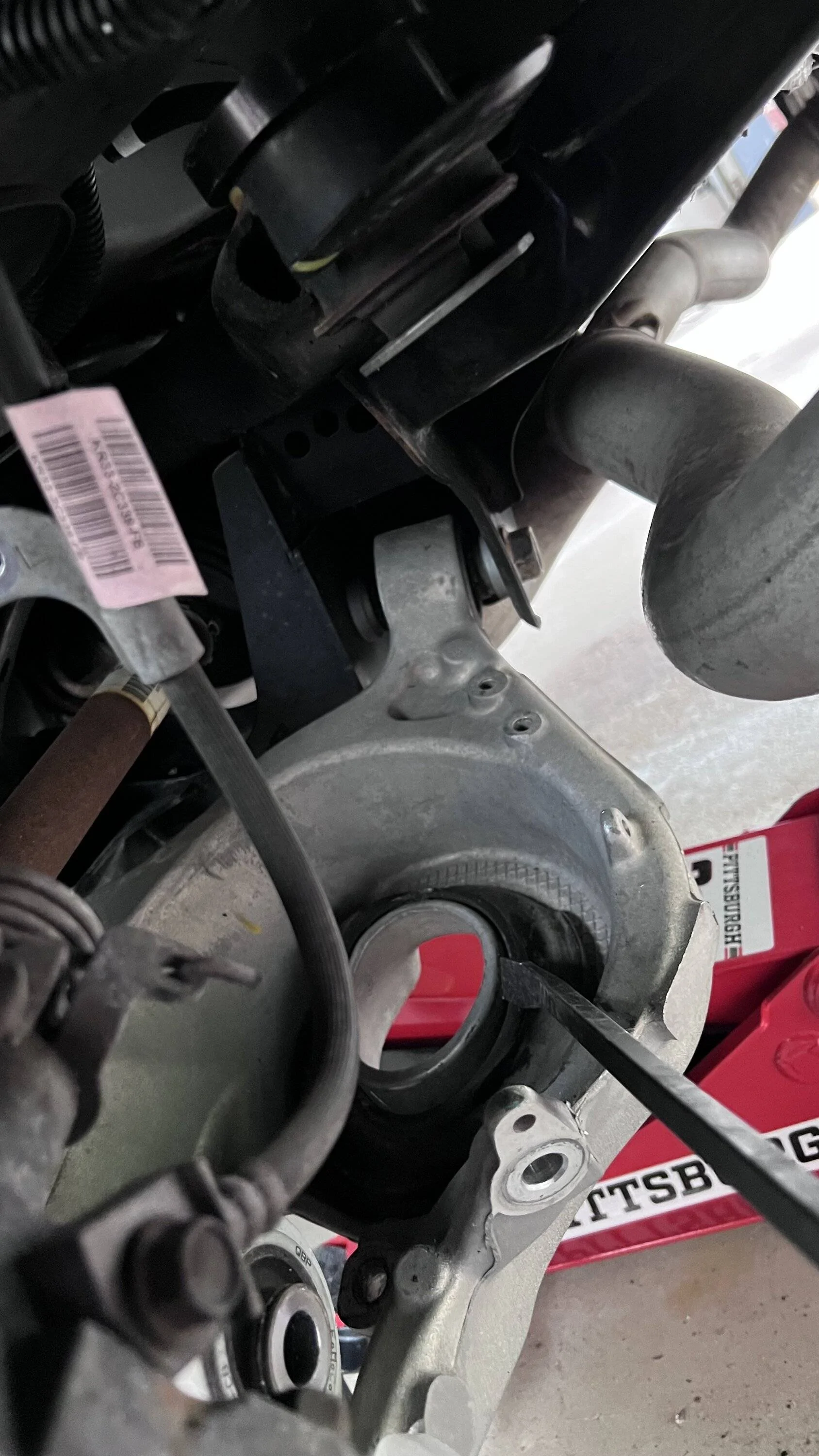

Anyone near oakbrook area that’s done rear spring install? I’m losing patience trying to get these OE springs out. šŸ˜‚
I have performed a few spring installs, the rear is easier than the front! I loosen subframe then remove the two bolts on the side I am replacing spring to allow access to remove spring. loosely bolt that side back in then move to other side and perform same routine. car on lift/jack stands and use jack to lower and raise subframe. be mindful of brake hoses.
oh no this is the your doing too much work route. I only remove front bracket and sub frame bolts, as well as top shock bolts that go into body. I believe I take off some brake hose bolts also so they stretch properly
edit: I believe I lower the exhaust in back also.
100% too much work. I tried everything that I found on videos and what I read here. This is all that worked for me. Oh well it’s done nowšŸ˜‚ just gotta torque some more bolts now it’s on the ground
lol, yeah that was a longer way. I can usually get the rear done at home in less than an hour. the fronts are more of a pain with the crap spring compressor I have at home. at least you got it going. I don't check this page a lot so unfortunately I didn't see your post earlier to give some pointers.
