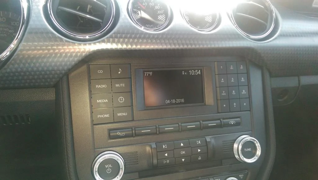

Also inside:
The PP cars have a unique simulated "brushed carbon fiber" dash trim that's just silver in non PP cars...it's the silvery piece that goes across the dash :cheers:
Here's a good picture of it:
Electronically, a PP car won't have boost available on the gauge menu (because there's already a boost gauge in the center console).
