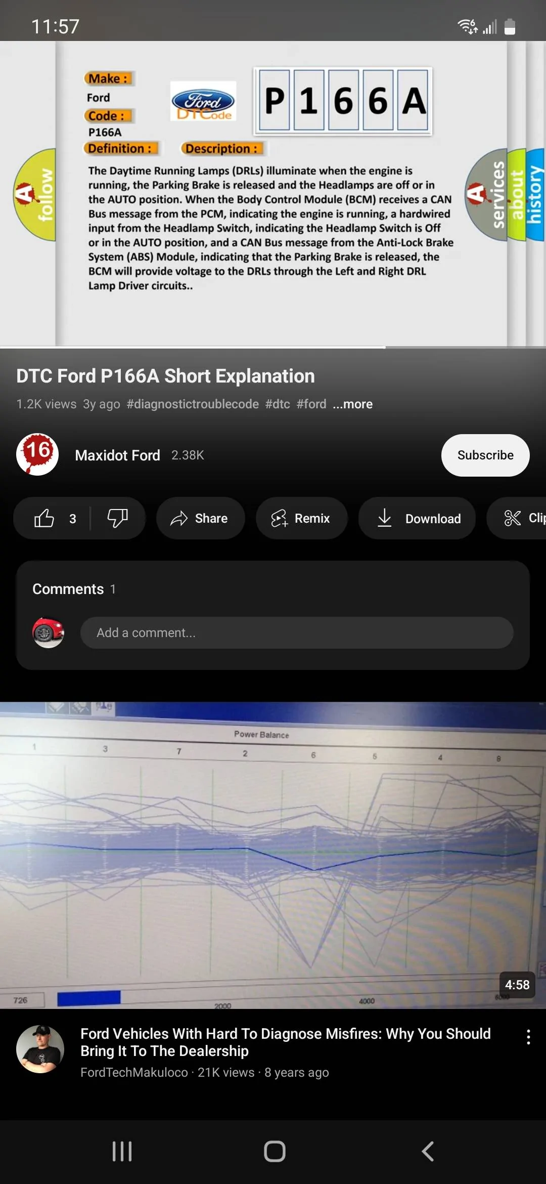

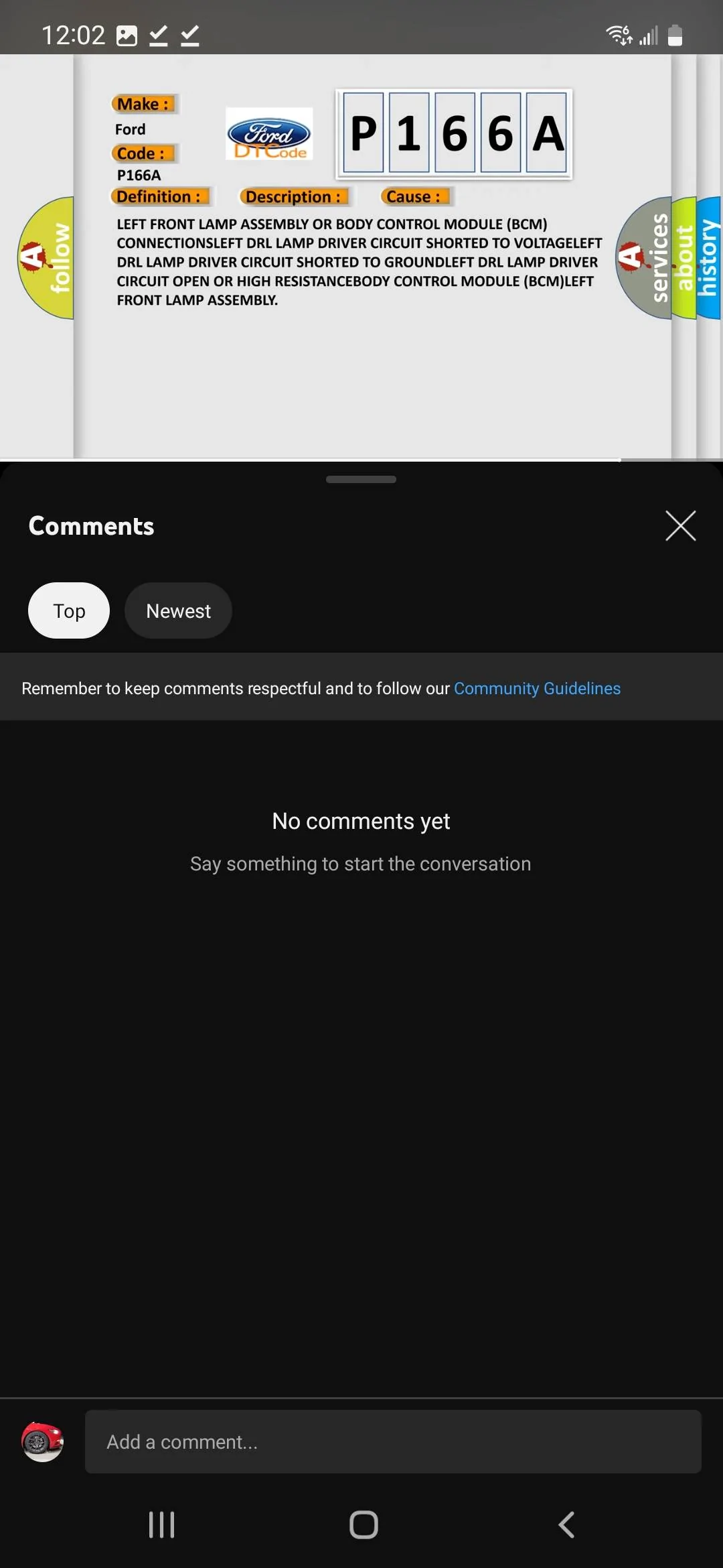

Here is another option.
|Code P166A Ford Tech Notes
Some 2013 Fusion and MKZ vehicles may exhibit an illuminated wrench light with DTC P166A stored in the Powertrain Control Module (PCM), or the memory seat recall function may be inoperative during passive entry. Reprogram the Body Control Module (BCM) to the latest calibration
Not sure if this video is even close but anything is worth a try. At the end it mentions airbag reset

Have you checked for a water leak in your floors? Ecu could have moisture in it.
thanks Donnie, I’ve had a look at all the modules and no sign of moisture anywhere :(
Apart from the occasional wash it lives inside and doesn’t get used in all weathers so that was always a long shot unfortunately, I had to check though.
Airbag module shows no faults but I’ll certainly give it a go :thumbsup:
