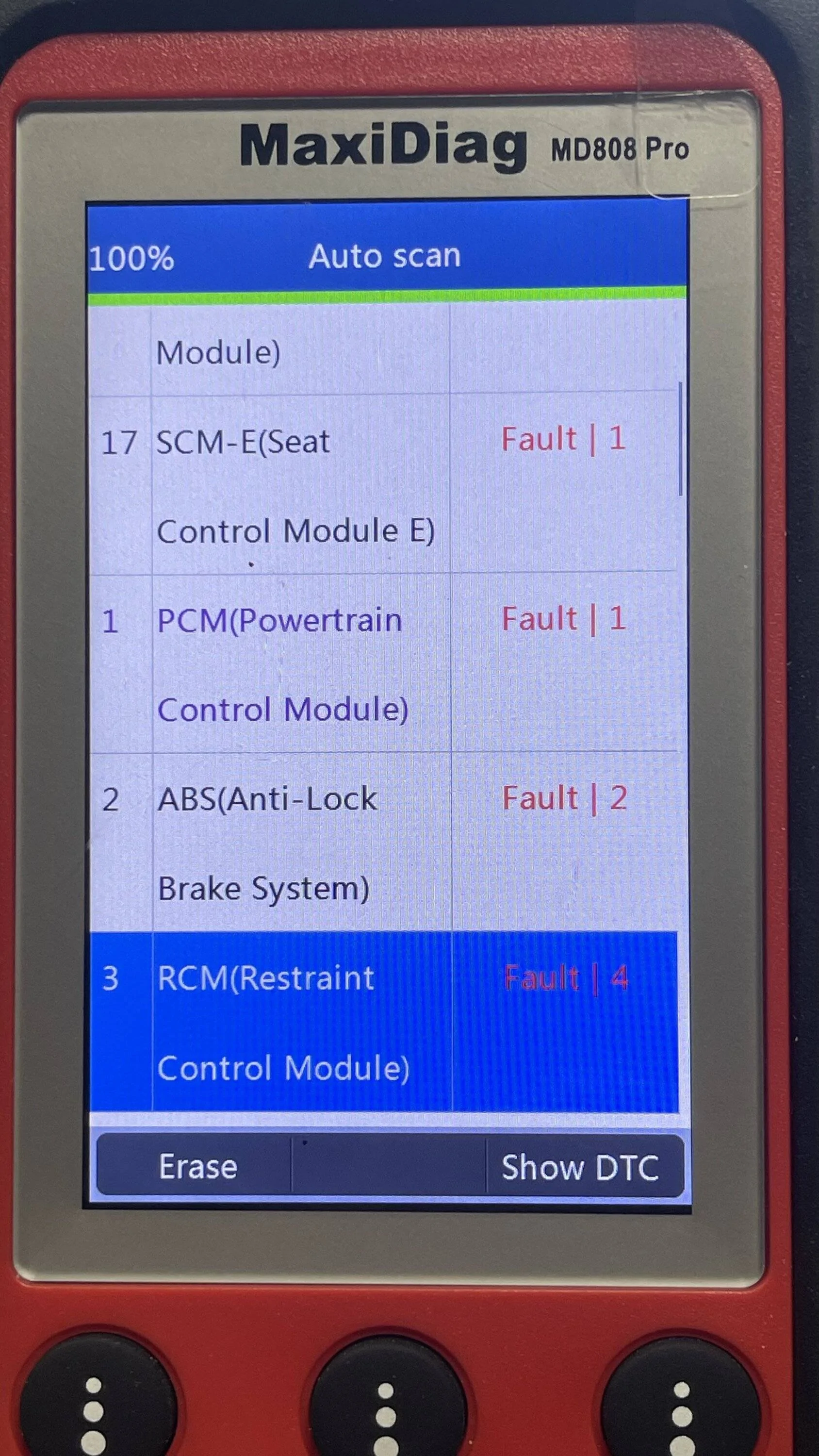

Hi,
I have a 2017 built GT, I was out yesterday for a run with other cars, pretty hot day but I was keeping an eye on temps and saw nothing I was concerned about.
At the 1st stop, my reverse camera stopped working which may or may not be connected.
On leaving the stop the car travelled about 500yrds and cut out, I managed to pull it into a car park to stay out of the way. The Wrench sign was on the dash and it turned over but wouldn’t start. Leaving it 2 mins it started 1st time and I drove off, the car then cut out twice more in a short distance.

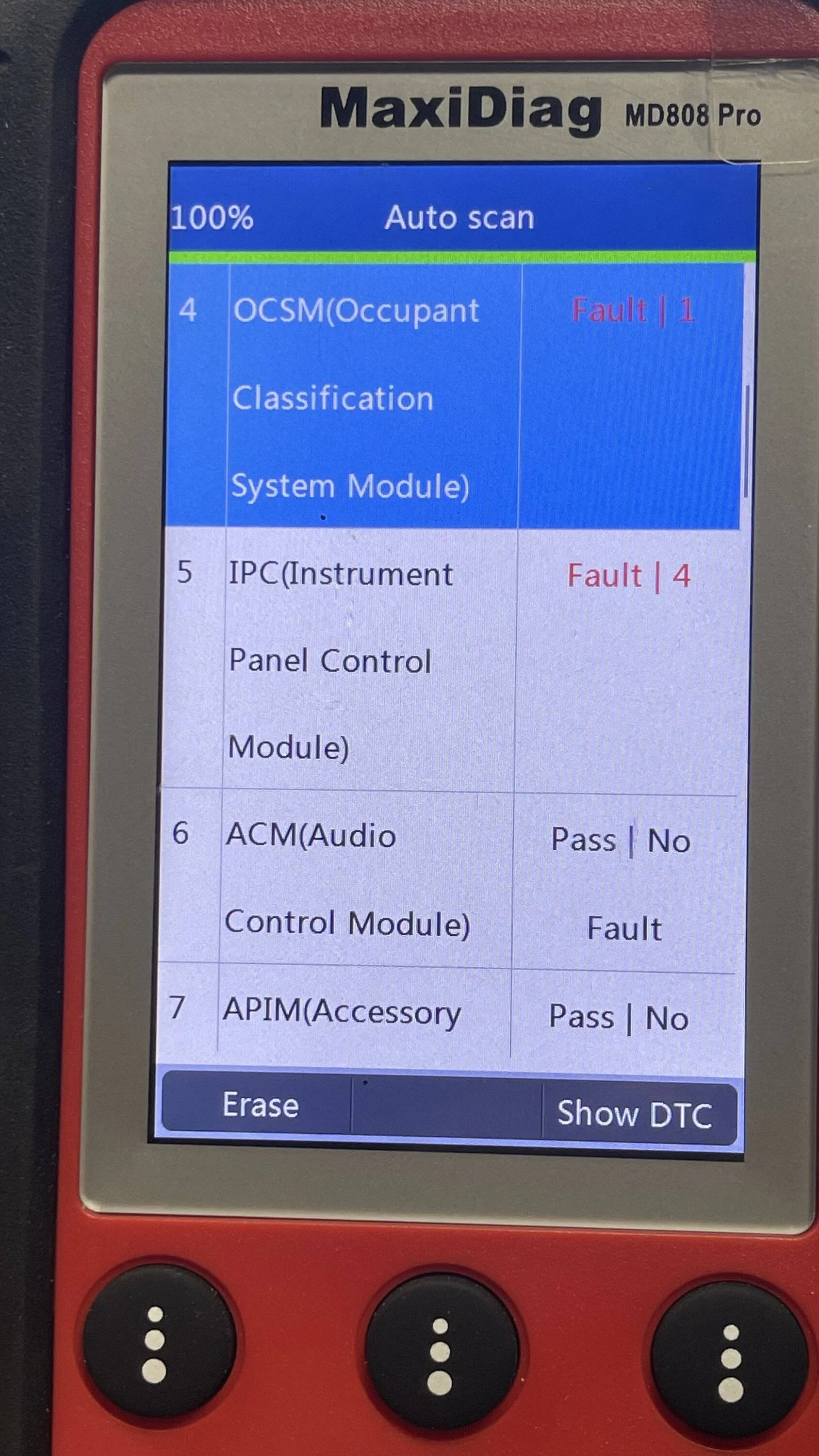

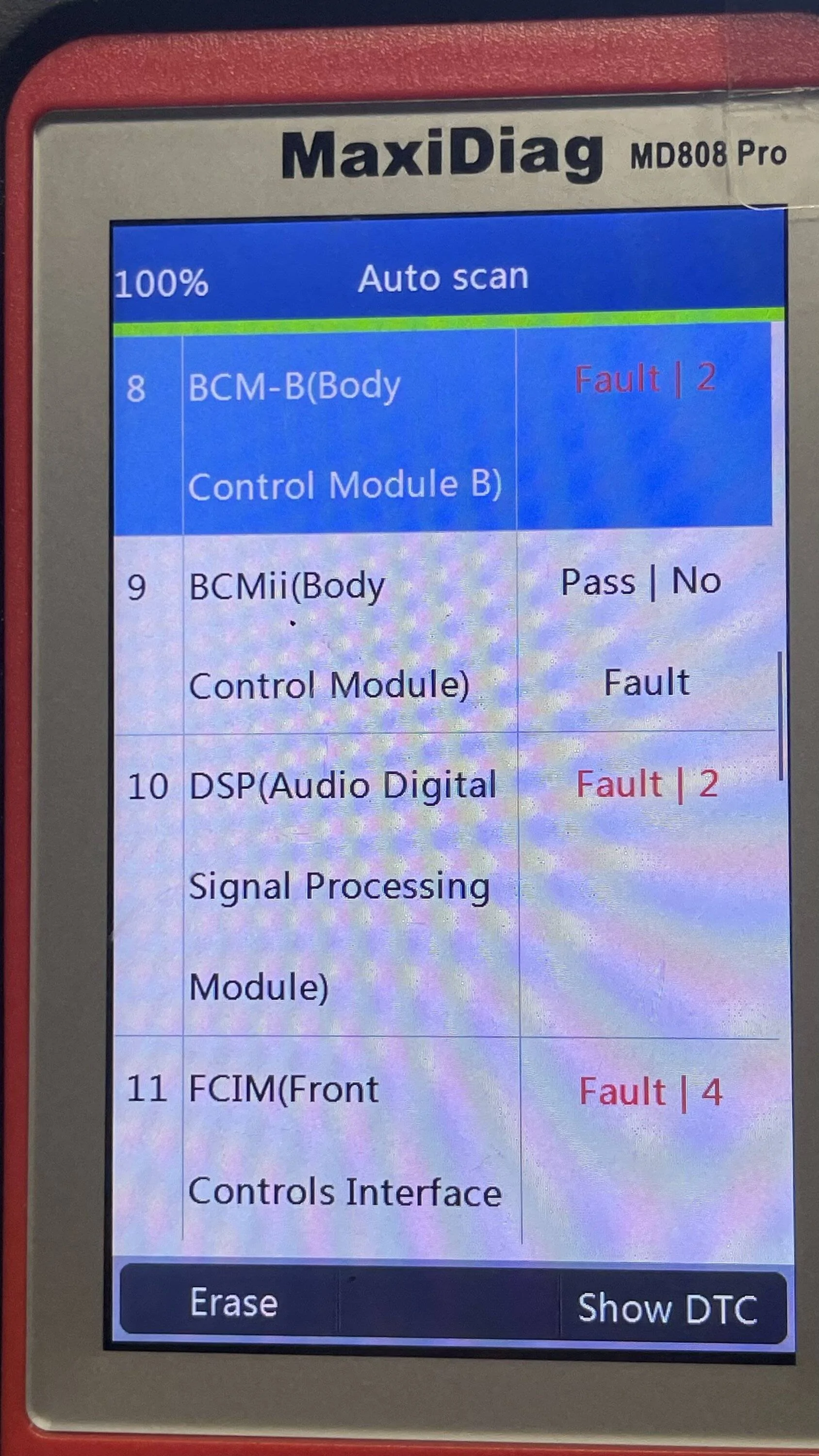

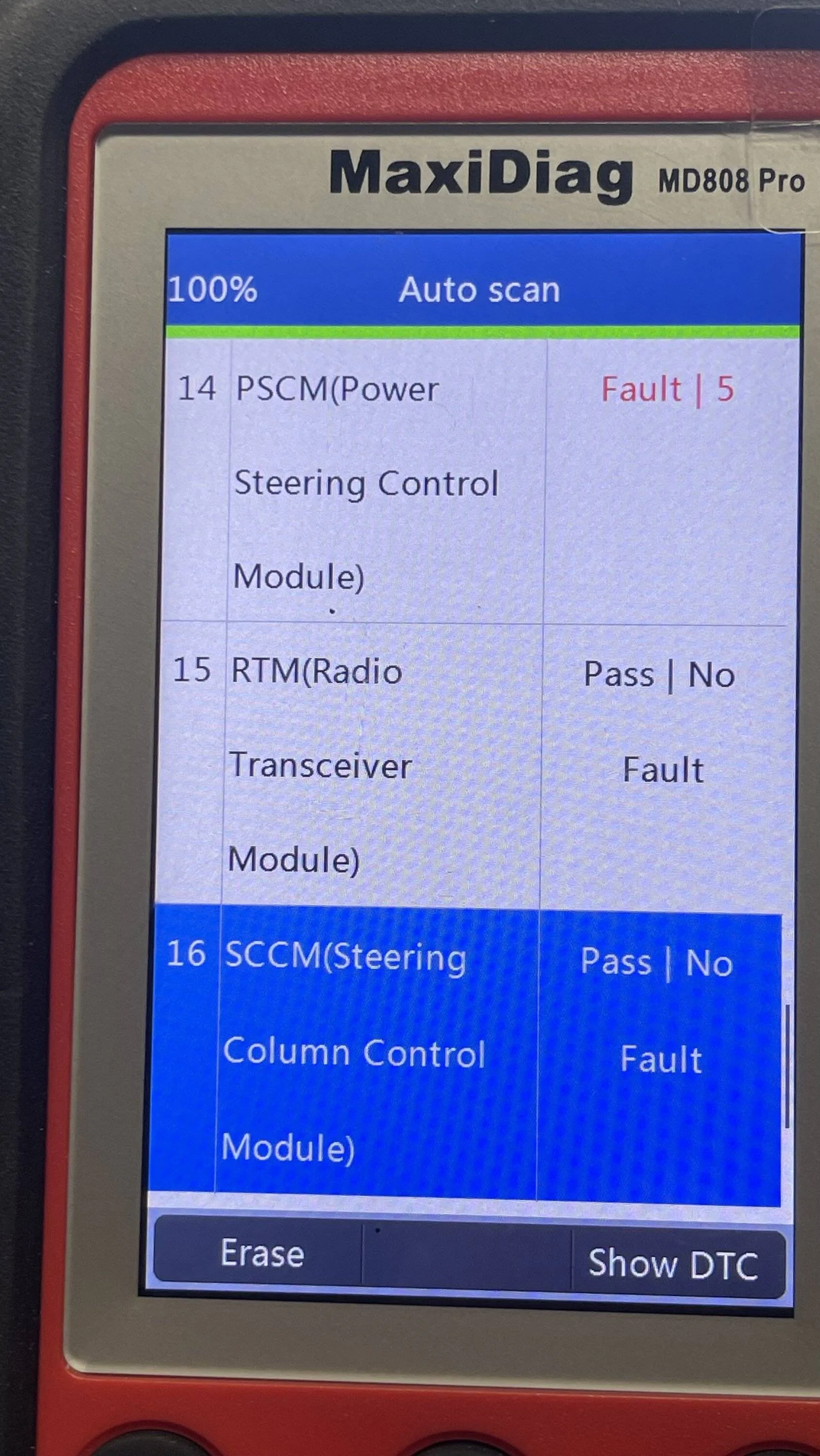

The faults below I had to clear to drive the thing home, still showing the wrench and not feeling heathy.
All but the PCM fault would clear, going into that one I’m left with these……

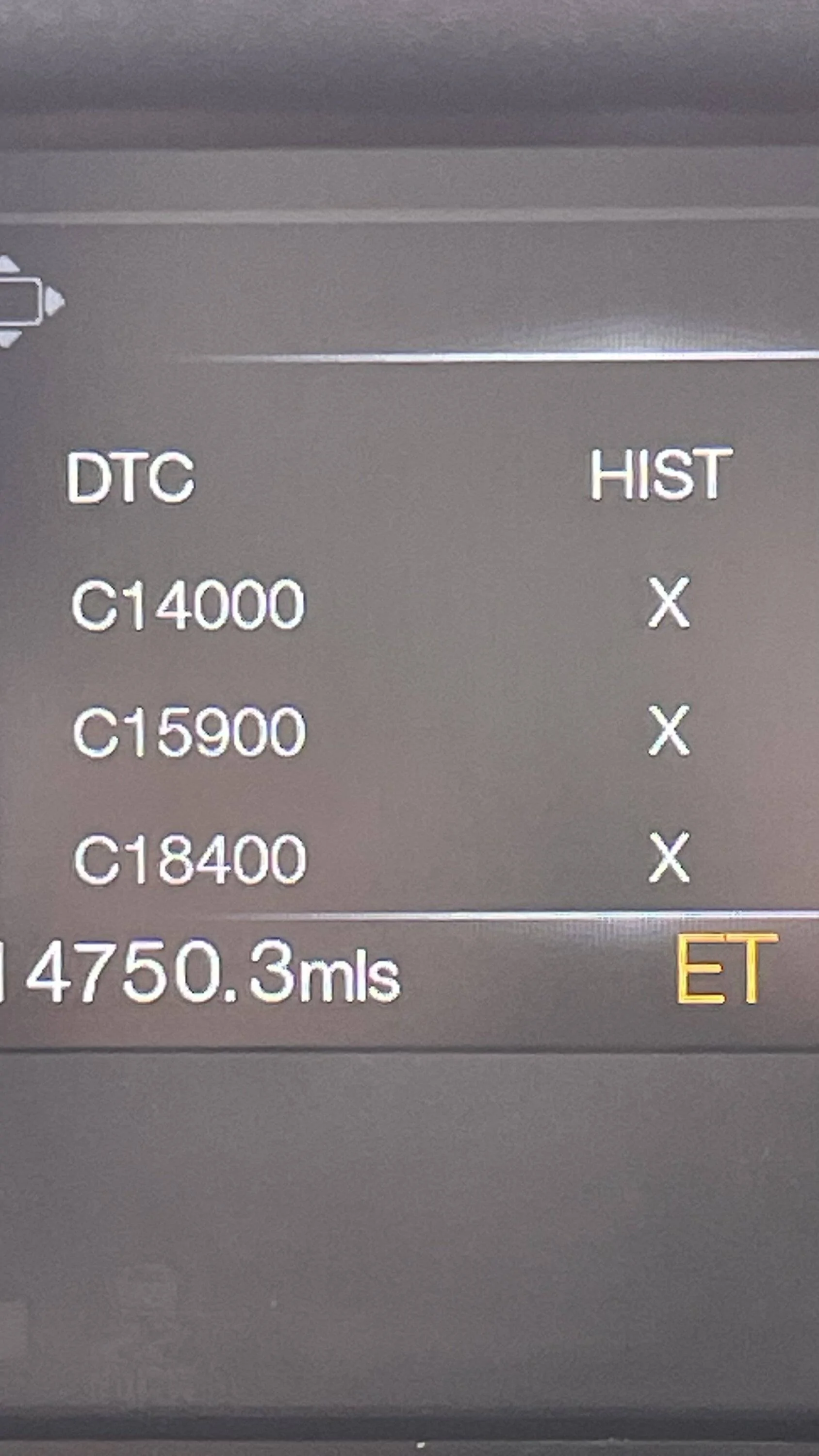

ET mode is showing these
Car is recently tuned and a cat back.
My local dealer is a horror so I feel very much on my own with this, any insight or experience really appreciated.
Thanks :(

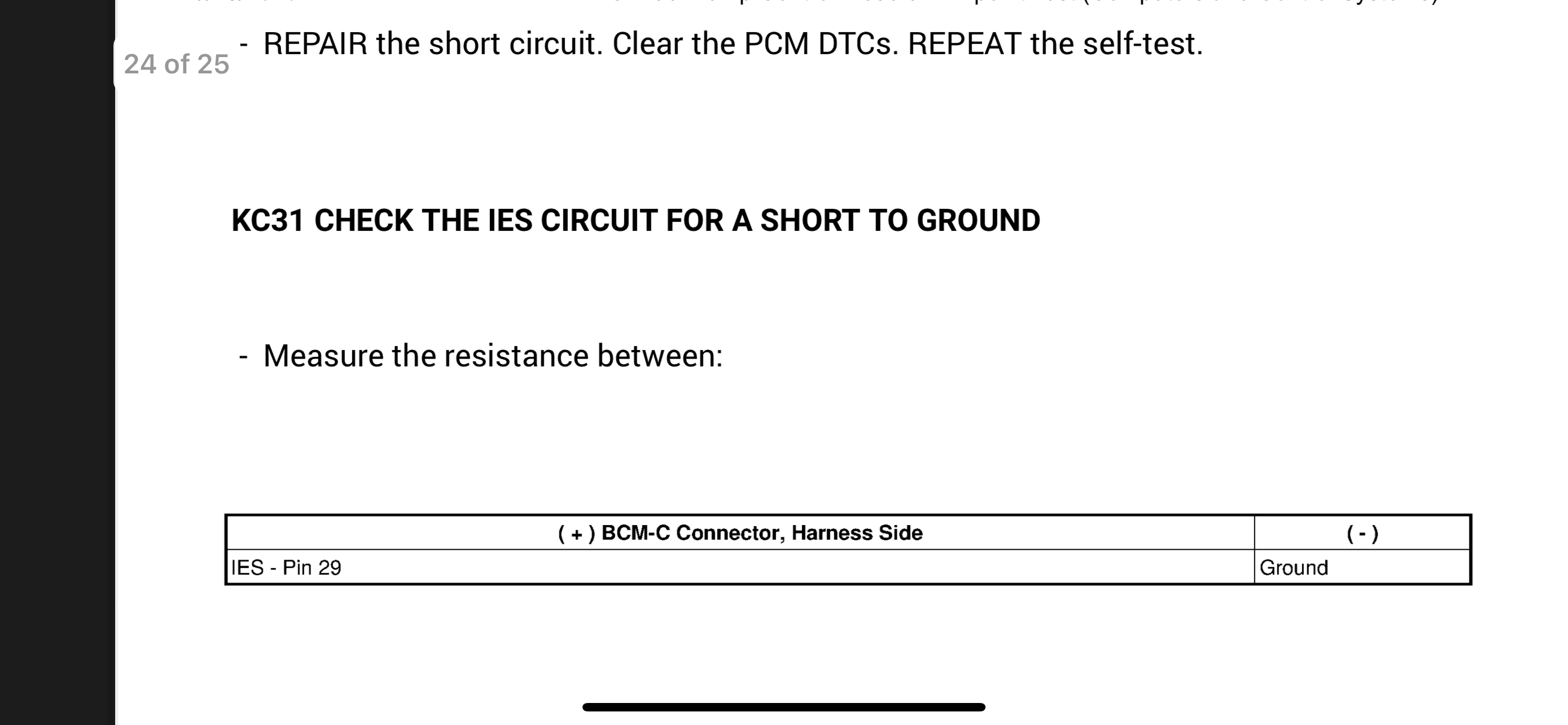

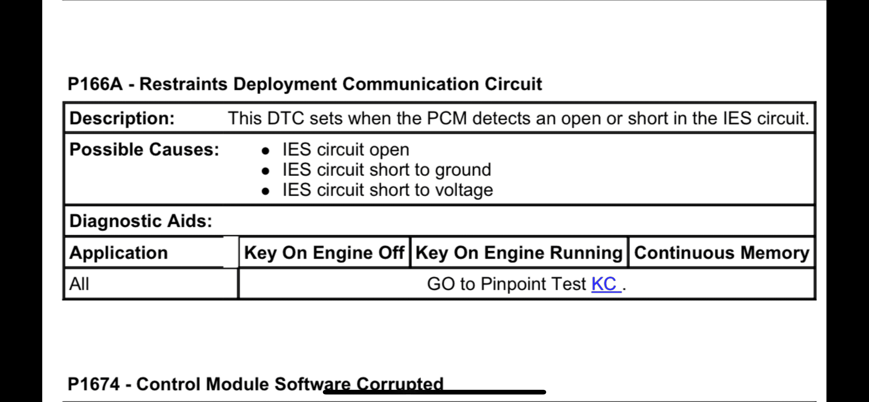

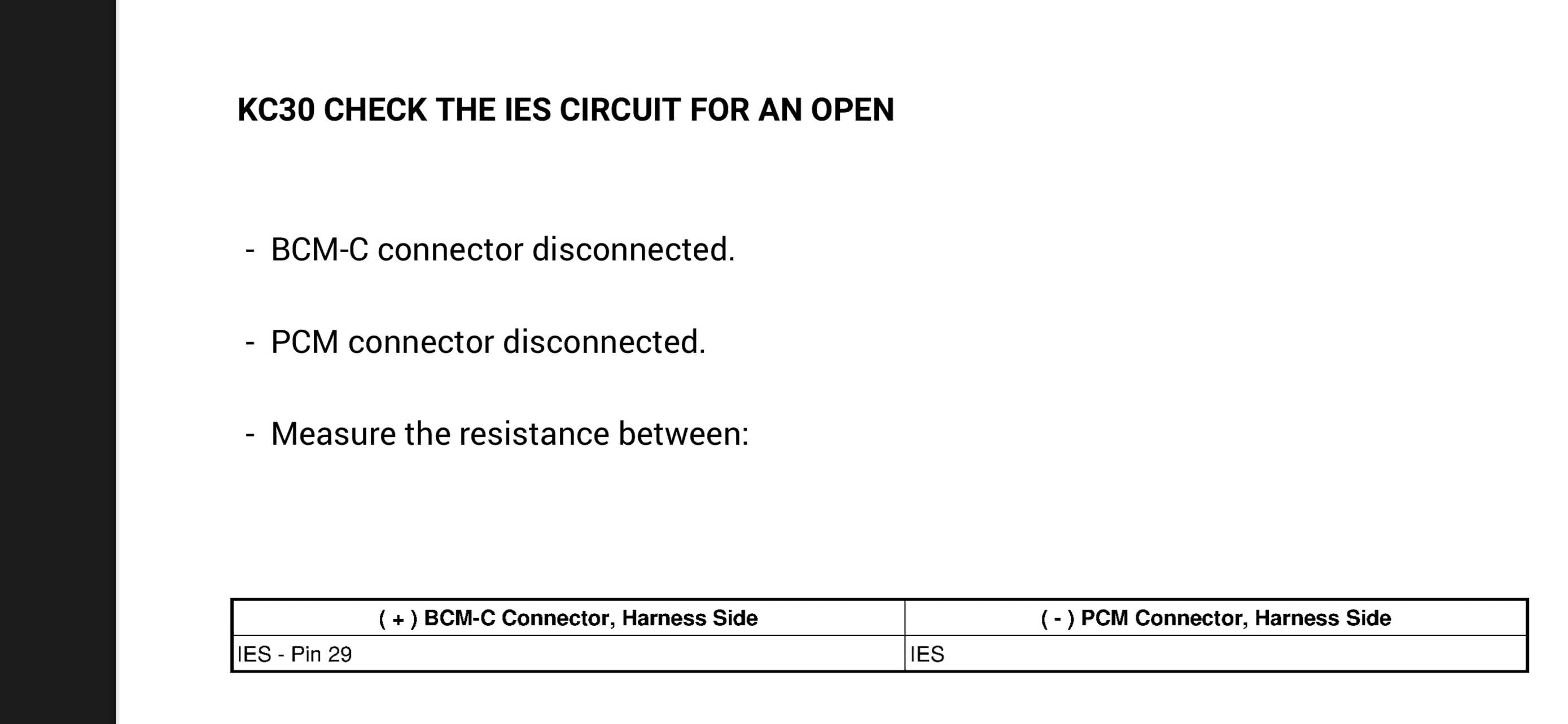

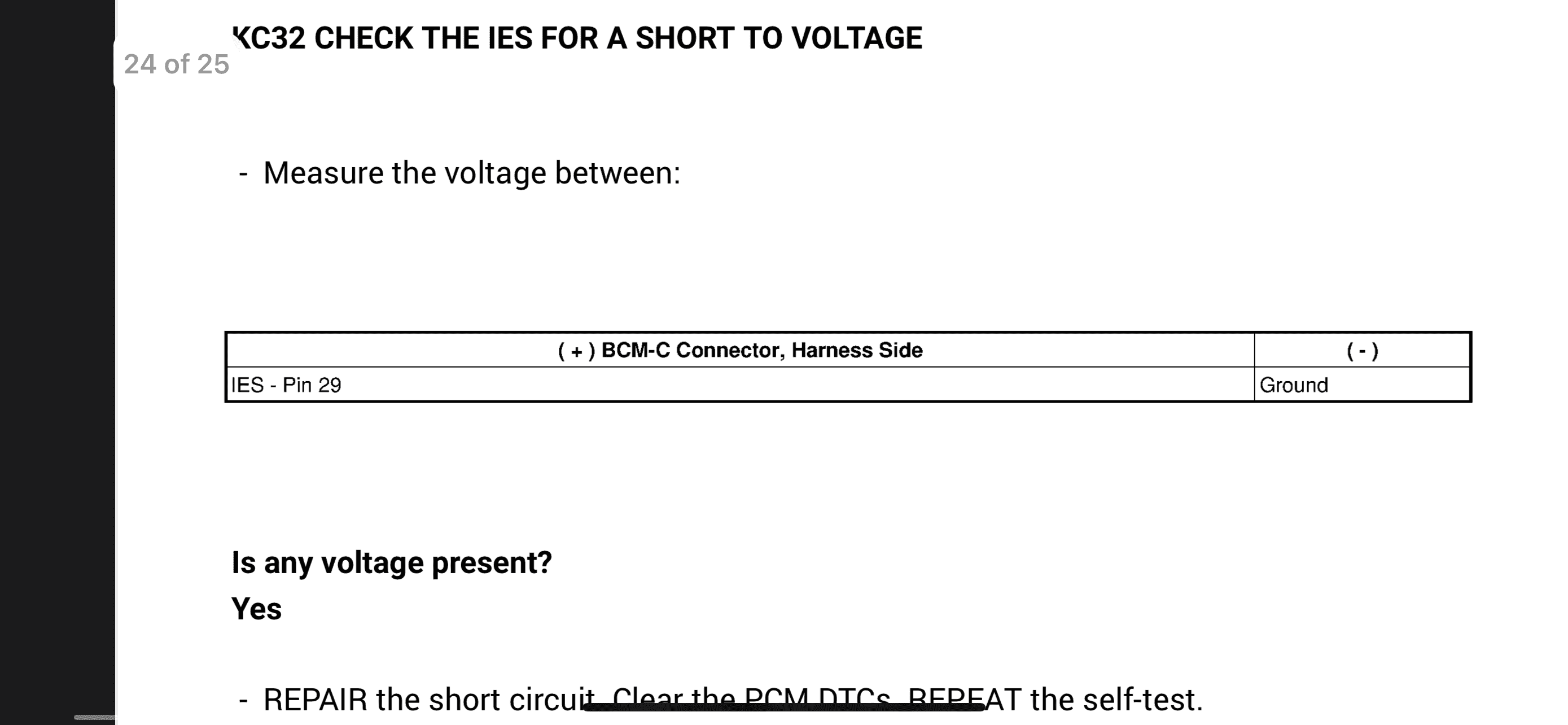

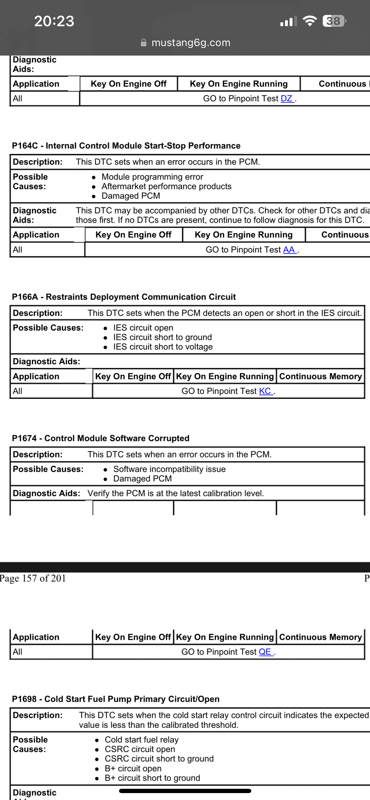

From the manual it says IES circuit, anyone know where I’d start checking plugs and wires for this if it’s not voltage releated?

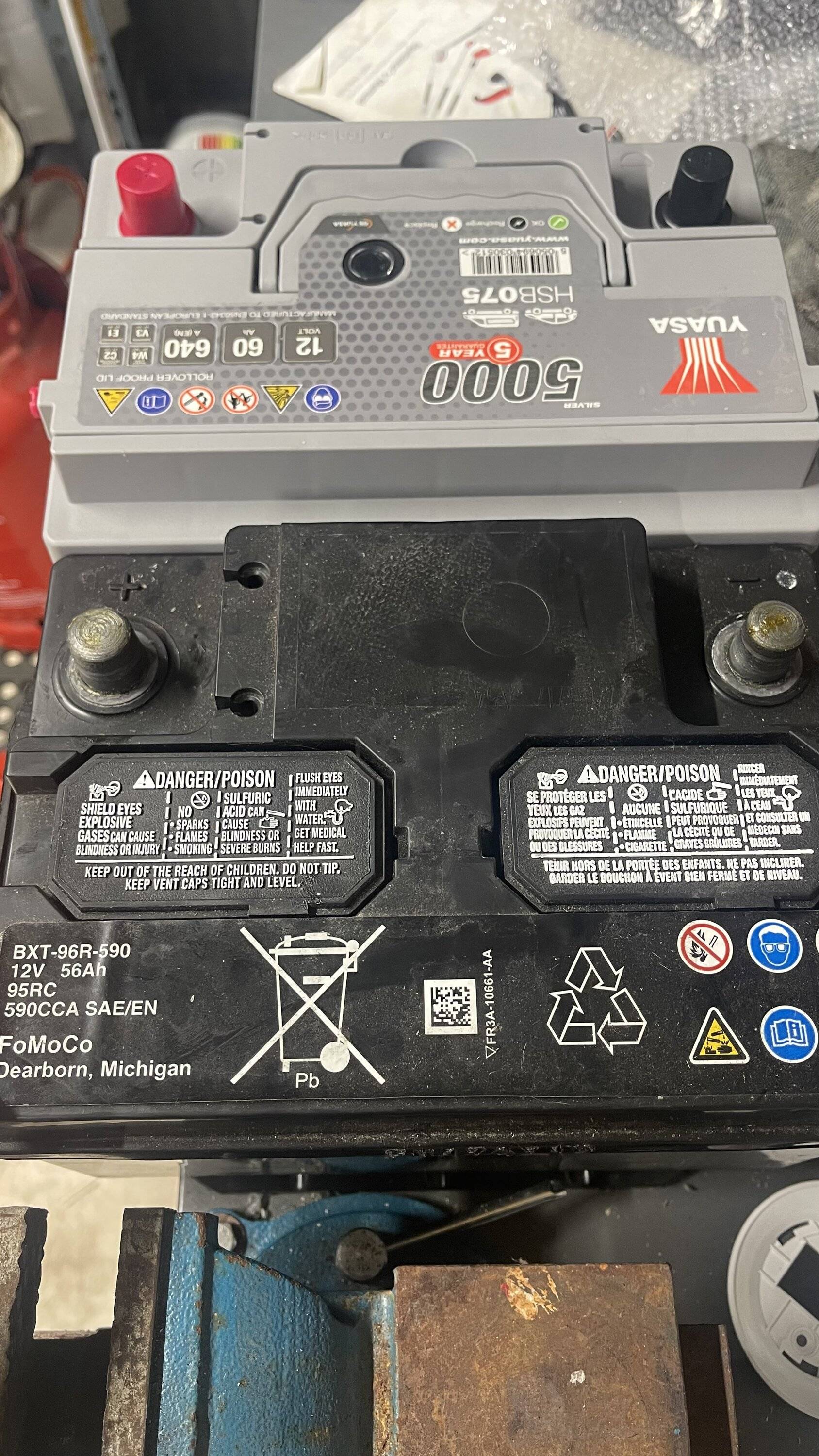

Definitely the original battery, new one on Charge to make sure it’s 100%
Standard cranking amps are 590, this one is 640, hopefully I’ve not made a mistake knowing how fickle these things can be

I didn’t test it, as it was the original I thought I’d just change it to future proof it, thanks for the BMS info!
Good luck hope it is all taken care of with the battery! fwiw i believe if the vehicle experiences anything below 10.5 volts the electronics(automotive 12v land) goes nuts and stuff acts however it feels like acting with no rhyme or reason!
Cranking shouldnt dip below 10v and charging should be above 13.6v. This car charges the battery whenever it feels like thanks to the Battery Monitoring Sensor located on the battery cables connector. Any of those values are great baselines for most vehicles.

I have the same C18400 code in my car in engineering mode. As best I have found on other threads, that code is simply a code that makes sure certain programming is in the car, and the code itself is used for tracking the programming.

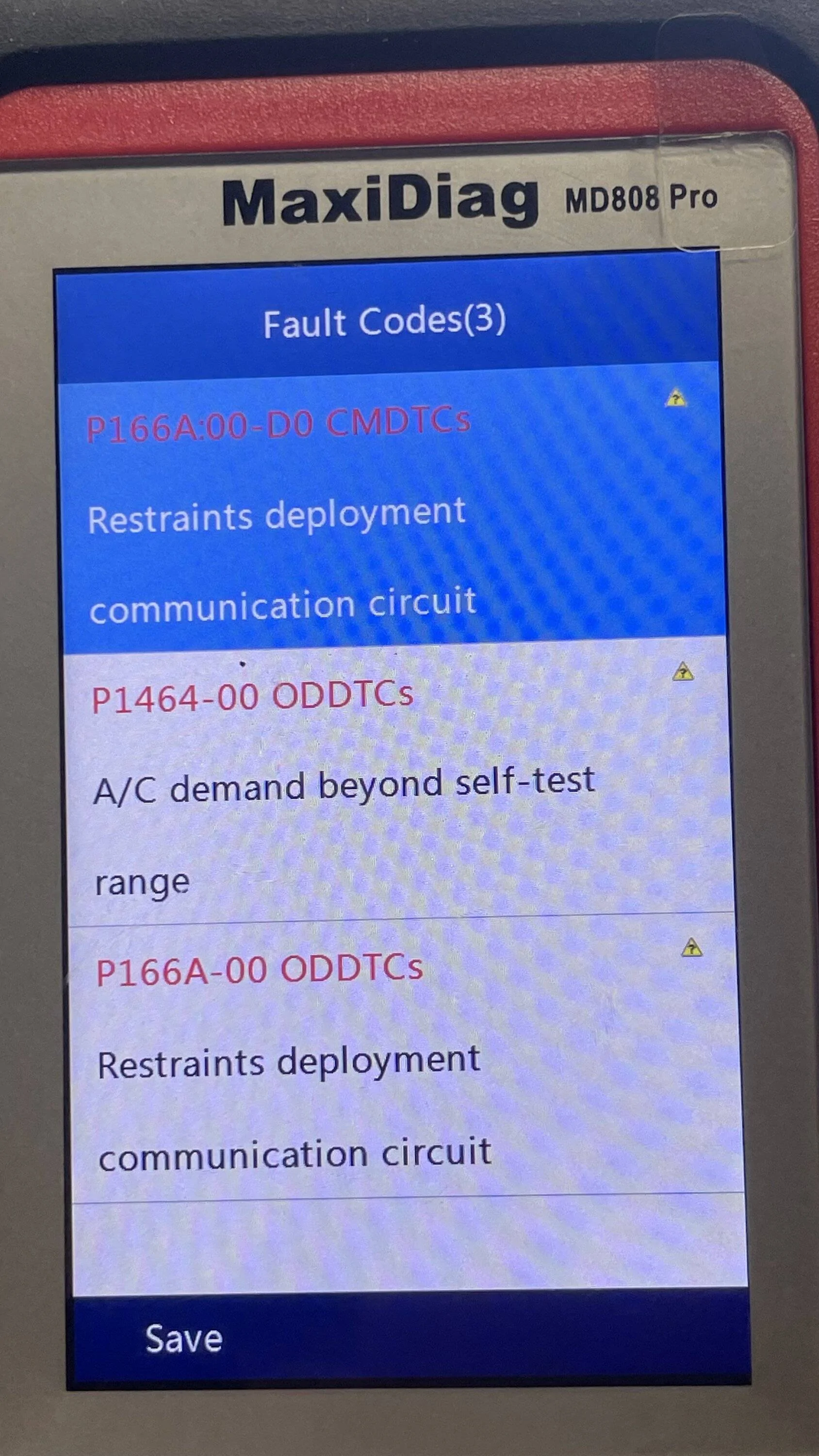

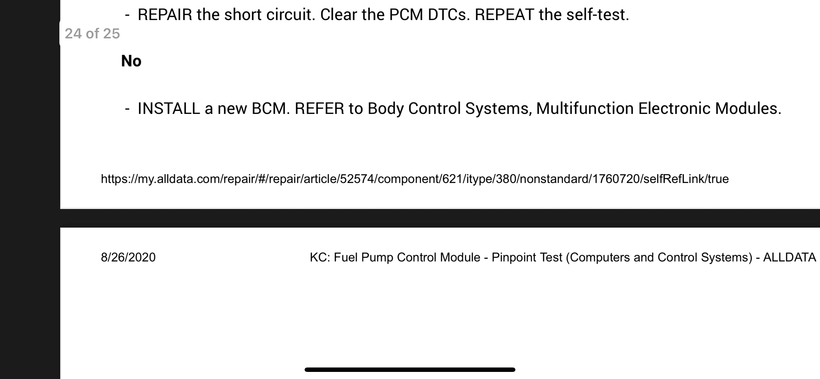

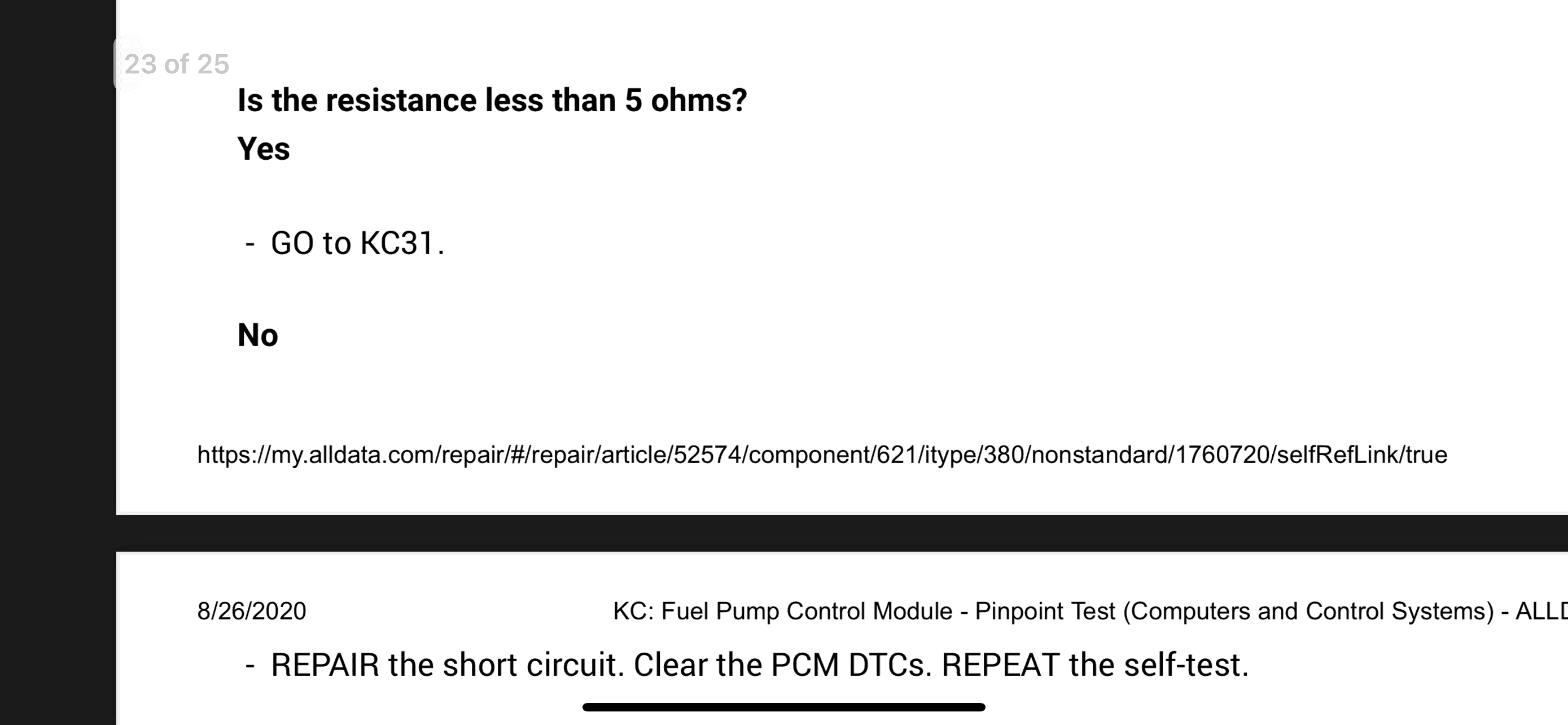

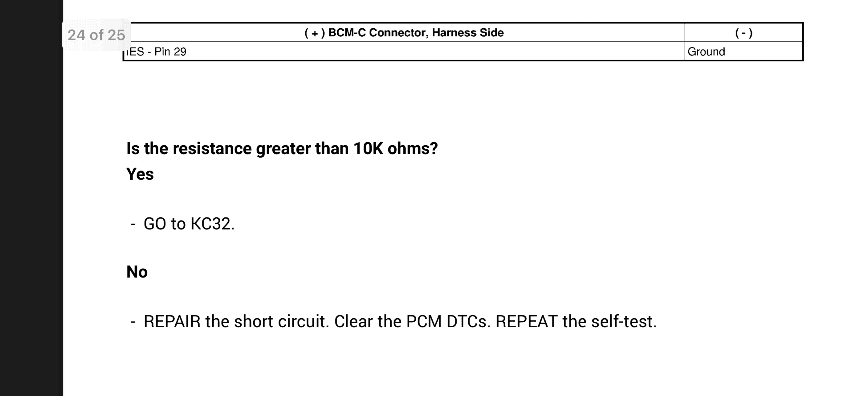

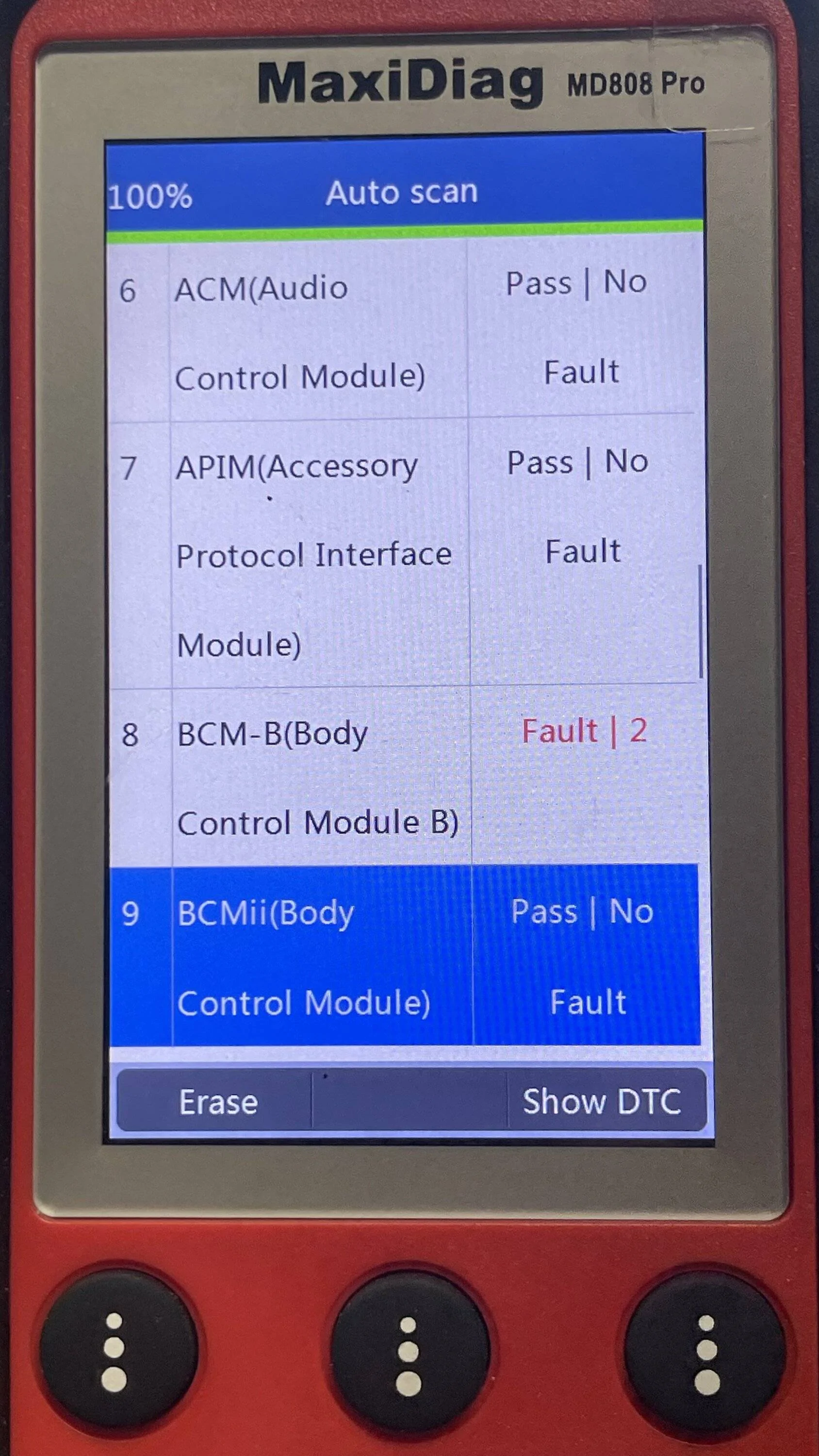

Ok, some further digging points to a short circuit, anyone help me pinpoint the modules listed? I get the feeling I’m stripping my interior out lol :brokenheart:
BCM-C and PCM
I have a feeling this is moisture releated in the BCM in the footwell 🤔

"Recently Tuned". As for a fresh tune, and re-import it.
That doesn't work, start checking grounds. For example, the passenger side strut tower grounds (there are two) are known to not be good connections. Sand the paint off, down to the metal. Clean and reconnect.
