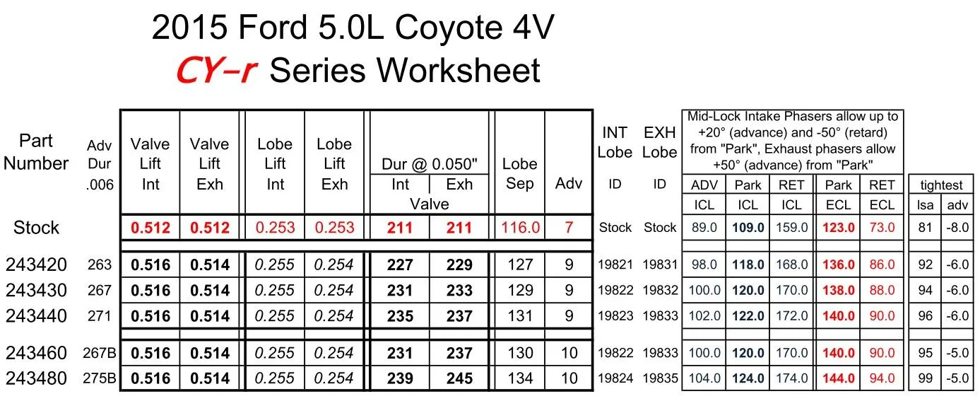

Here's the stock cam (red) specs:

I'll take that as a "no". Overlap is what causes the lope. Exhaust gas is drawn back into the cylinder during the beginning of the intake stroke because exhaust pressure>intake pressure and the overlap means both are open to the cylinder. The exhaust dilutes the air charge and causes a weak or mis-fire. Every so-many cycles, enough exhaust finally gets purged out and you get a clean fire. This mis-fire/clean firing alternating is what causes the lope.
And all the "instructions" in post #18 are incorrect.
