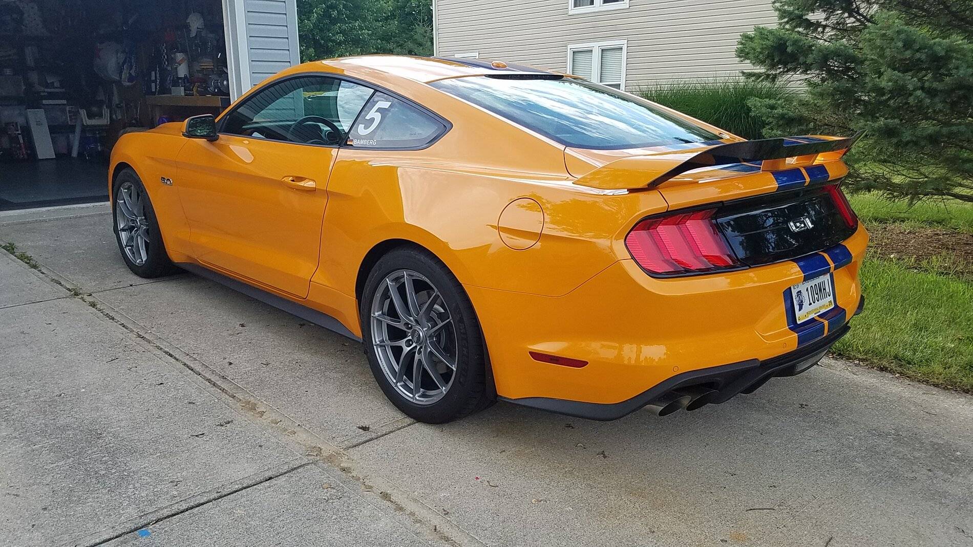

My car has quite a lot of clear film and full ceramic coated. So it is easy to clean either for street or track. And great protection for both too.
I left it out in a brief rain shower, wiped off all the track grime, then followed that up with waterless wash. Wheels also were cleaned with waterless wash.
