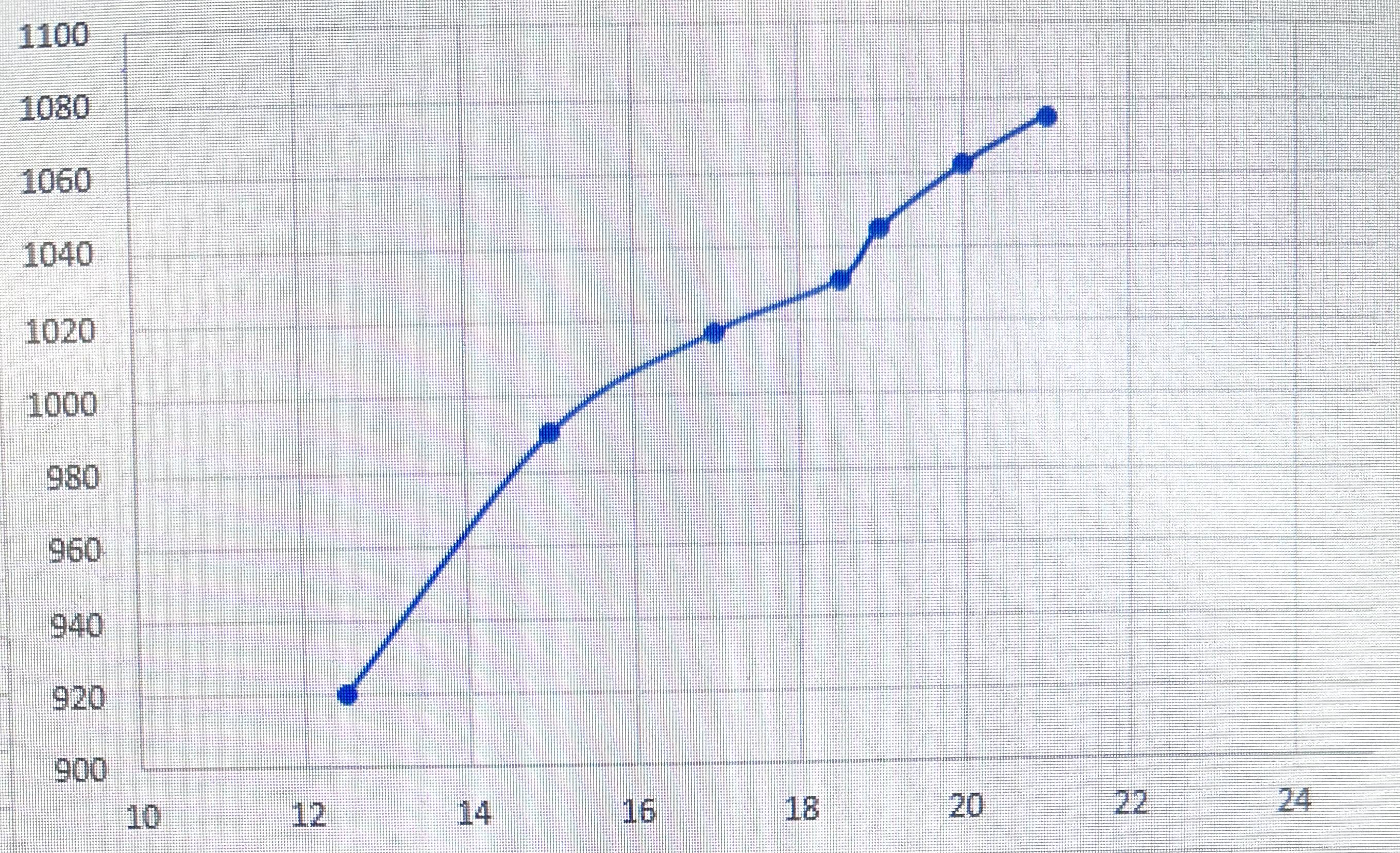

engineermike
Jul 15, 2018
6,249
6,558
La
2018 GTPP A10
Typically 20 hp per degree, but is more when further from mbt and diminishes to nothing as you approach mbt. I have a really good table showing this but it was done at 9.5/1.
