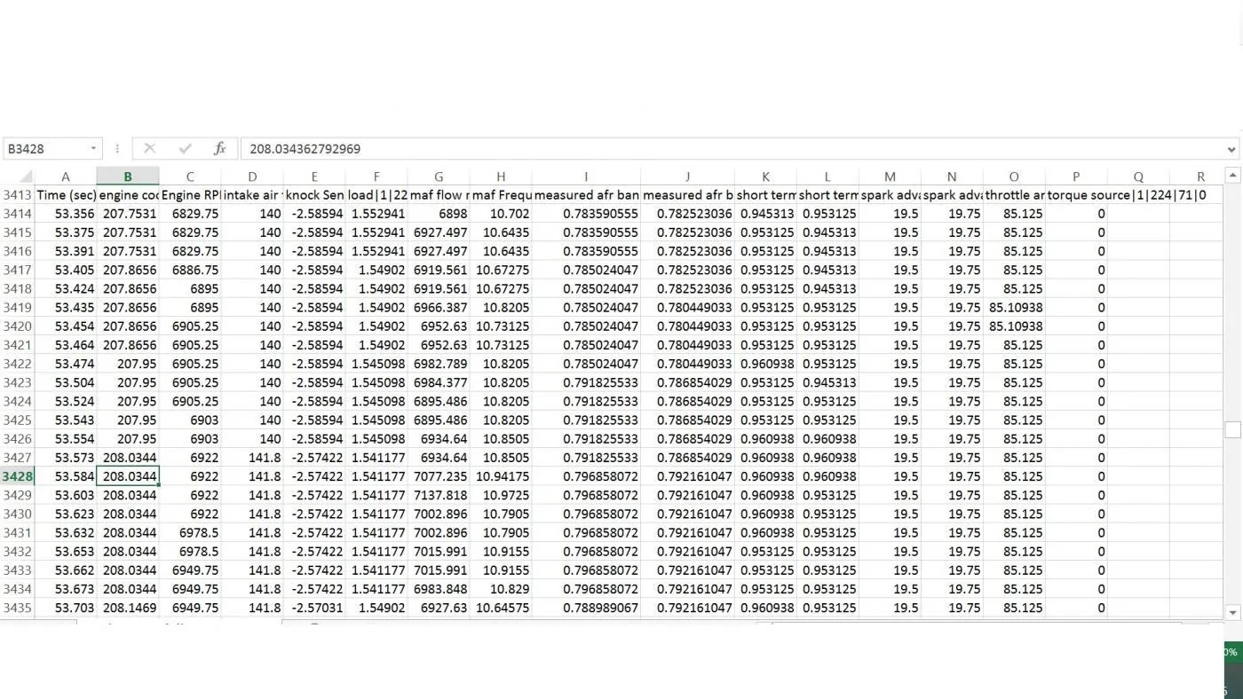

Bro, let me put it this way. I have seen a supercharger manufactures logs. Their calibration on 93 oct ramps up to 20 degrees. They offer warranty..... And it isn't Roush. If you haven't heard, roush's tune sucks. I have more than 40 logs on my 93 tune. No issues at all and even in 95 degree weather.
Ok, LOL just don't come crying if shit happens. Anything over 18 degrees on pump gas at that boost level and you are asking for trouble. I've personally have seen motor scatter at that timing On stock internals and similar boost. But what do i know.

Clearly not much, sorry. I'd suggest staying NA. Anytime you add FI to a car thst was built to be NA, you are reducing the life of the engine regardless of how much timing you are running. The majority of engines that let go are tuned by shit tuners. I have now had 3 tuners for my car. A local, Lund and Ken B. Ken's is by far makes the modt power, the smoothest and has never knocked. He also requested the most logs. Ken had me log 7 3rd pulls and revised the tune each time making slight changes. Then when he was happy, had me do another log. If it wasn't safe then he would have backed off, it is his reputation. And if you haven't noticed, he is always busy. Not only that, as said before, there is a large supercharger manufacturer that their calibration will ramp up to 20 degrees on 93oct; I have seen the logs. They have thousands of hours of R&D and work with Ford. I have yet to see any of there calibrations pop engines. This isn't my first rodeo. The key is going with a great tuner with that particular car. I use to drive my STIs 8 hours one way to Doug Wilkins at top speed just for tuning. For my EVOs, I would go to Orlando and have John Jestr tune them. In 12 years the only engine that I have had to explode was due to a local tuner in Jacksonville.

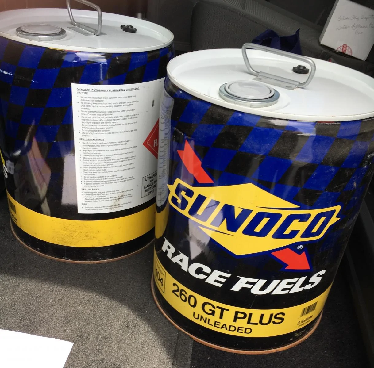

14-15 psi boost. I'm going to increase timing another 2* on the Sunoco 260 GT Plus:
