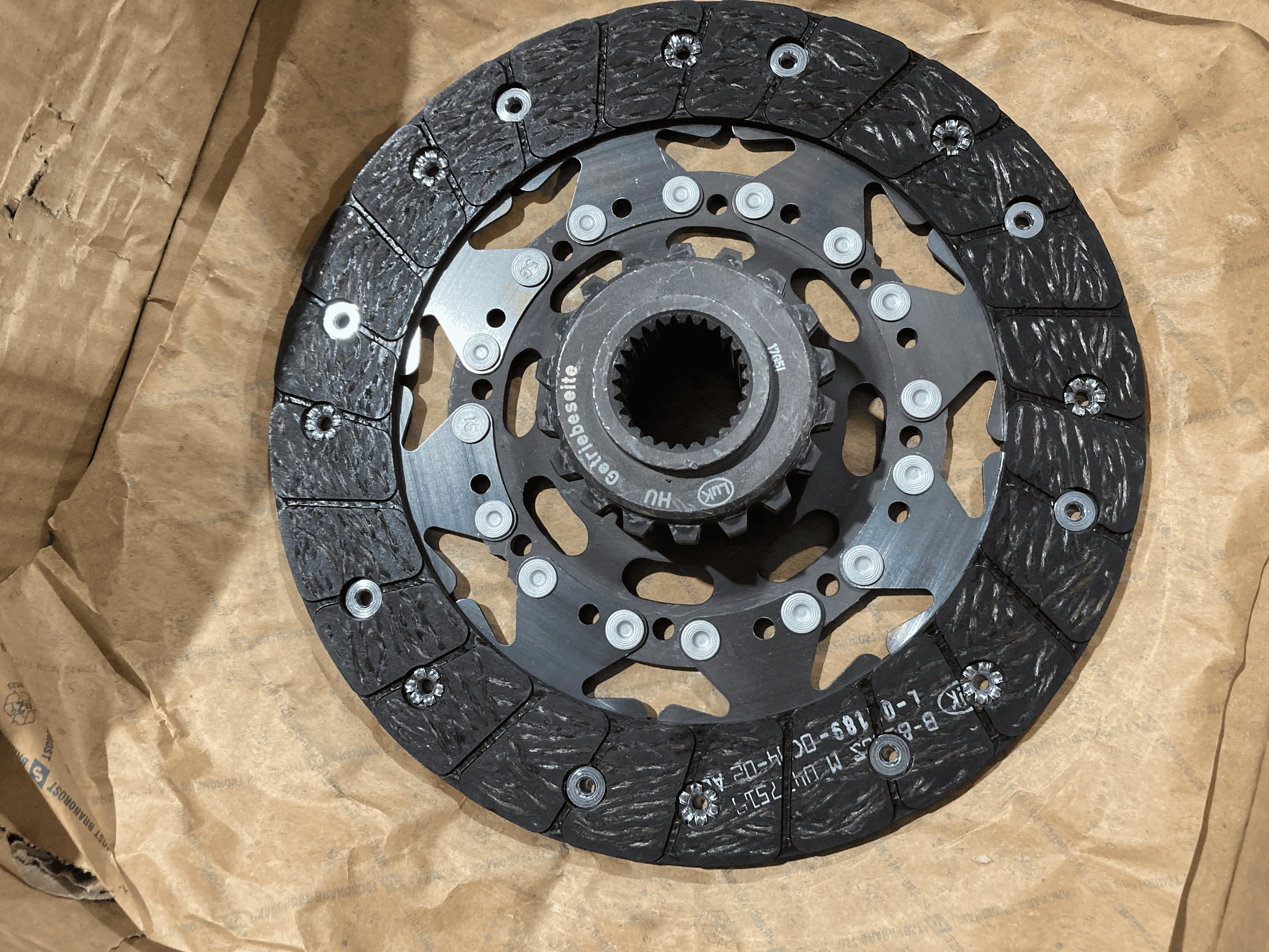

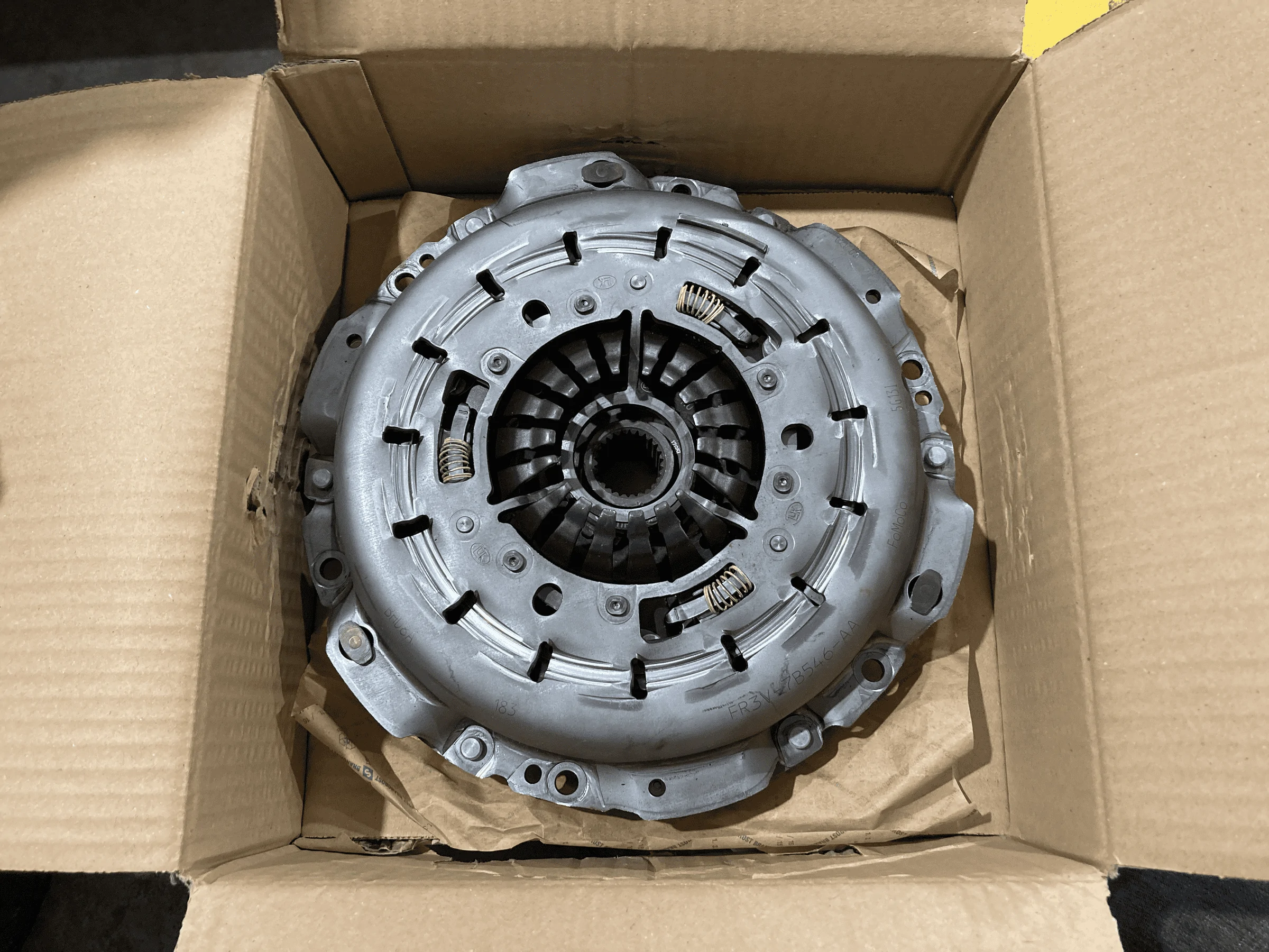

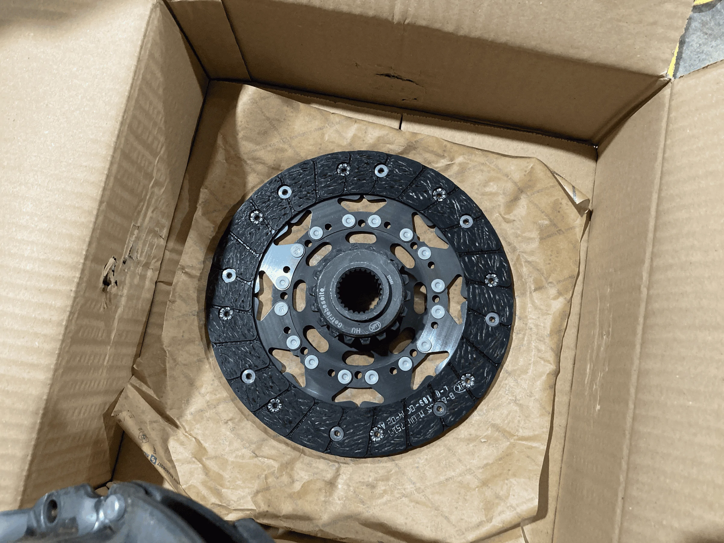

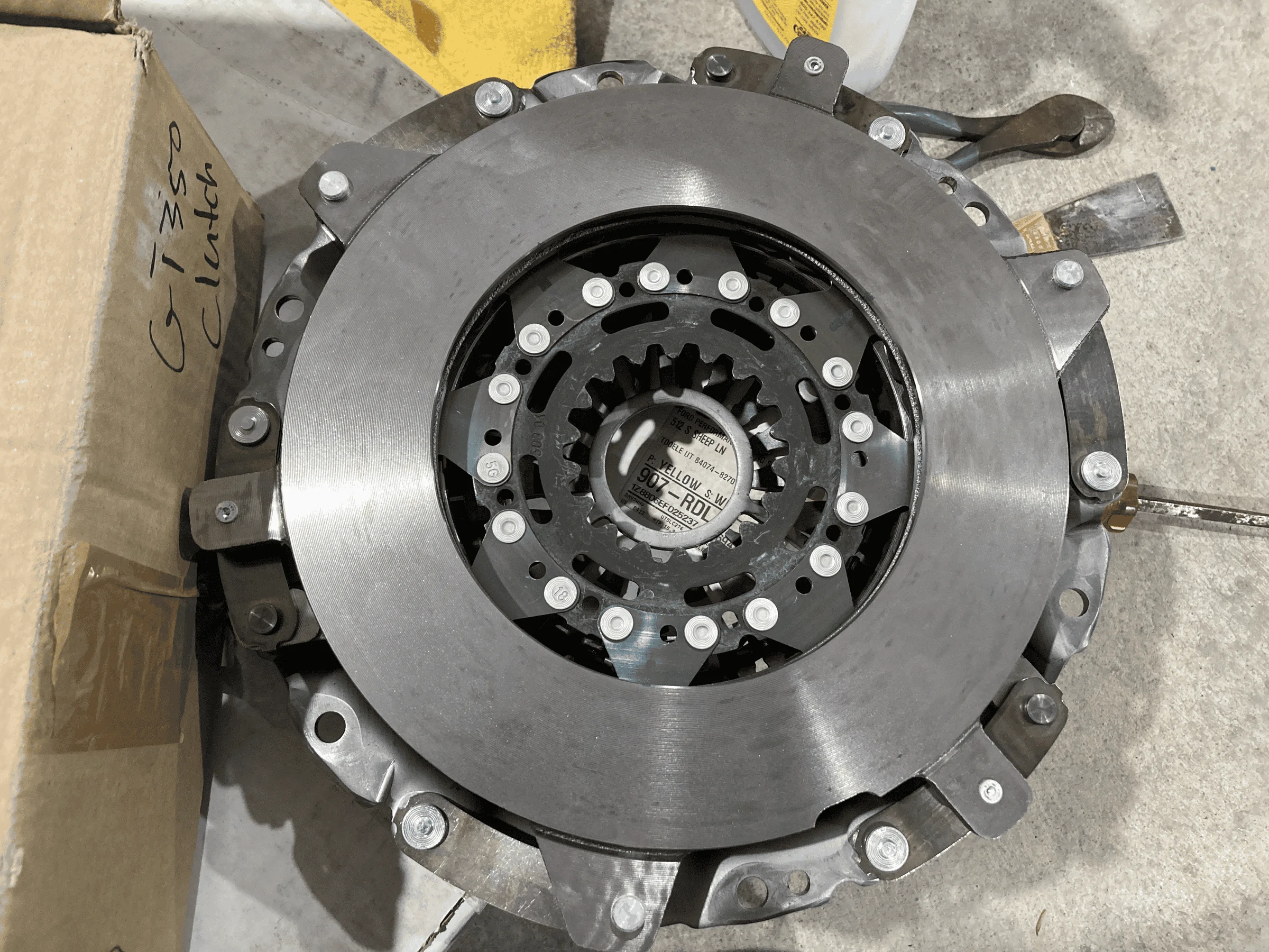

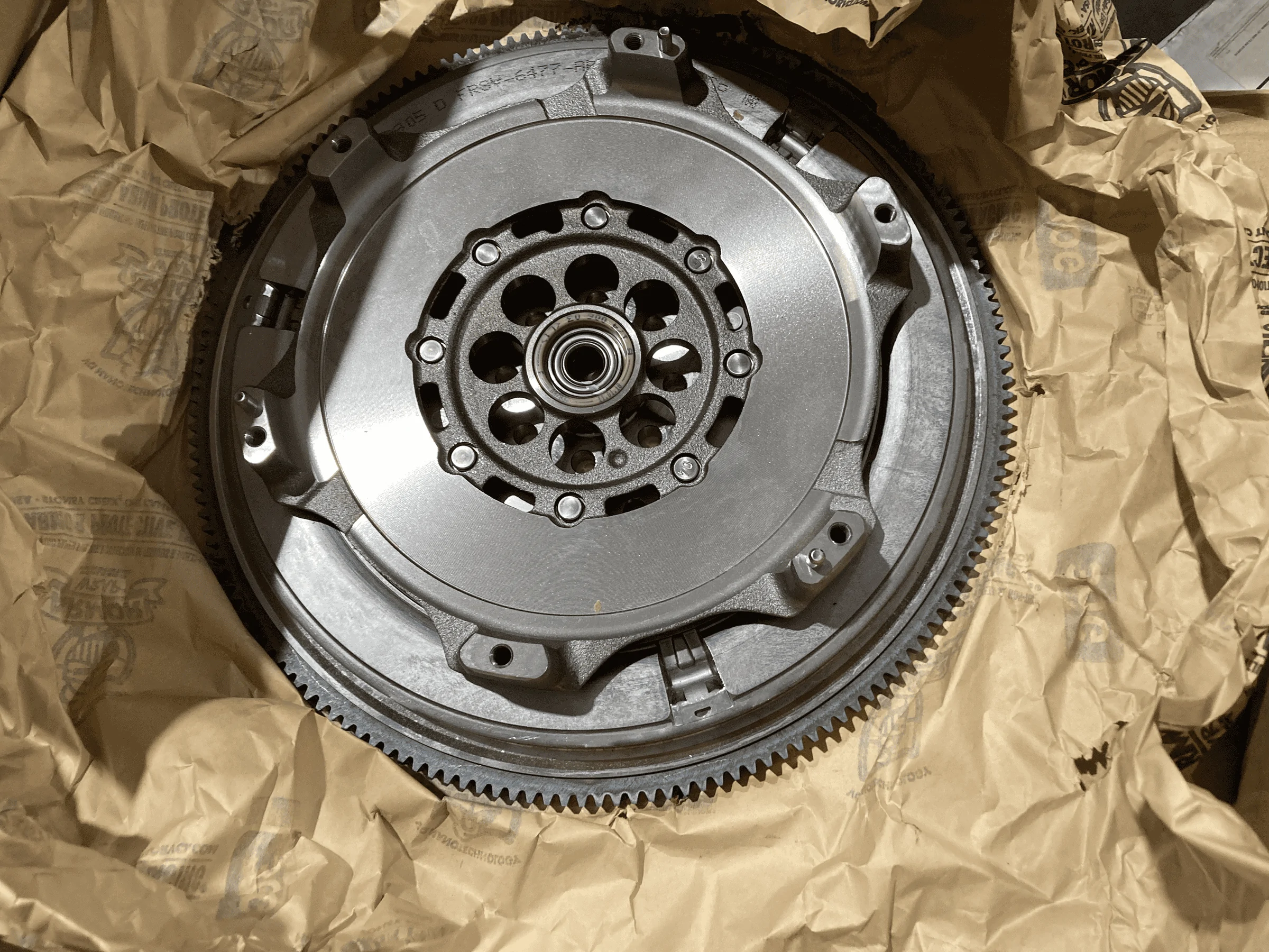

Since we were talking about flywheels and clutches I took a couple of pictures.
