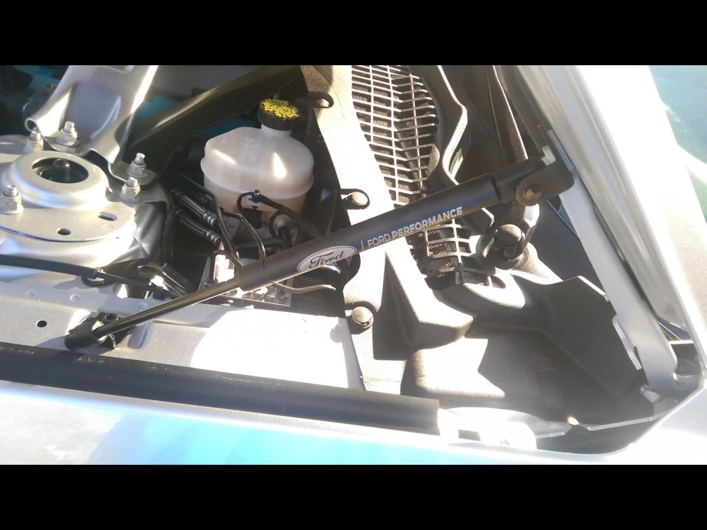

What struts don't require drilling/modification? I know the Ford ones do.
The MRT don't require any drilling or modification at alll. The Ford Performance looks to be the Redline which require drilling the battery cover
Todd15Fastback
Dec 10, 2013
80
10,523
3,883
Atlanta, GA
Todd
2015 Mustang GT PP Fastback
The Ford Performance have been confirmed not to be the Redline and rebranded.
Only have to drill the battery cover which is very easy. I like these a lot.

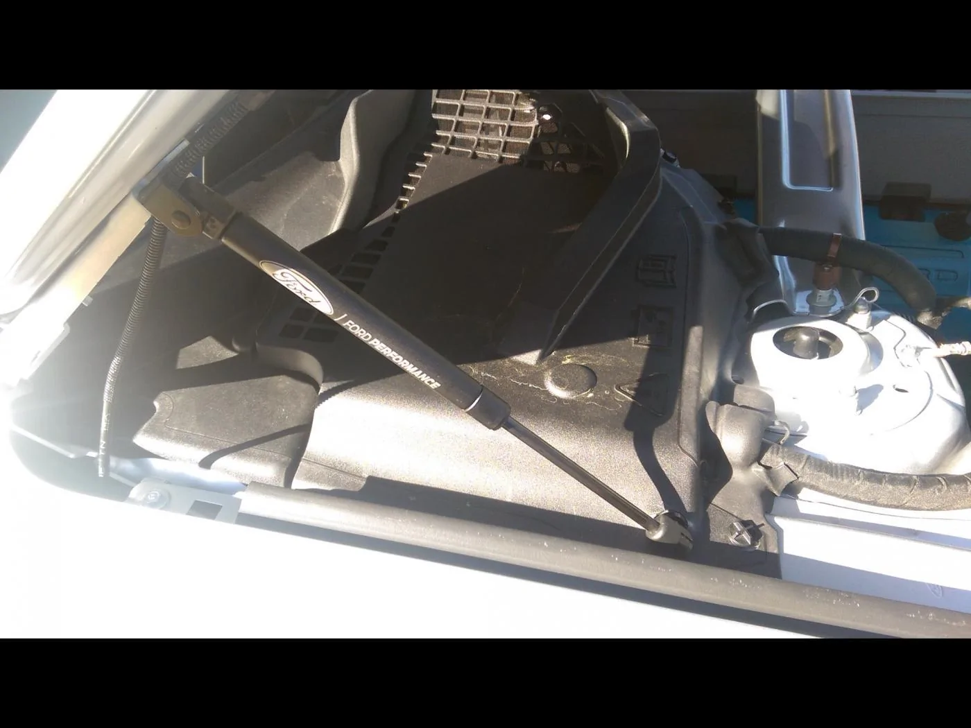

Todd, did the struts raise the hood at all? when you look along the fender, is the hood higher than the fender, especially near the wheel?
Also, how do you get to the battery with the strut going through the cover?

It will look stock when the hood is closed. I've had a Redline set installed since November, and I have a coworker that went with the MRT set. When the hood is closed, they look stock.
Honestly drilling the hole in the battery cover is no big deal, if you use the recommended bit, it will even look stock. On mine I made a small cut from the hole to the edge of the battery cover so that I could remove it without having to pop off the hood strut.
One thing I will say, however, be extremely careful when servicing your car around the struts. I was trying to get to one of the bolts holding on the passenger side exhaust manifold through the battery compartment, and my shoulder was applying pressure to the strut. It popped off the bracket and the hood was then supported by my back. Thankfully the other strut was there, so it really wasn't that much weight on me, but it did cause me to leave a few brown stains in my boxers.
Also, if you take it to a car show on a windy day and leave the hood up... I'd monitor things closely. The hood bobbles quite a bit and I'm not sure how much stress those things can take with the wind blowing the hood back.
