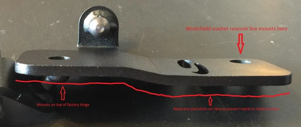

The MRT uses a larger mounting plate but it lays right over the factory hinge on the hood so it wouldn't help anything to do with hood flex. The larger mounting plates referred to earlier are like the Steeda which are also a long tube like the Redline, have a longer mounting plate where it attaches to the hood. It extends towards the front of the car from the factory hinge and provides more support to reduce that flex while the hood is up and you are trying to close it.

Just got home from work and my new Steeda hood struts are here. I very pleasantly surprised when I opened the package. The mounting plate is heavy duty as you can see from the picture. It is 1.5" wide and extends an additional 3.5" past the end of the factory mounting plate. Plus, I couldn't see this detail from the installed pic but notice how after the where the mounting plate goes past the factory plate, it bends down towards the hood. A thin neoprene pad mounts between this mounting plate and the hood to protect the hood. I thought it was just going to be a thick piece or neoprene and the mounting plate was going to be straight. Very nice quality stuff. Going out to install now.
