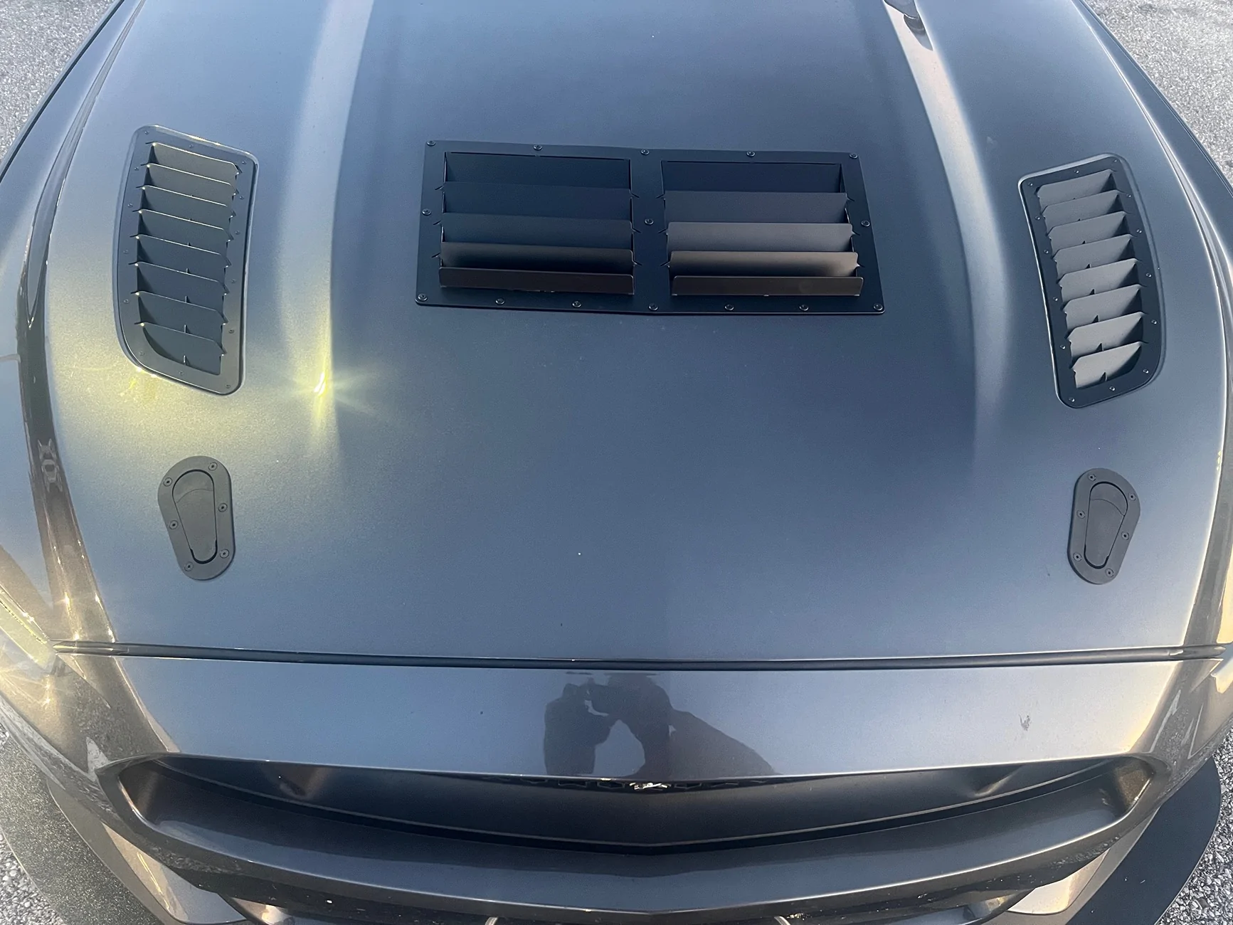

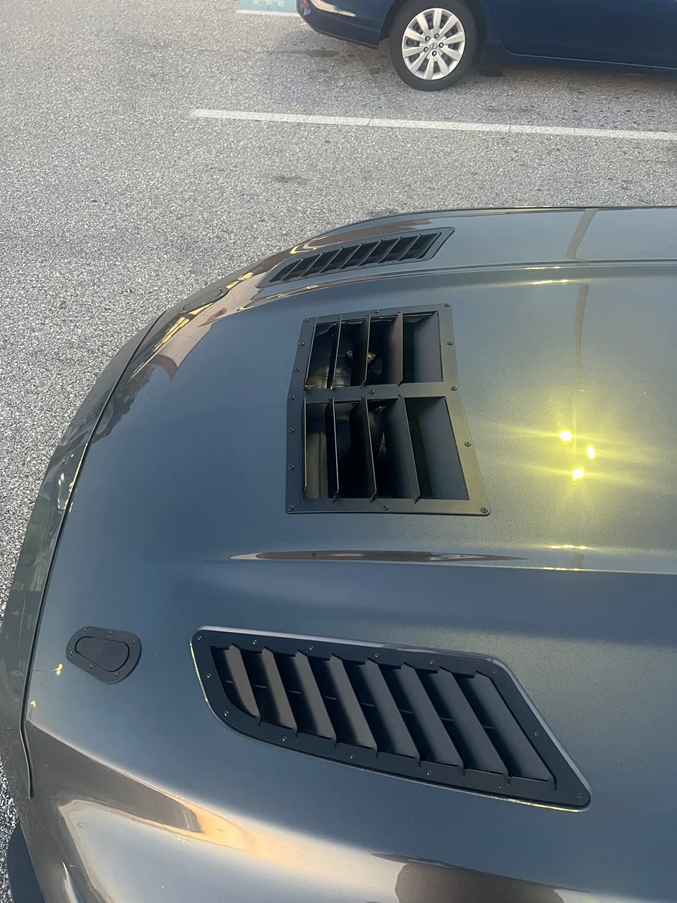

I have aerocatch latches...my hood shimmies no mo
