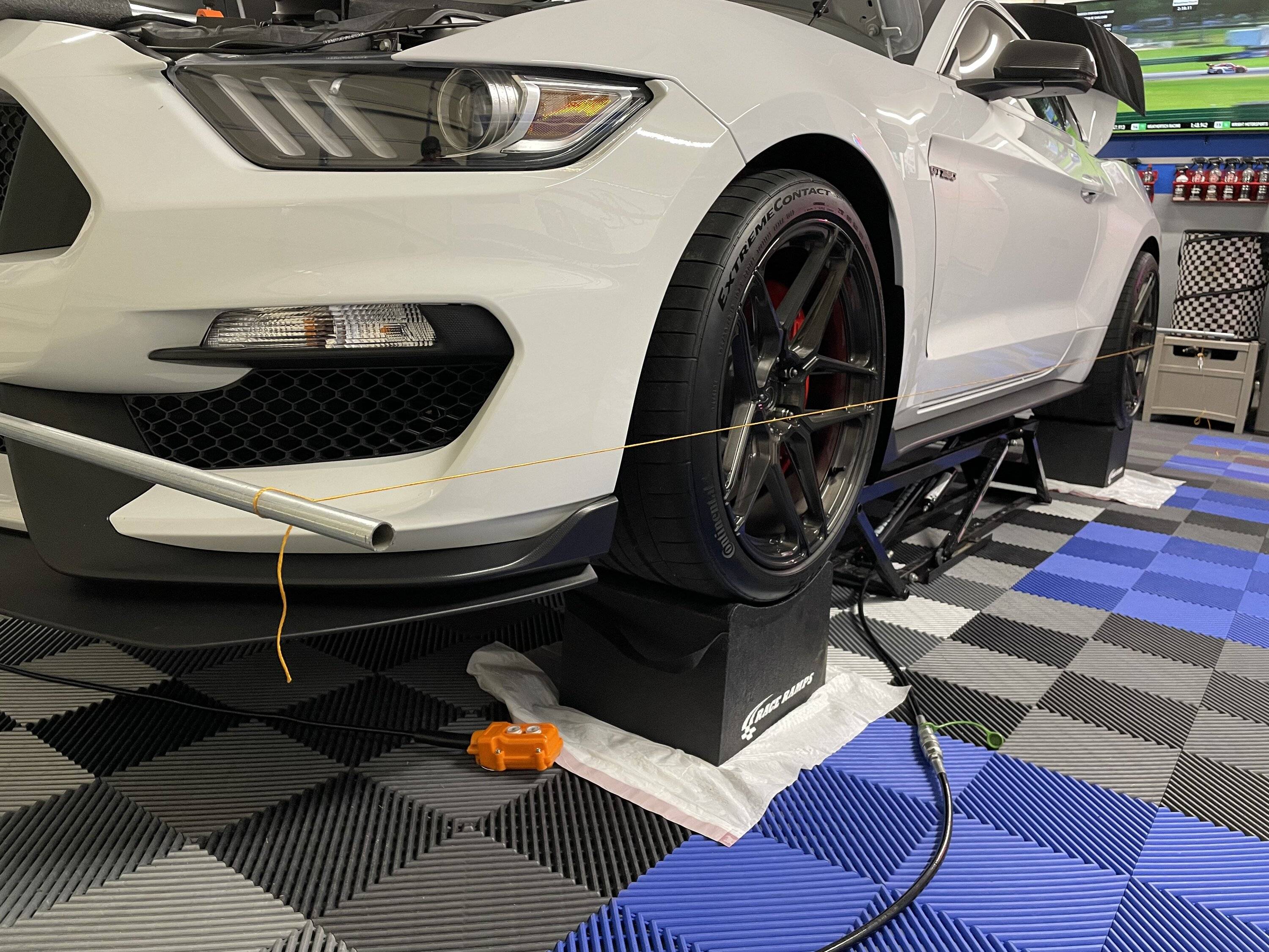

Caliper garage 3d printed string alignment kit, 2x4 cribs, and vinyl floor tiles. I'm able to get great results (better than my local shop) and I actually enjoy the work. Still getting faster each time I do it, takes about 2hrs for camber and toe front and back.

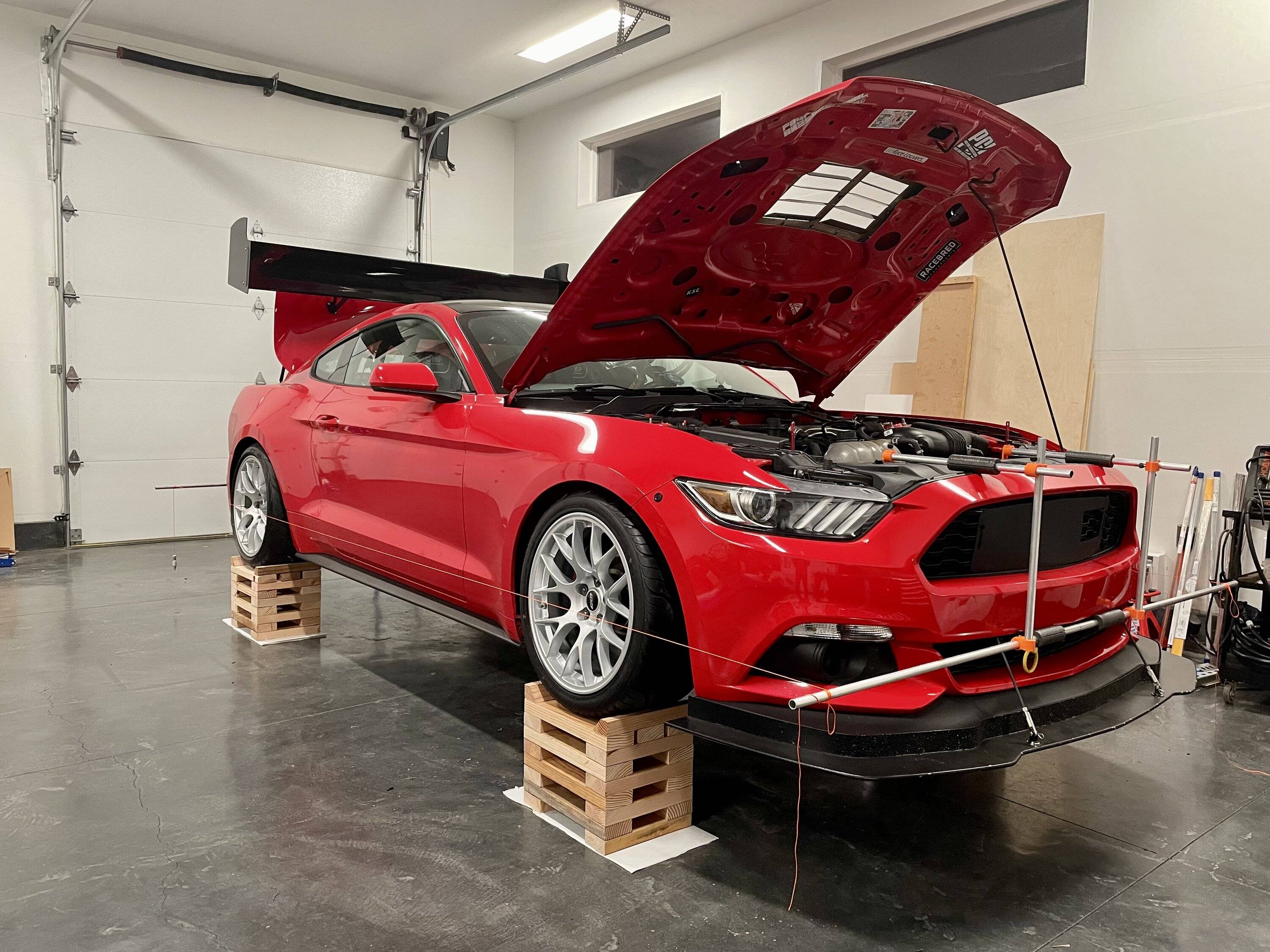

Use math, some string, and the car only goes off the ground once.

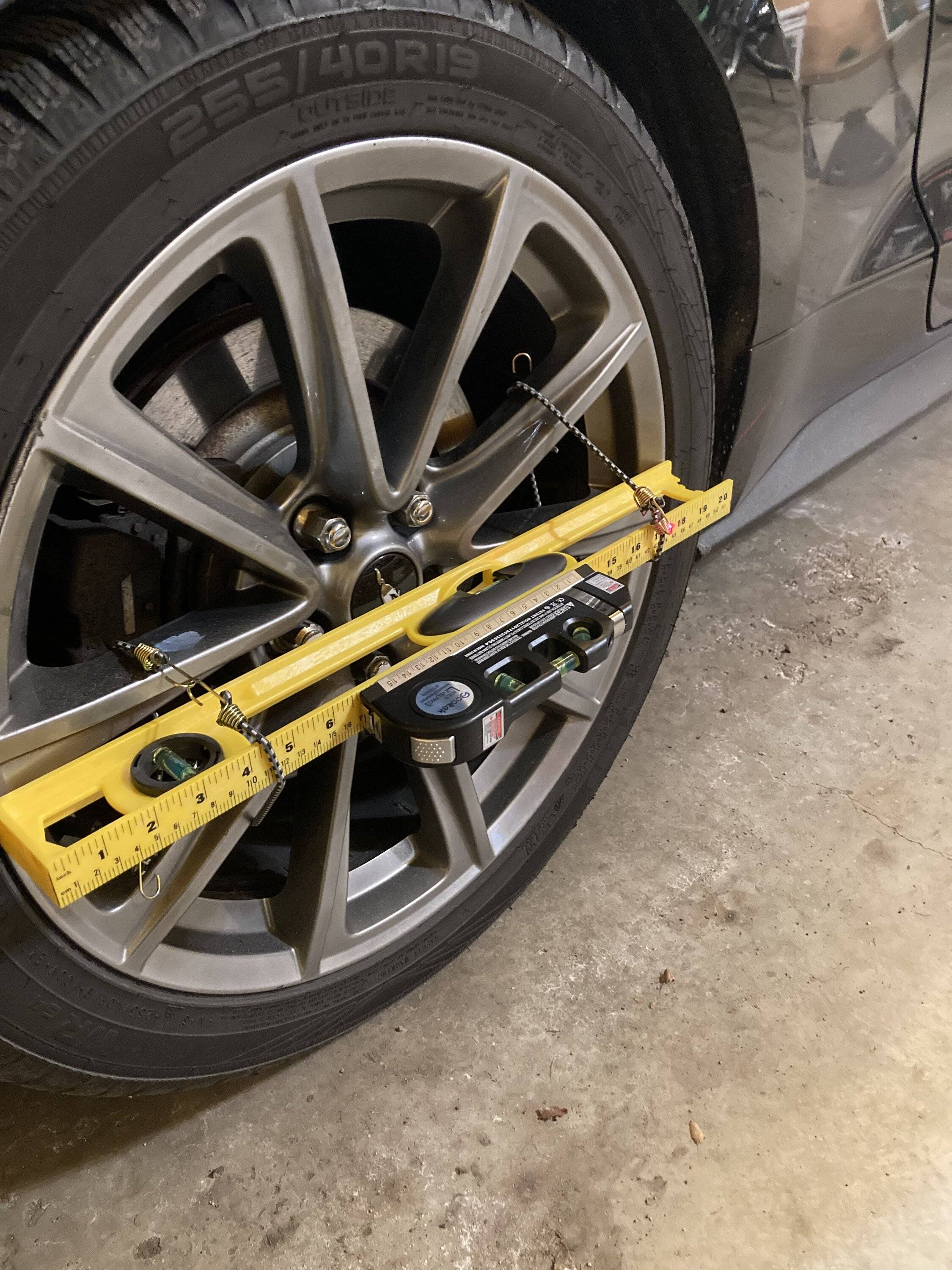

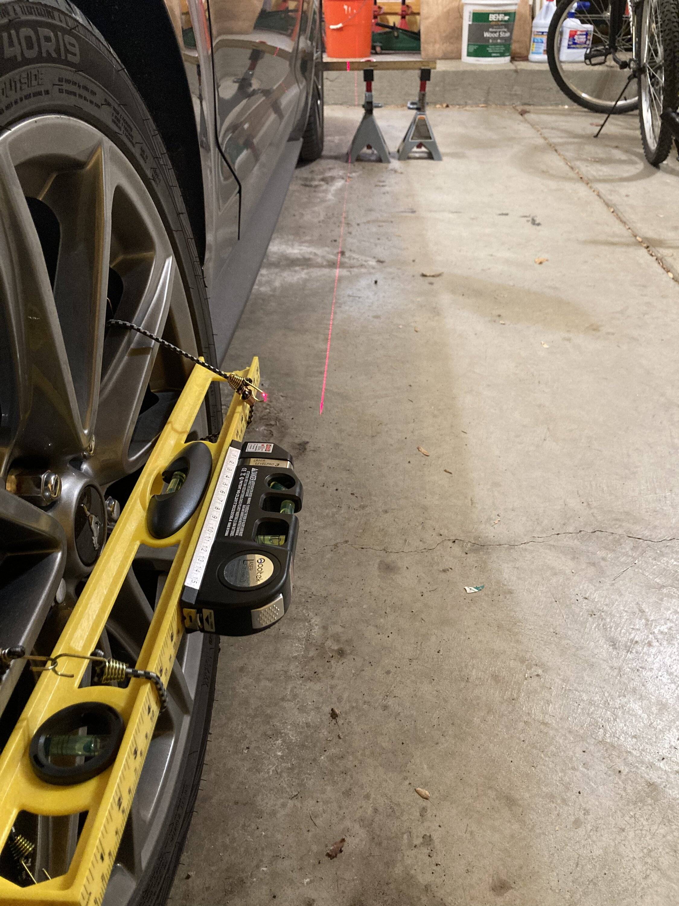

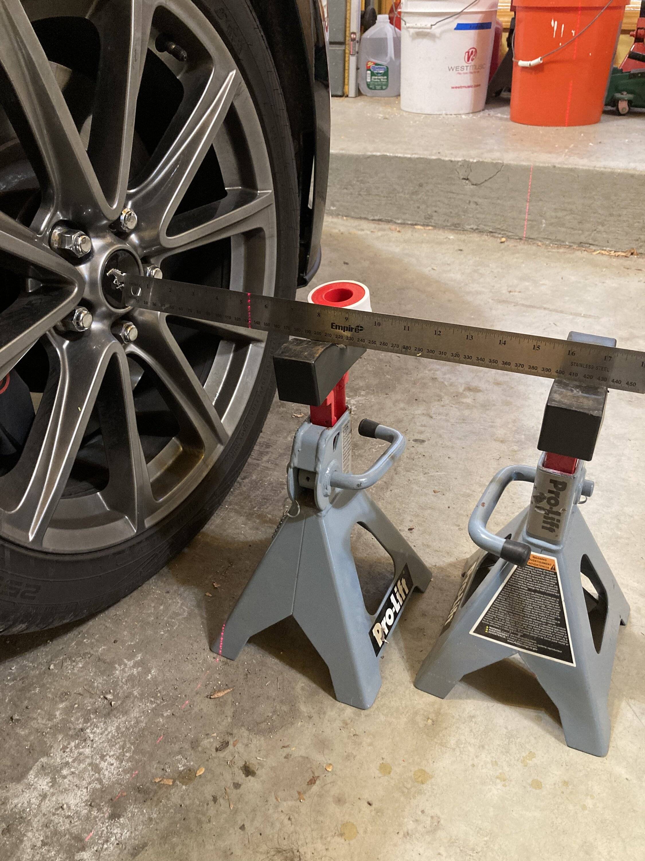

i figured out a stringless method to do make sure thrust angle is zero:
a) cut a 24 in level to the exact width of your wheel at centerpoint
b) glue a laser level to it
c) bungee cord it to the wheel
d) set up a ruler at hub height
e) turn on laser
measure where the laser scribes the ruler. if it is the same on both sides, thrust angle is zero. see pics.
