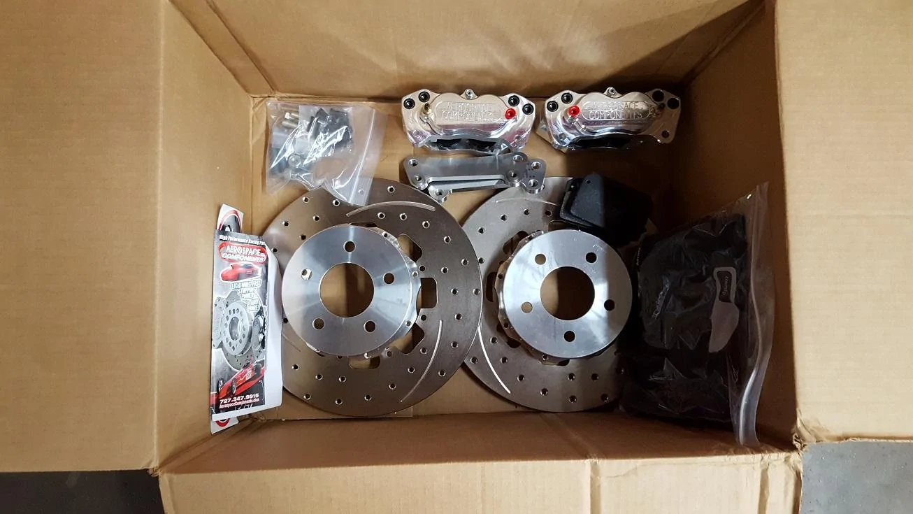

I have to ask since this plan is kinda boggling my mind.
What was the purpose of getting the performance pack if 1) you're more interested in drag racing and 2) you're taking off all the PP parts anyway and replacing them with lightweight stuff or not at all
Wouldn't it have been easier and cheaper to just buy a base GT with the base brakes and no bracing?
But that's just me. I wouldn't spend all that money on fancy Brembo brakes and bracing to then remove them.
Decision to focus on drag racing came after the purchase.
When I bought the car I wanted many of the advantages of the PP. The bigger radiator, 373 gearing (planning on staying NA), spoiler delete with no holes left in the trunk, wheels (at the time), gauges, and bigger brakes (at the time). Yes the bracing, springs, and sway bars are different as well. I thought I may try some autocross or something and figured I may like the handling improvements. Then as time went by I realized that any kind of track racing can get a lot more expensive then the occasional run down the drag strip. I am a drag racer at heart
