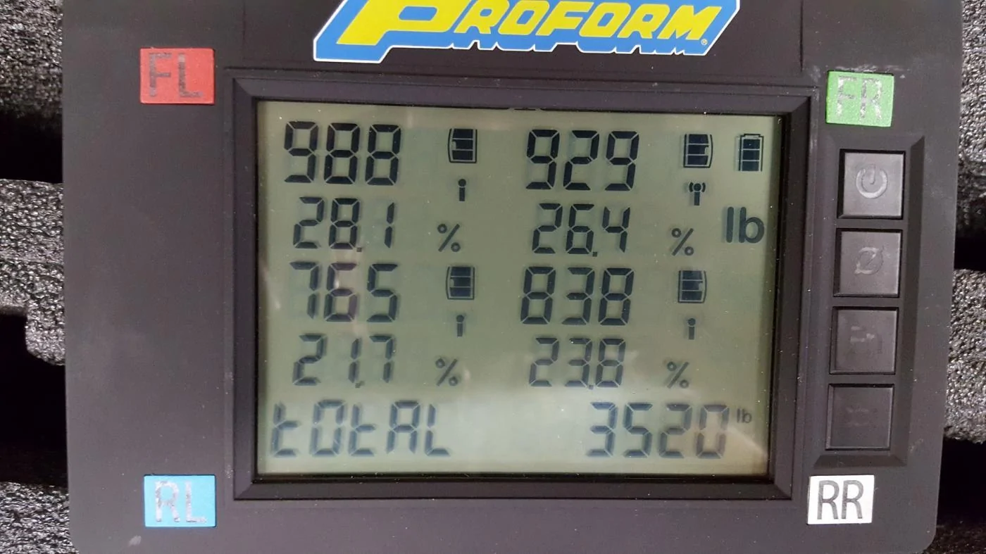

Not bad for a base PP with a 1/4 tank of e85.
Still have a back seat. (I have kids)
Full bolt ons, deka etx18l battery, no k brace or strut brace. M600 wheels. Aluminum DSS. Exedy clutch and LWFW. Grill delete, engine cover and coil covers deleted, air pump deleted, BMR cradle lock out and bf shifter bracket added a little.
I have Aerospace front street brakes ordered. Should shed another 55lbs.
