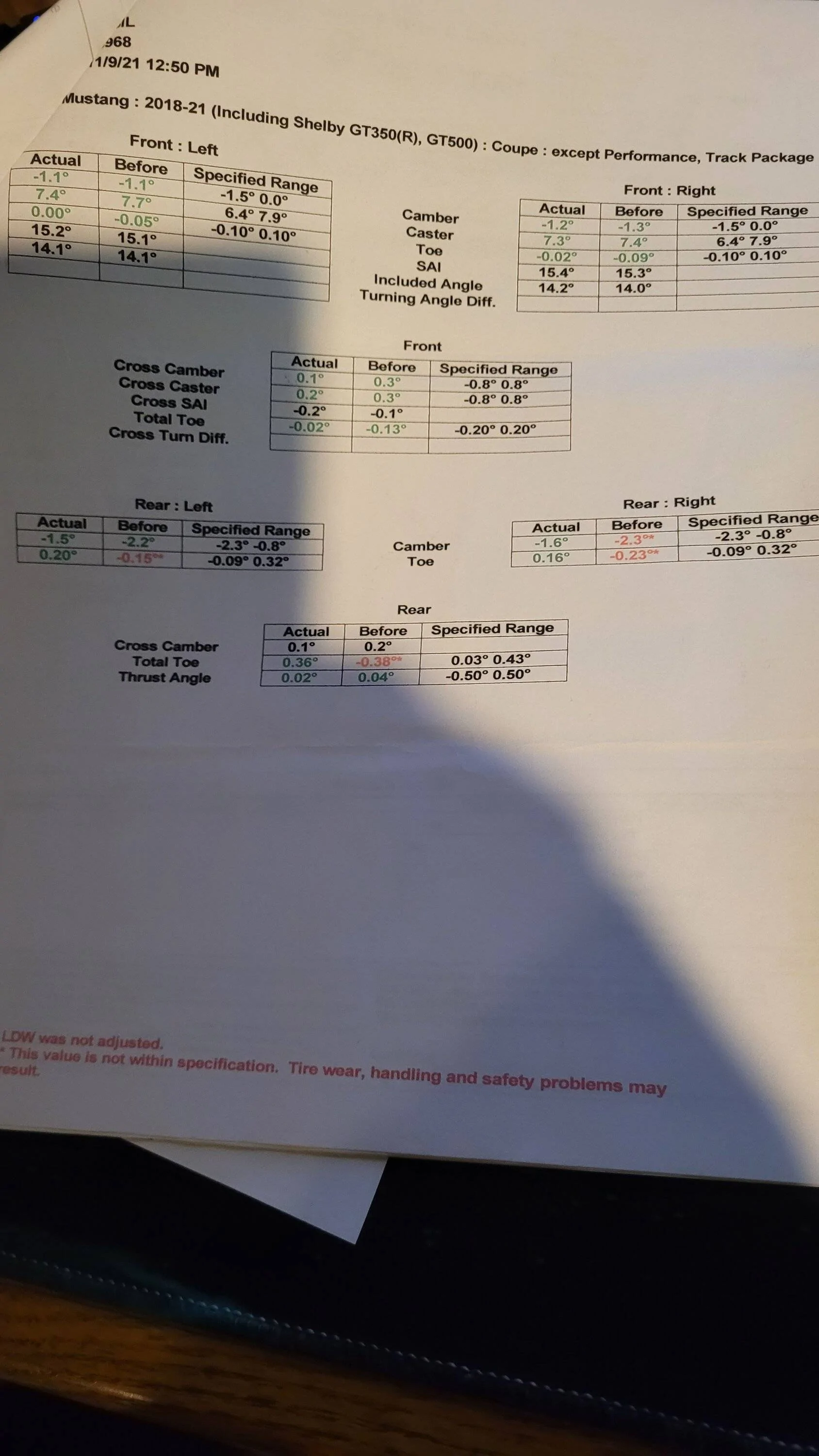

It's not camber that wears your tires that way, it's excess toe...
Can you share the alignment sheet?

This was done a couple years ago. At the time, the toe seemed just fine. Unless it got knocked out somehow, and wore the inside tread down really bad.

Toe is your issue. Not camber. The fact that your camber changed in that alignment without camber plates shows that the shop did a half ass job on your alignment IMO.

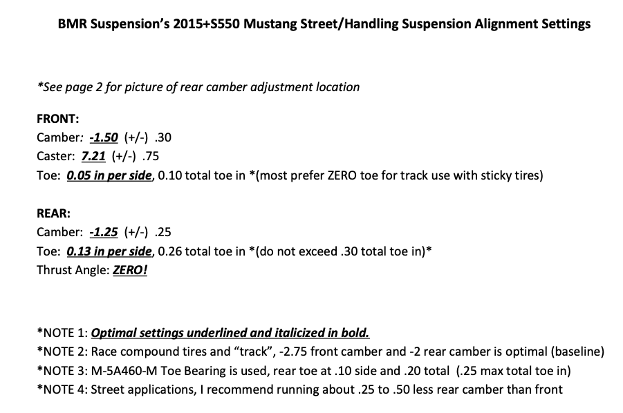

Just to add my 2 cents: Personally I wouldn't run a camber setting any less than -1.5 on the front. It's a big heavy car that needs camber to turn. And the MacPherson strut front suspension has a weak dynamic camber curve anyway. Even if I wasn't pushing the car that hard, there might be a situation where I need to hustle it around a corner. The rear is less of a problem.
I run my camber at -2.5F/-2R on the street, but I like to hustle corners. But I experience minimal negative effects to braking and acceleration. There is some tramlining that many people wouldn't care for, but it doesn't bother me much.

This, this, this! And even -1.5° on the front camber is conservative, even for street. Another key point of this is rear ZERO thrust angle.
I agree these settings are conservative. In my opinion, around -1.8F/-1.5R is a good balanced alignment.
