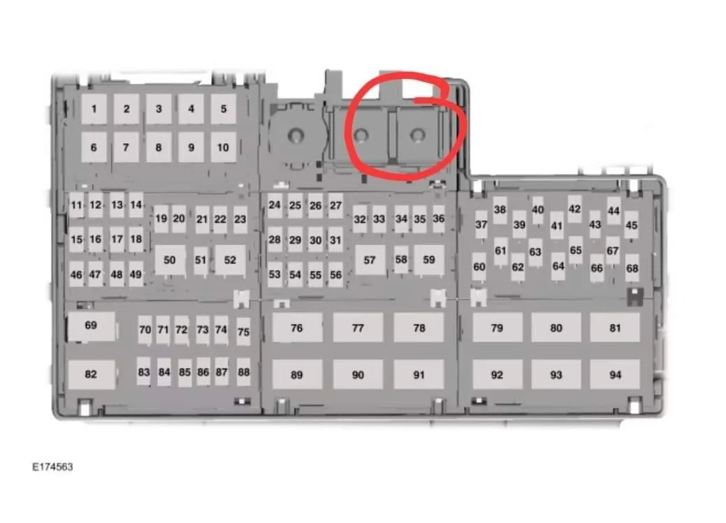

I have a lead in a possible solution... i have the terminals off there's a supposed to be a fuse under them that links them... but i can't figure out how to get the damn thing out to check... anyone know?

Negatives all appear fine. It seems to only have issues if the window are up... do have a possible solution but i can't figure out how to access the fuse to check. .
Someone else had similar problems and this was the issue... i commented with diagram
