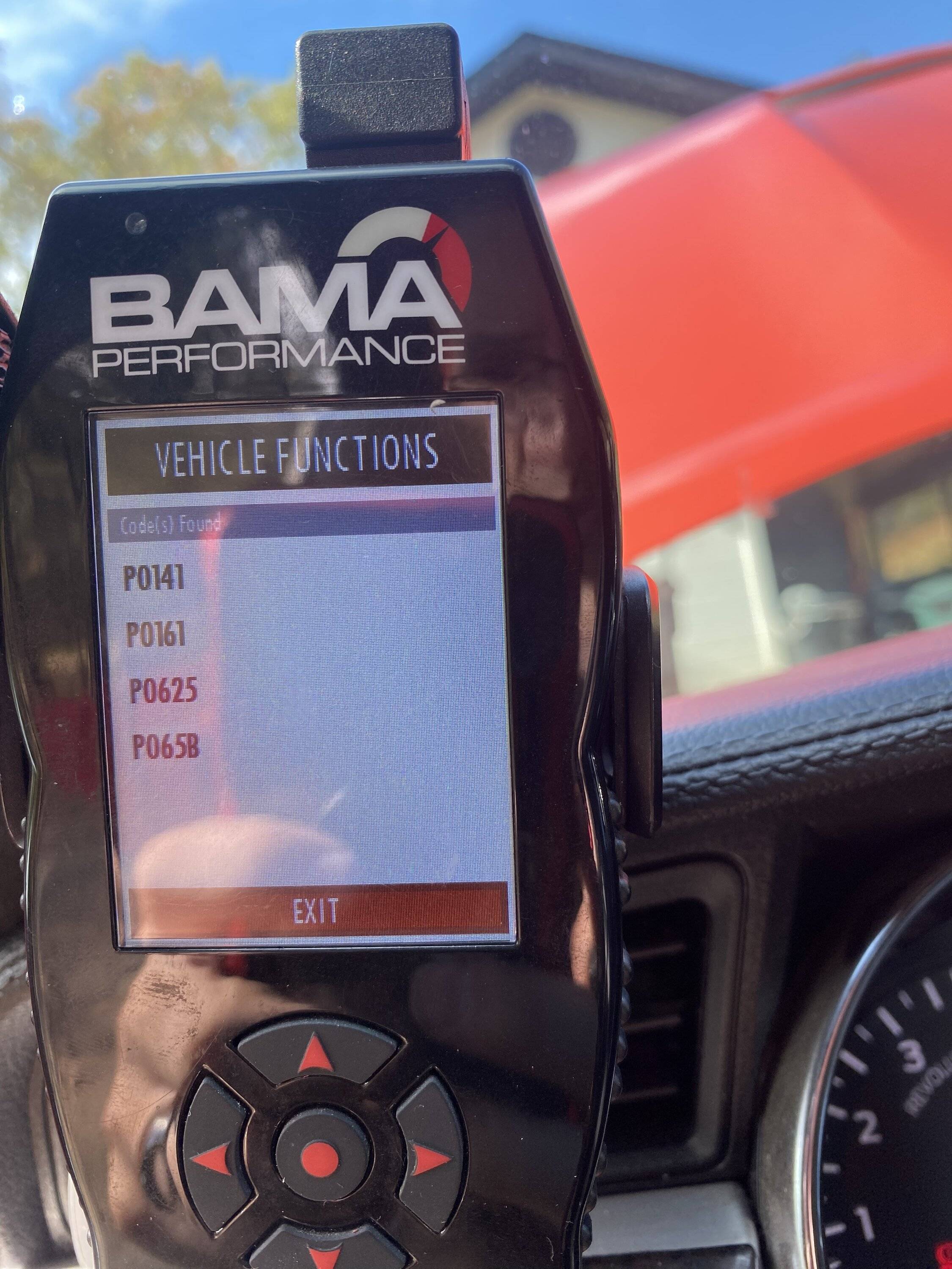

I get a warning on the dash in red saying "Charging System Service Now". Then it told me "turning off low battery functions.”
P0625. Willing to bet its the alternator
It starts fine but still get the warning. It was a steady 11.9v.
Yesterday morning i made it 15min down the road and was suddenly getting 9v. Turned it off and to no surprise it failed to start.
Jumped it and had a consistent 14.1v for the 30min drive to work. Which this having Fords smart charging system, the alternator only gives power when the battery needs it so it shouldn’t need 14v just cruising.
3 hours after I got into work i had to run an errand and it was at 11v again.
Well, now the battery, alternator, and starter tested good as per Oreillys. The battery was at 8% and had to be charged. The past three days it hasn’t been charging at all.
This morning the multimeter got 12.4v from the battery terminals. When starting, it dropped to 10v, 11v and stayed there. With the blower on full blast, brights on, and radio going, i was at 11v.
