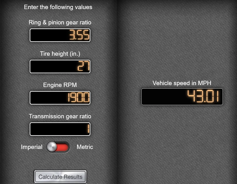

I tested my 2020 today. Lugged it alot, esp in 4th, no noise at all. 22k miles and I did do BG fluid myself, so I know it s filled properly. FYI.
Thanks for the info, curious if you have a short throw shifter? While I can see my particular noise being low speed gear rollover noise I'm not lugging at 1900 in 4th. Ford want's me in 5th already for best fuel economy 😂. I did order Motul DCTF as it meets Ford's spec but It will be a few weeks before I have a chance to change it.

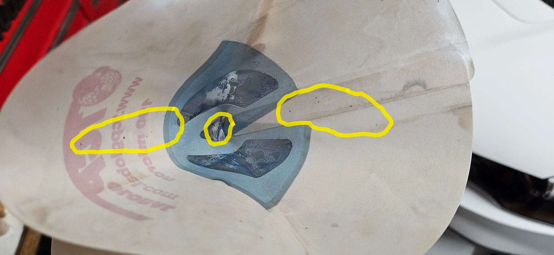

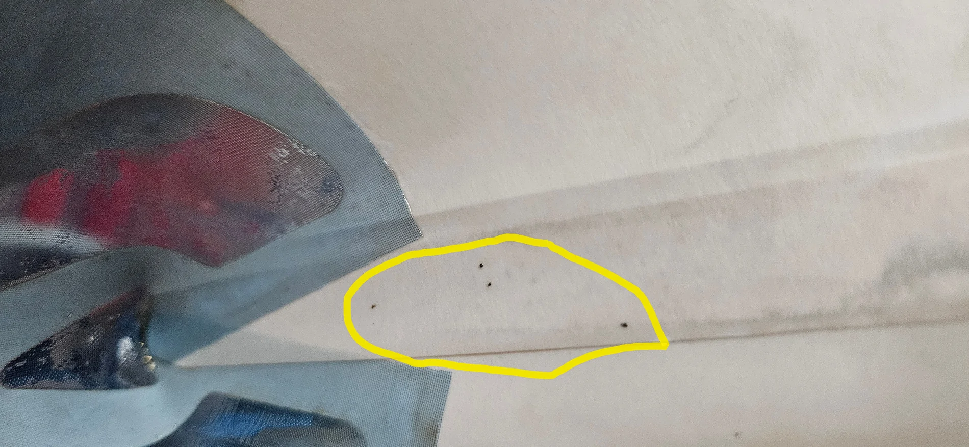

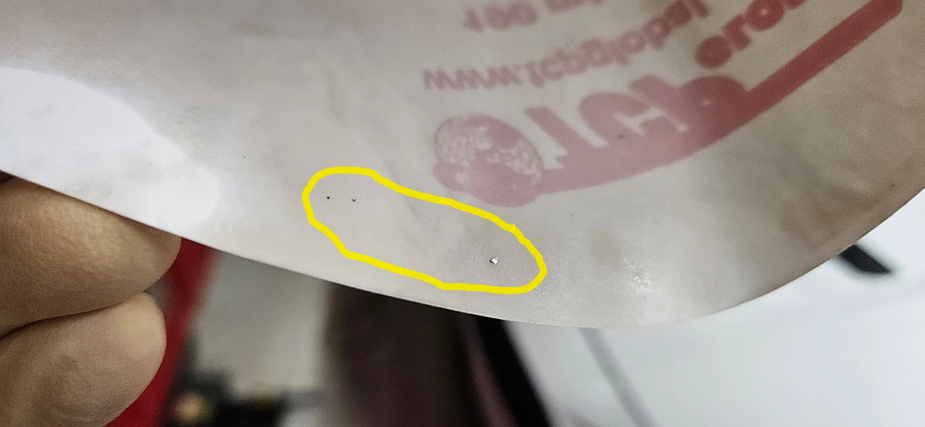

Figured I'd post an update for anyone else with a similar noise.
Finally got a chance to change the trans fluid today
and found metal contamination after draining it through a paint strainer. Refilled with Motul DCTF and noise still persists but didn't seem as loud. However as the weather has cooled the noise was less pronounced on the factory fill so I'll have to wait till warmer weather next year to see if it really made a difference in noise. Didn't drive far after the change but felt like it shifted smoother.

As small as those fragments are I would have thought that the internal magnet would have picked them up. Are they steel or aluminum? That will help you know where they come from and maybe identify the issue. If it is part of the case, it could be time to open it up for inspection. I have an issue with mine popping out of second gear when just driving in second and backing off the throttle or down shifting. It is strong and doesn't pop out of gear if I run it threw the gears while under acceleration. Even if I really push it hard. So, I know that my second gear is worn and needs to be replaced. I am going to replace it with a Calimer stage one transmission this winter. Maybe stage two. I have mods done to the car and have around 480 - 500 rwhp. I want to keep my Barton shifter and aluminum drive shaft and Calimer is a direct swap transmission.

Hit a few fragments with a magnet as suggested, didn't try them all as I might need that strainer to help my case for a new trans under warranty in the future. They are a combination of ferrous and non ferrous material. I didn't realize the manual had an internal magnet, my plan was to order the magnetic drain plug from LMR when It comes back in stock and install it in 1k miles while straining the fluid again to get an idea if its just manufacturing/break in debris or a larger ongoing problem. Thought about trying BG for the next fill but will probably stay with Motul as it meets Fords spec and don't want to give them any ammo to deny a warranty claim if they ask for fluid receipts.
