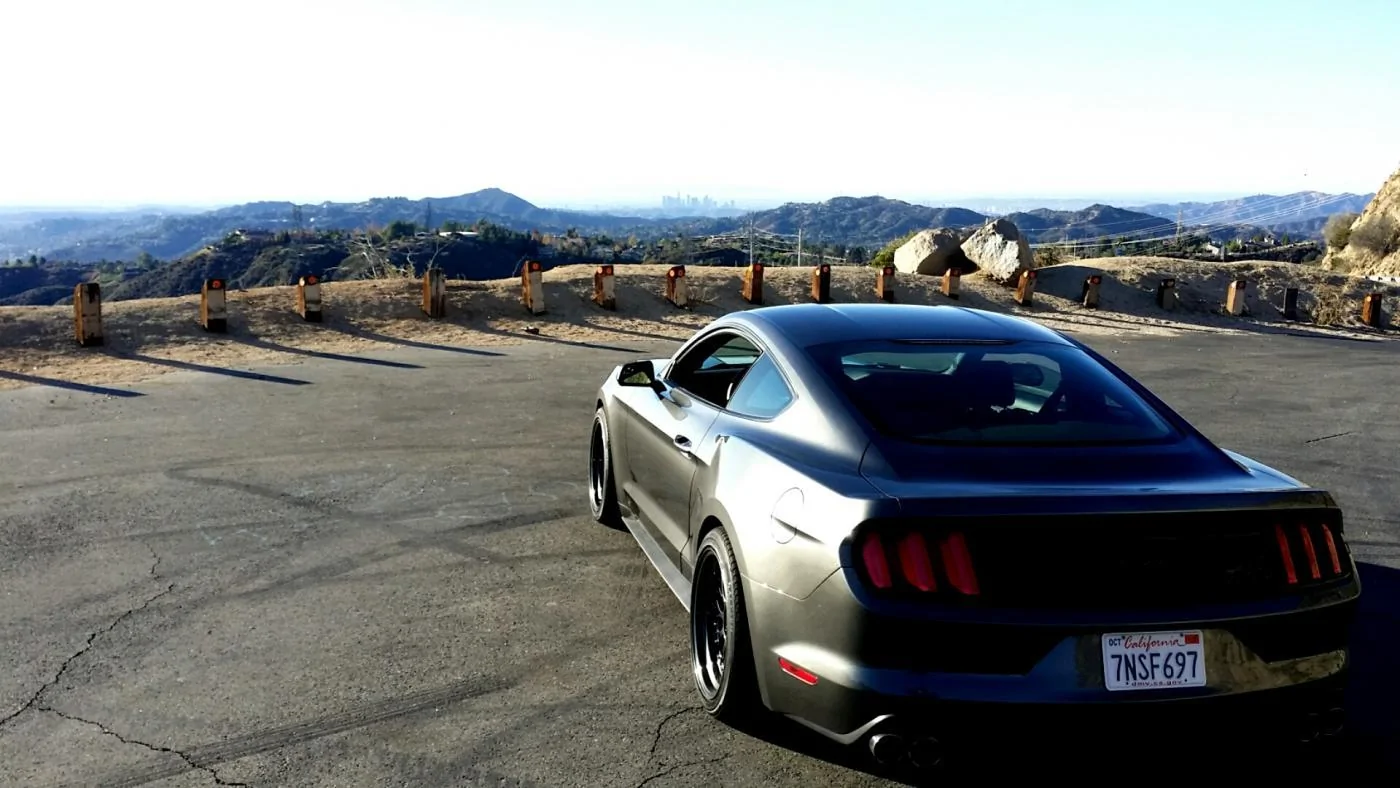

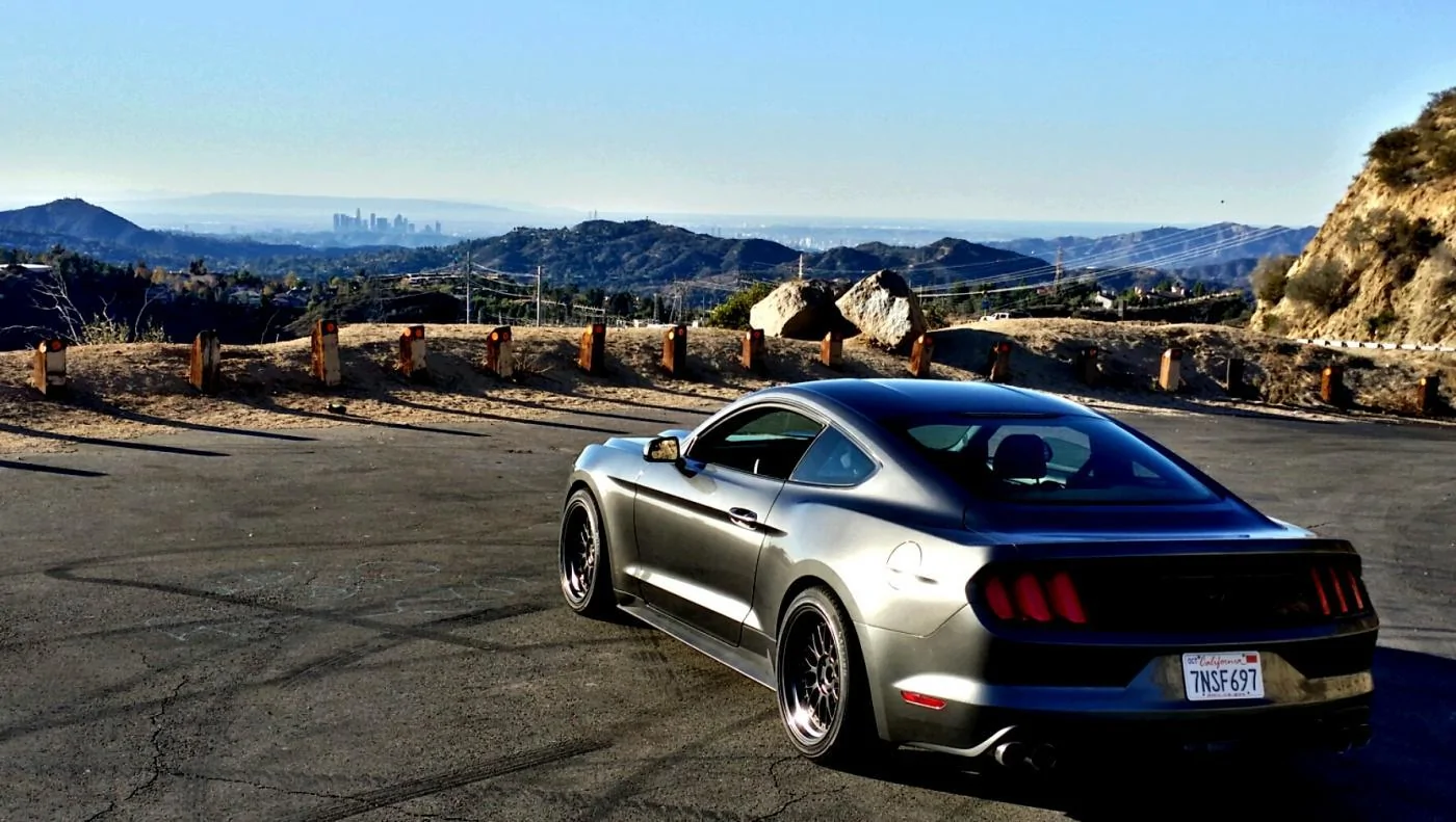

heres what a 10" wide et25 looks like with 285s. theres only about 1/4" poke in the rear and pretty much flush up front. this is on pro kits and camber remained unchanged from stock settings
