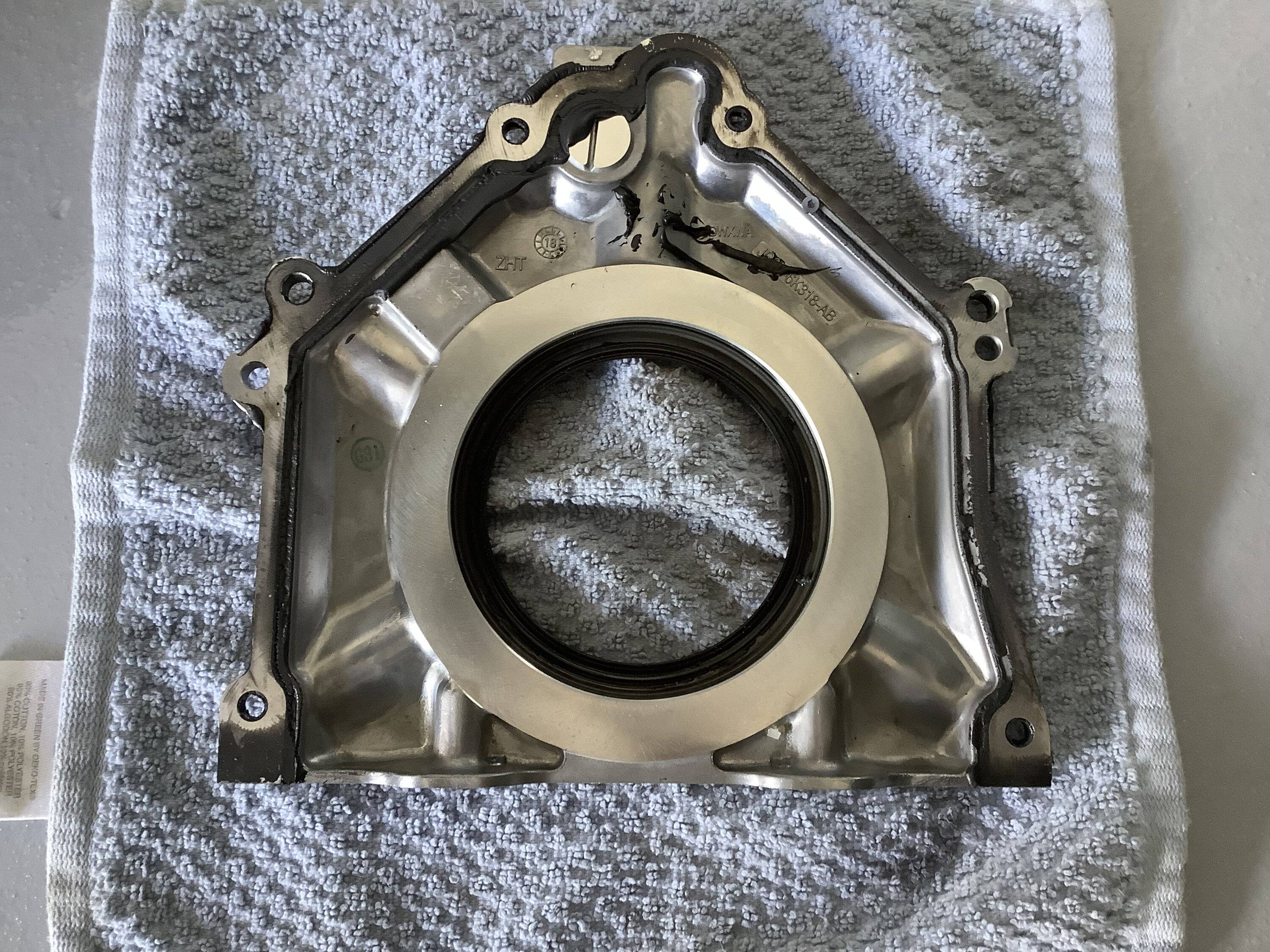

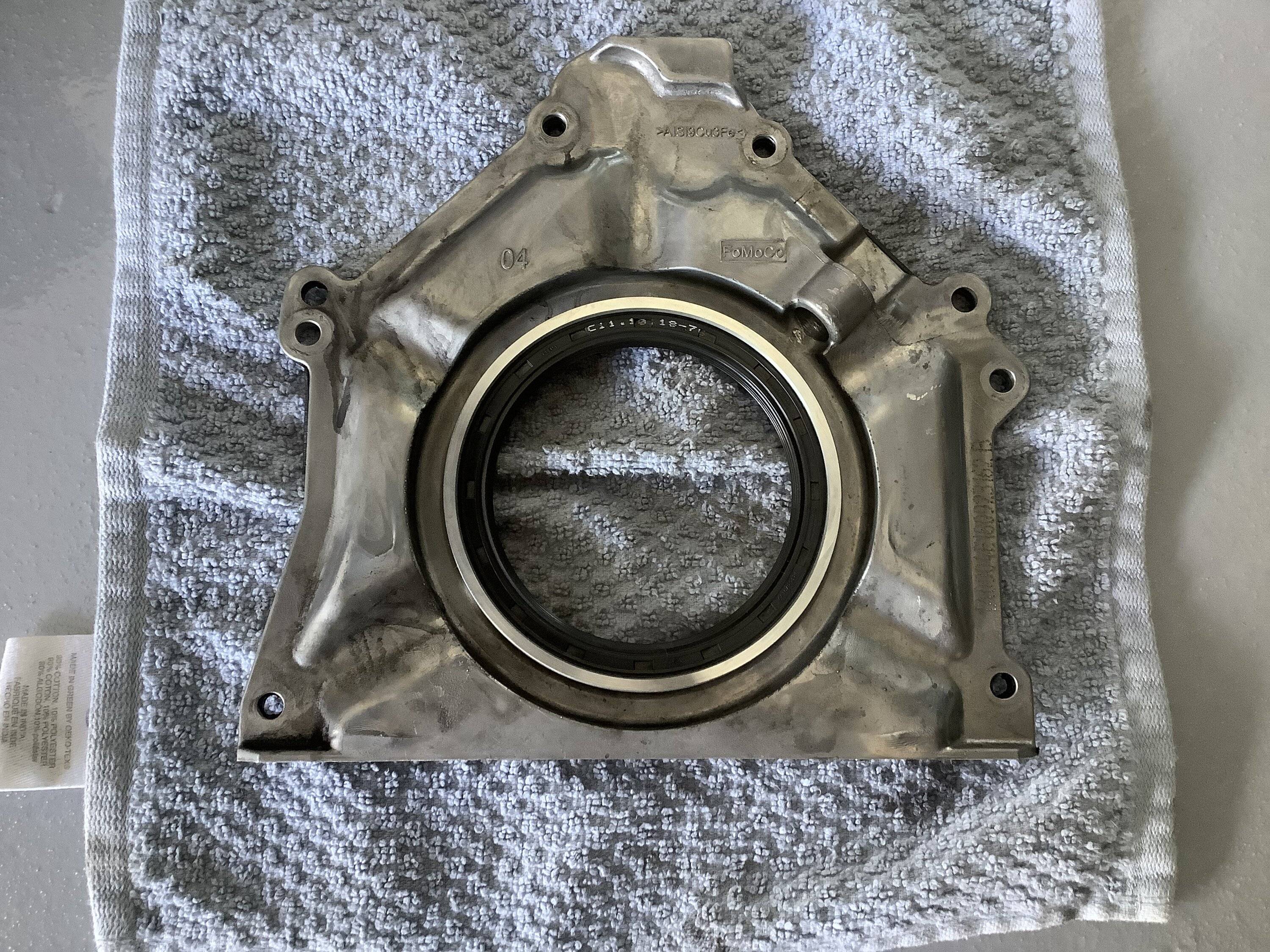

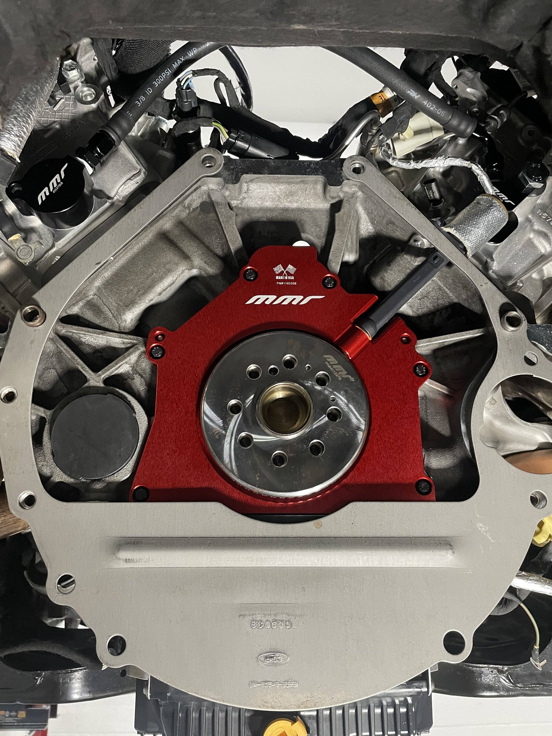

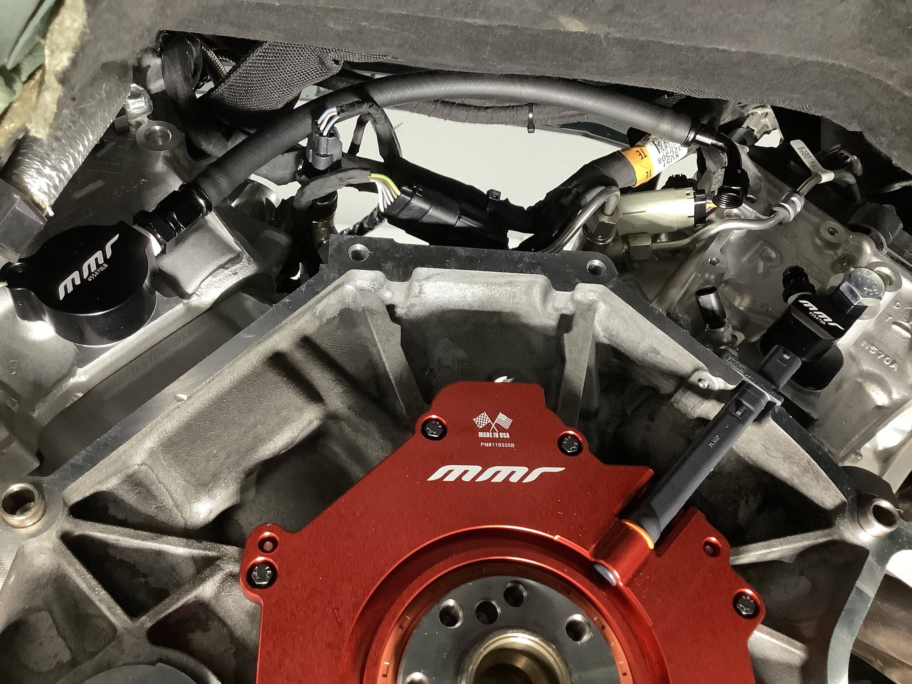

I've been getting my car track ready for what seems like an eternity now. I've finally gotten past the brake upgrades, the handling upgrades, etc. I still have a lot to do, but I'm definitely making progress on the overall car handling - it's getting better and better every time I do something.
So now I think my hydraulic throw-out bearing is starting to make noise. I'm hearing some chirping, and rattling especially when the car is cold on start-up.
There's over 60K miles on the car. It still shifts great w/ no brake fluid leaks though but I can certainly feel there's some age and wear going on based on how deep the petal goes to the floor on shifts, engagement in 1st gear, and of course the noise I'm now hearing.
So...if I'm going to drop the transmission anyway I might as well do some more:
* Put in a Short throw shifter
* hydraulic throw-out bearing
* New clutch and flywheel
* Rear main seal? (Ford)
I replaced my rear main seal on my car when I swapped over to the MMR billet rear plate, gasket , trigger wheel and sensor. You can order just the plate and gasket. I can tell you that the MMR plate and gasket are far better quality than the factory plate and gasket.
