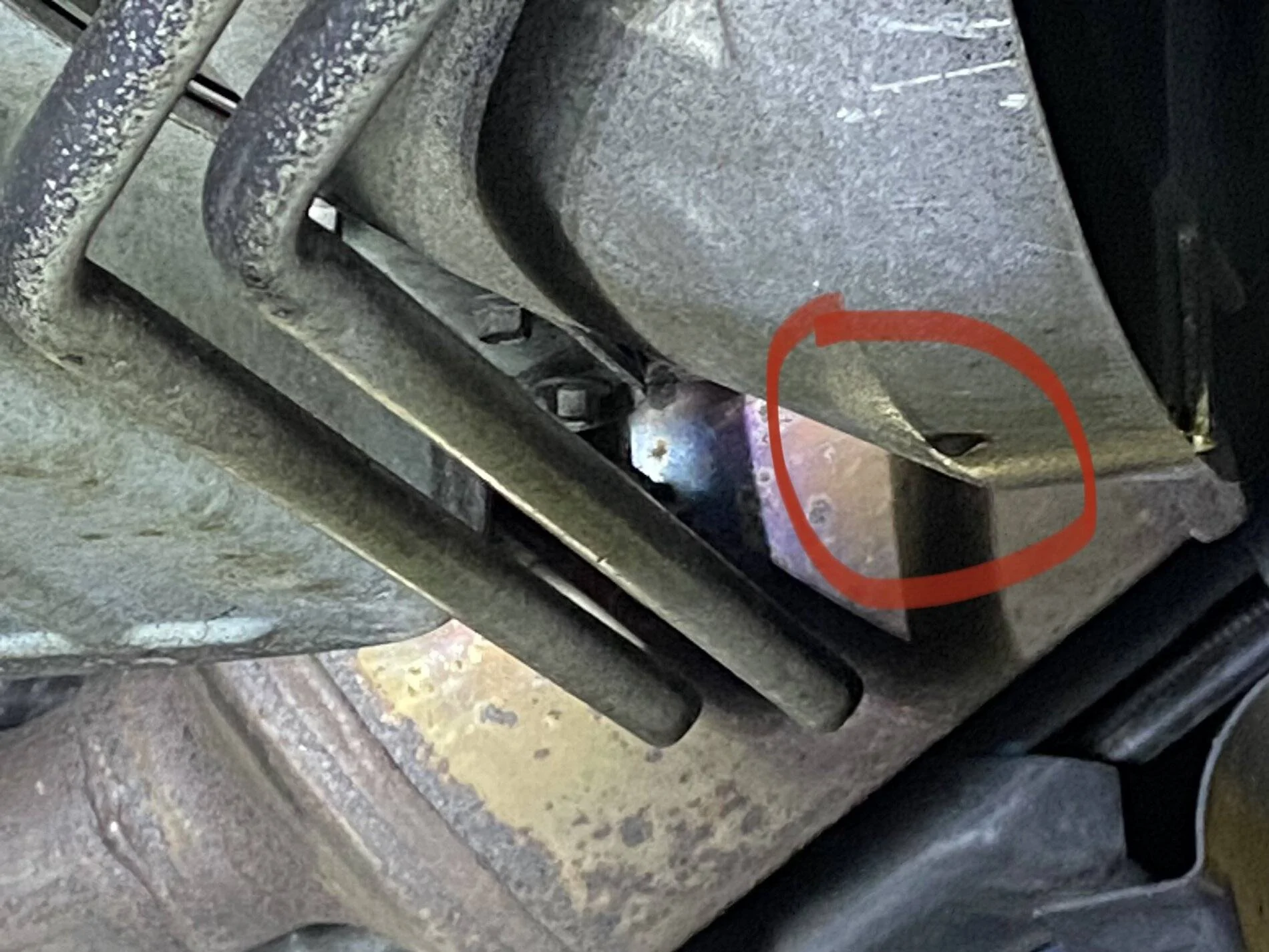

We noticed a leak under the car about a week after we changed the oil last, which was about a week after we installed the UPR Catch Can (that goes into the pcv valve)
We originally thought it was the oil drain plug - we replaced that - not because we thought it was leaking; because the as****** at oil change shops used a damn impact gun to put it on; we stripped it (obviously) and had to buy a new one.
It's a slow drip - over night, it's maybe 8-10 drops pooled. One day, I didn't see any new oil
It looks like the leak is coming from this piece circled on the transmission but it's not transmission fluid (it's brown, not red)
When we were installing the catch can, some of those push clips broke; 1 on the pcv value and 1 near the intake. Everything went back on pretty solid
Could oil be getting by those "loose" push clamps on the hoses?
Could this be caused by the catch can and that's just how it is?
What is the piece I circled?
The car drives perfectly fine; no stalling; no hard shifts (no harder then it is anyway) - oil temp is fine; no dash lights;
any ideas?

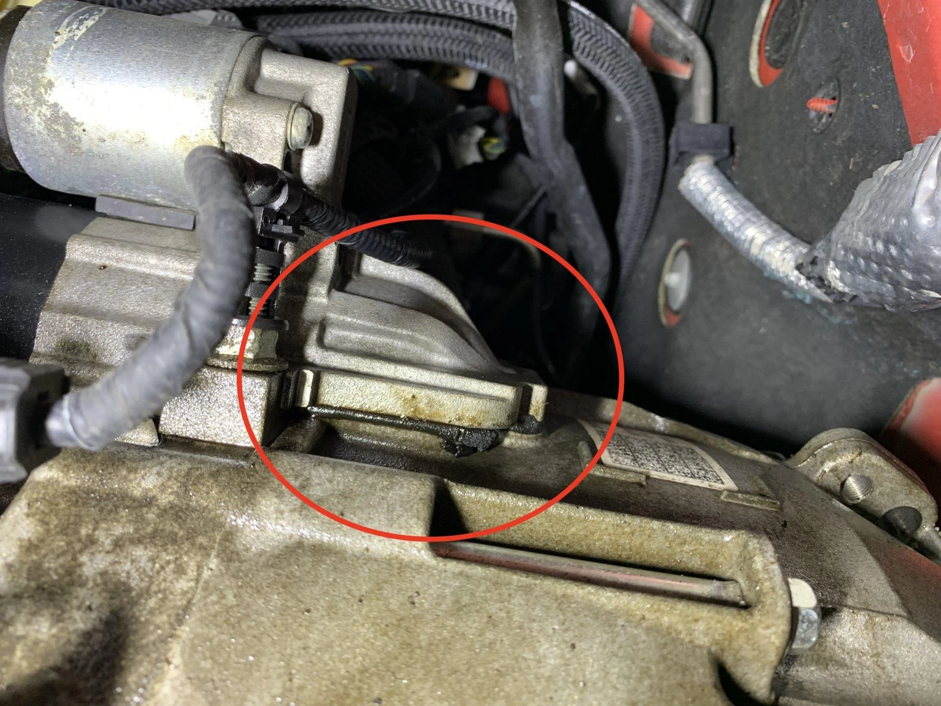

The part you circled is the Bendix (gear) end of your starter.
The foam gasket there is just to keep out dirt, if you have oil leaking there, it means it's pooling inside the bellhousing between the engine and trans and dripping thru the foam gasket
possibly the rear main seal is starting to leak.

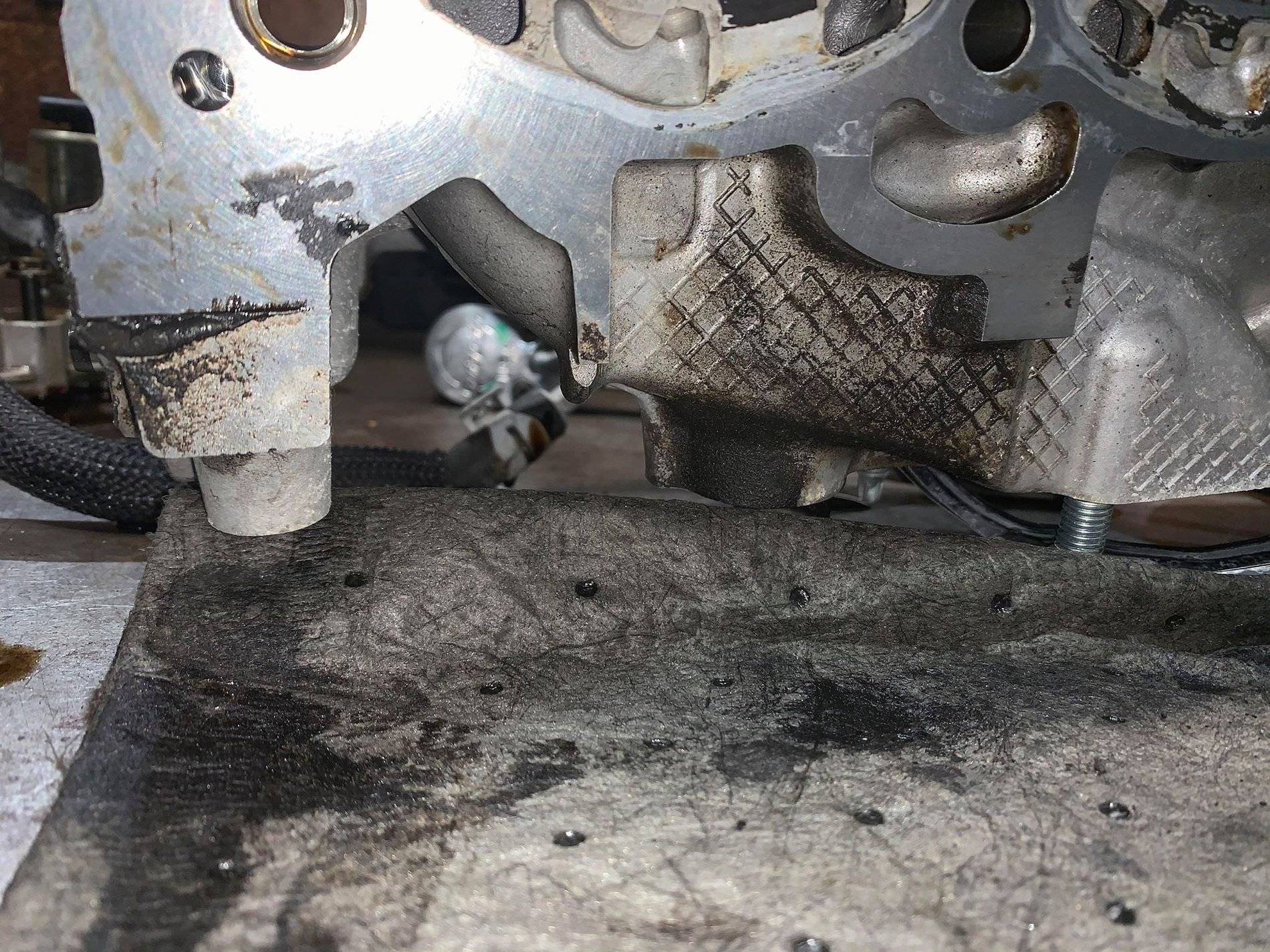

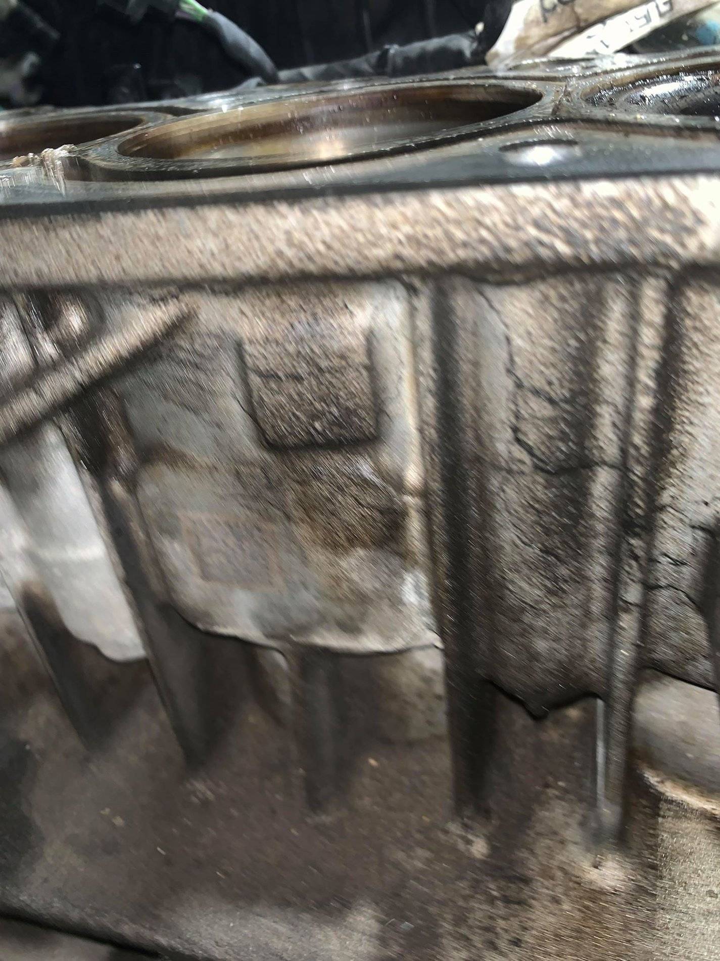

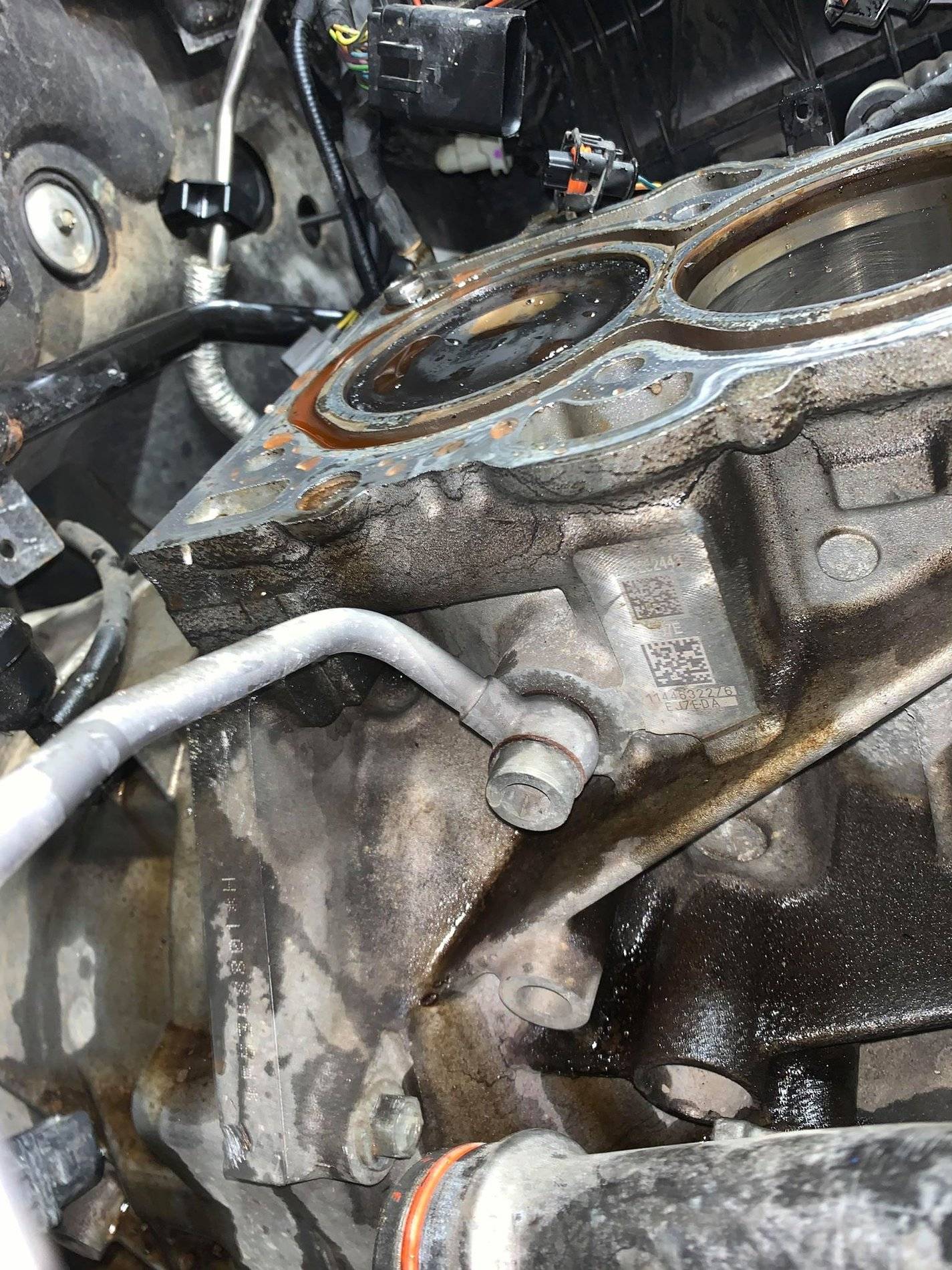

If that is the bell housing your probably should like on the side of the block near the "headafold" and the head gasket for a leak that is dripping down on to it.Known issue for the head gasket to start to fail around the oil passages. Obviously depending on what side the starter is I can't remember. Thats why I was having an oil leak.
