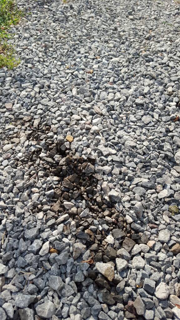

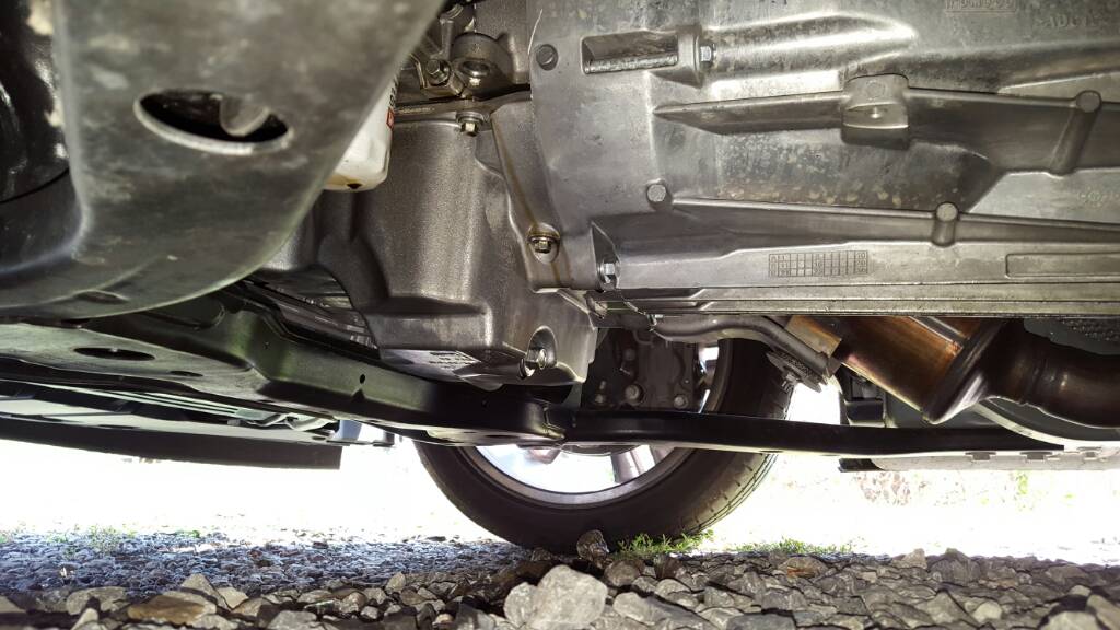

Well just got back from the shop and I can't believe what it was!
It was Ford, the oil pressure sending unit was loose enough for them to turn it by hand! They put some thread sealer on and cranked it down a few turns and no more leaks.
No idea how that would slip by Ford or why after almost 4000 miles it decided to start doing that but at least it's fixed.
Maybe keep an eye out for the same thing guys.
