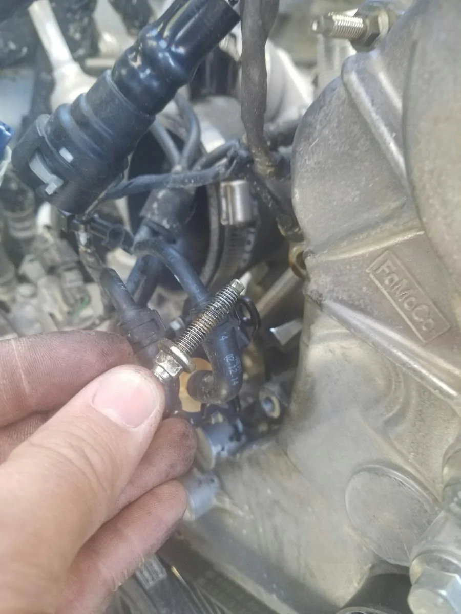

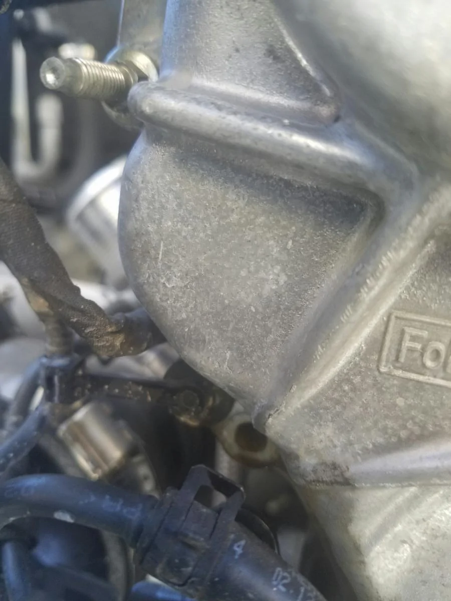

I'm going to take the bolts out myself this weekend ..clean the engine block area ..check the bolts .maybe even some lock tight .
I would not use lock tight,If it was me I would remove bolts one at a time,clean and put Permatex Liquid Teflon on the threads.

Easy fix ..finally got to it ...ther was actually some pressure behind it when is removed the stud bolt ..you will neet a 8mm deep socket ...just clean the treads really good and used so thread sealant. Hopefully does not come back
